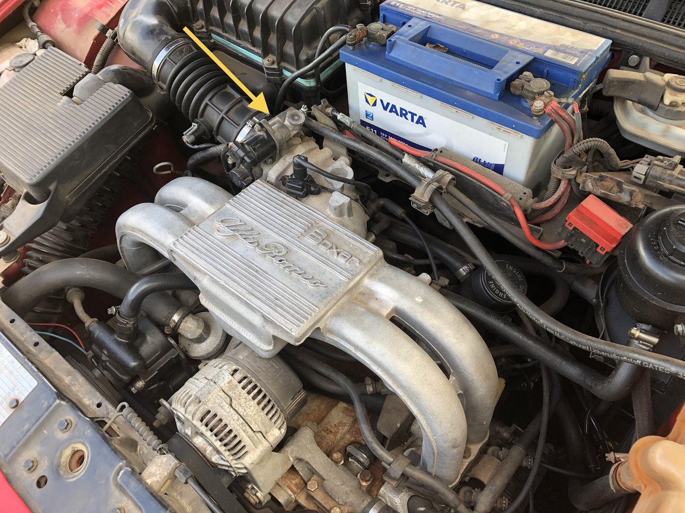

Seen this on a 220gti Rover, throttle switch in conjunction with the vacuum sensor defines idle conditions - iirc the switch was actually on the bulkhead, the vacuum sensor was in the ECU, plastic hose with rubber connector pipe - worth a look?does it have a switch on the tb for idle , some older cars do and they need to know the throttles closed to idle properly
