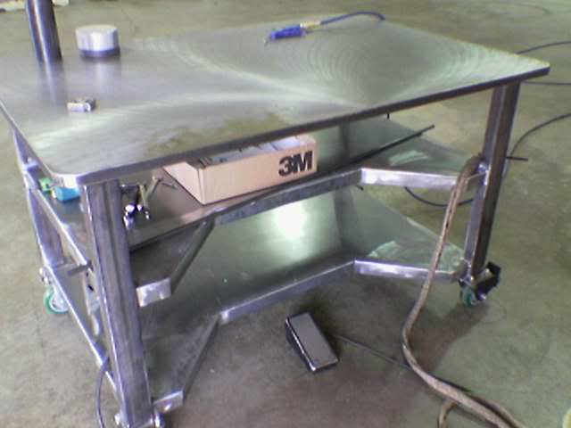

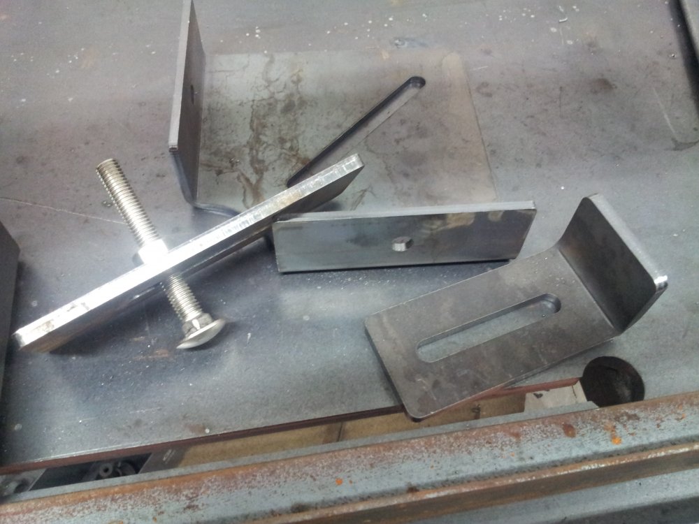

I just thought I'd share some pictures of what I've been up to.... Starting with my 8x4 bench which (I think) has brought gate/railing manufacture into the 21st Century..... Along with a host of other reasons.... The frame is 40x40x3 box section which has been set using my own corner welding clamps.... The top is 10mm thick laser cut mild steel which has been designed to allow me to set up a multitude of clamping plates etc (again, my own design which are selling well on Fleabay :-)..... )
As you can see from the final picture that setting up a 12" railing section is done in minutes.... I'm so happy with it, I'm selling it as I now want a new bench 8x6
My corner clamps made setting the frame soooo easy....
We were only 2mm out on the diagonal
The delivery driver 'chose' to aid getting the 1/4 ton top into my unit obviously I took the health and safety approach by taking the picture....
In place ready for welding to the frame and 3/4" chipboard shelf below...
So easy to set up work now and it's been a god send..... More pictures due with some other creations soon.....
