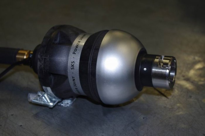

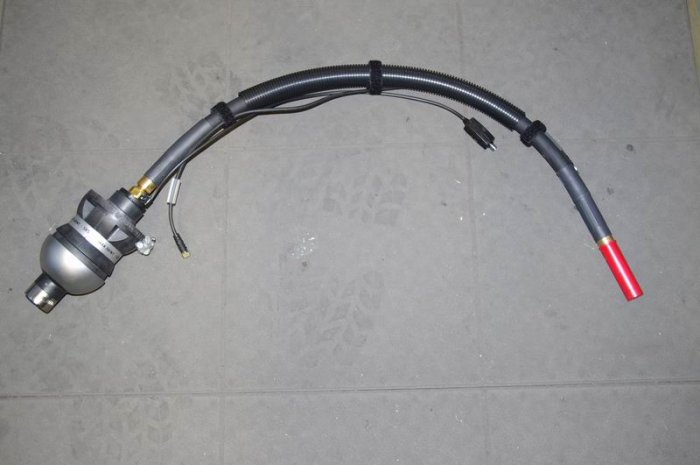

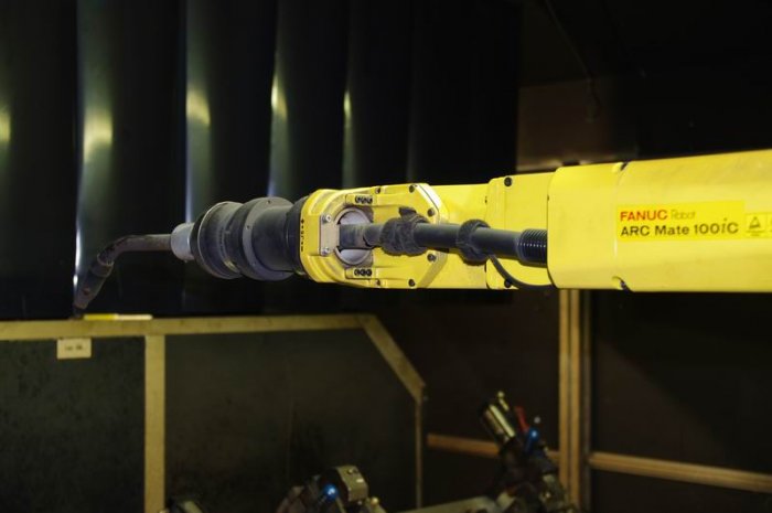

a coupling that allows the torch to be rotated through 360° without dragging a harness behind it, carries the weld current and collision sensor wiring in a neat package.

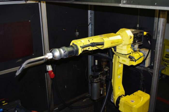

It's max. load is only something like 5Kg but it can wave a part around in the air all day and come back to the same point to within a ludicrous degree of accuracy every time. Shame the Japanese seem to have cornered that market.

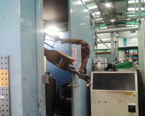

Well i locked one of my mates in the robotic welding cell to show you peeps our latest new ABB toy...(with Esab welder) Just to revive Robotstar's thread...oh and don't mind the joking and chattering in the vid....i wasn't swearing at all....
