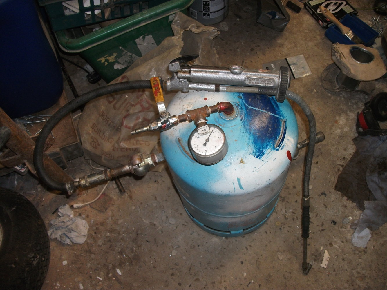

Not going to advise yes or no but i have a 19KG propane bottle that i converted into a receiver on wheels complete with a gauge tapped into it for easy inflating my van tires and i have it at 120-130 PSICan I use an industrial 100 ltr propane tank as an 8 bar compressed air receiver?

its function only and not going rusty so thats itExcuse me Mr spark. I'm very disappointed this isn't painted in your obnoxious blue hammerite.

because i blew one up to see what pressure it would go to after a few folk were banging on about using gas bottles and oldish tanks blowing up
