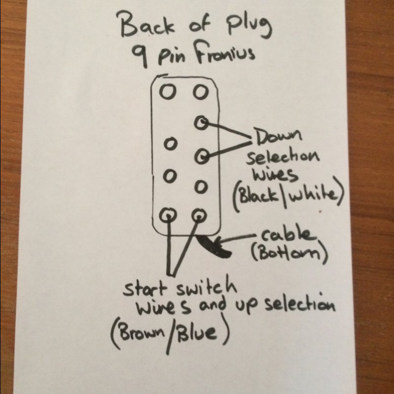

The torch on the mw 2000 needs to be a double switch for up/down perameter selection.
The 2200 might be the same I'm not sure. On my magicwave you go into the hidden menus and adjust the settings with the up/down torch switch. If (like me) you want to pick another torch for the job and you need the up/down facilities you need to wire in 4 wires into the 9 pin plug to make it work. It's a doddle to do when you know which ones go where. I'll put up a sketch of mine.
That's great will keep hold of that Richard , the guy at Fronius said it was seventy quid for the universal socket think that was fitted , the torch has two switches for up/ down on amps will use the torch for any Ali work , but want something a bit more flexible for the stainless pipe work , there equivalent to the wp 17 was two hundred quid .
