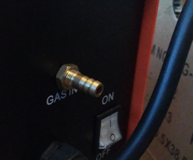

Plenty of realistic options for "real" gas cylinders ( as opposed to the disposable ones ). Search on this Forum for BOC Hobby deal, SGS, Air Liquide Albee, Hobbygas. Argon/CO2 95%/5% is best. Pure CO2 "Pub gas" is a low cost and worse option.I suppose that for the gas the best thing is to go to a local supplier...
You will need a gas pressure regulator and gauges, e.g.:
https://www.ebay.co.uk/itm/Argon-CO...lator-Welding-Weld-Gauges-Welder/352854848354
