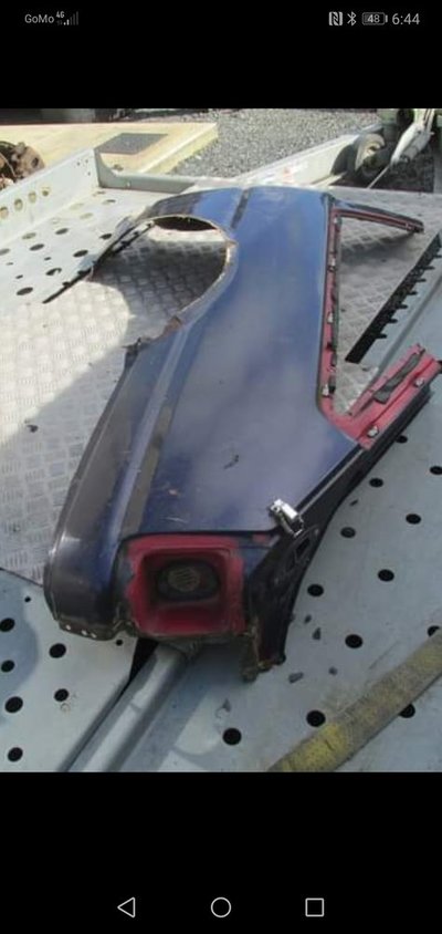

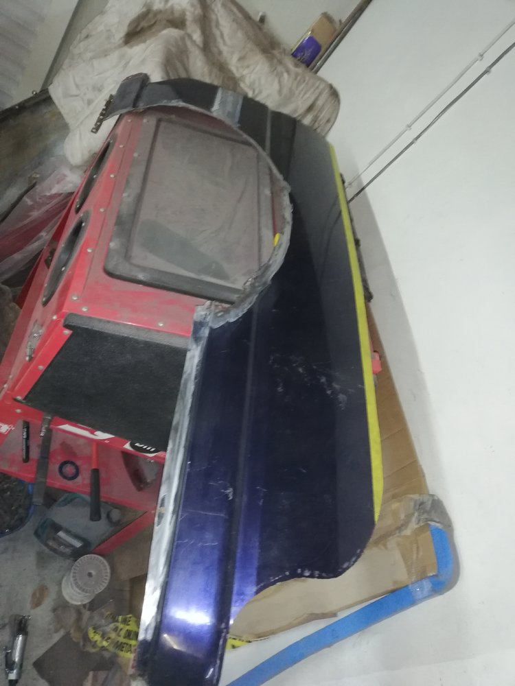

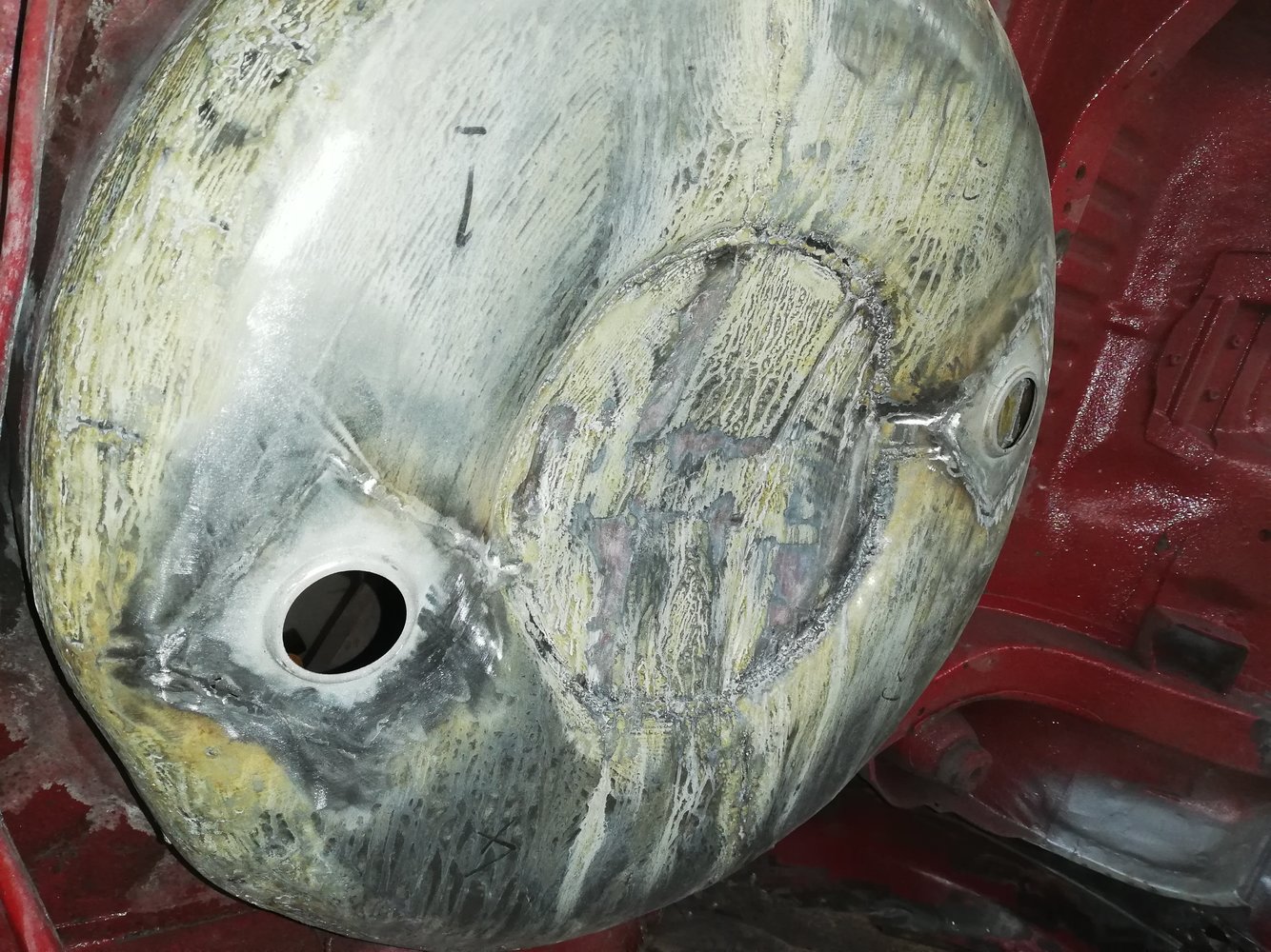

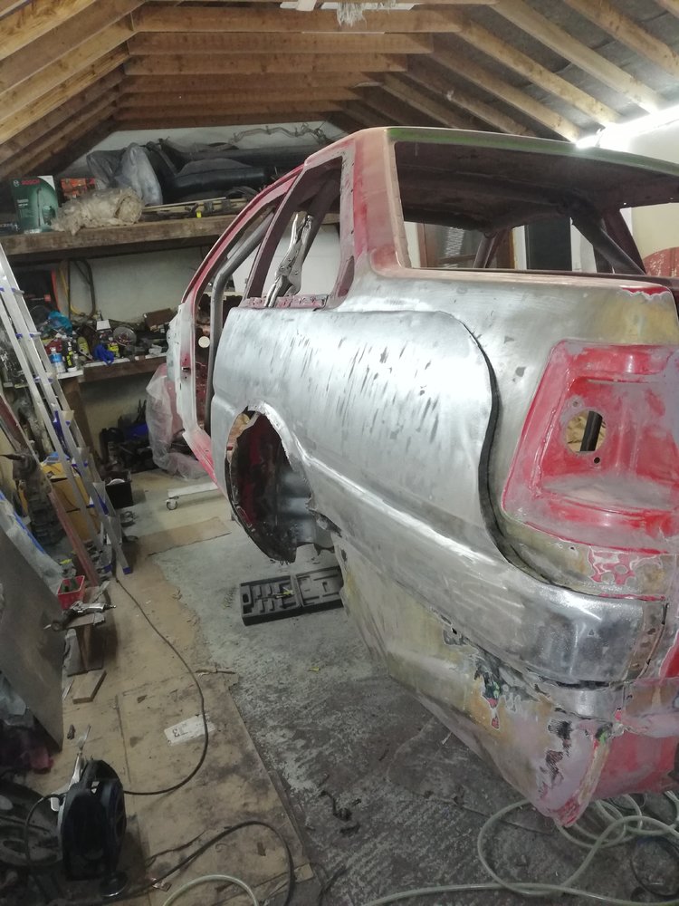

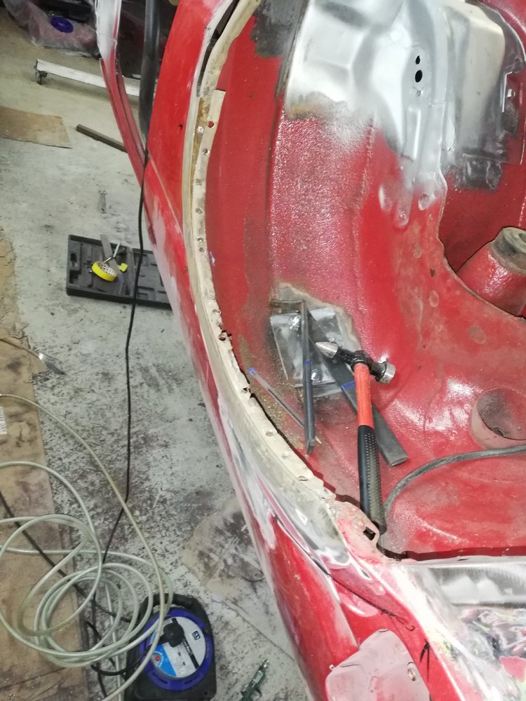

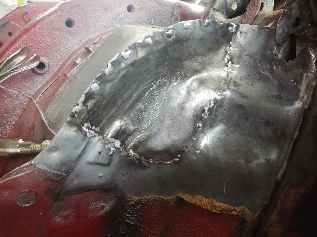

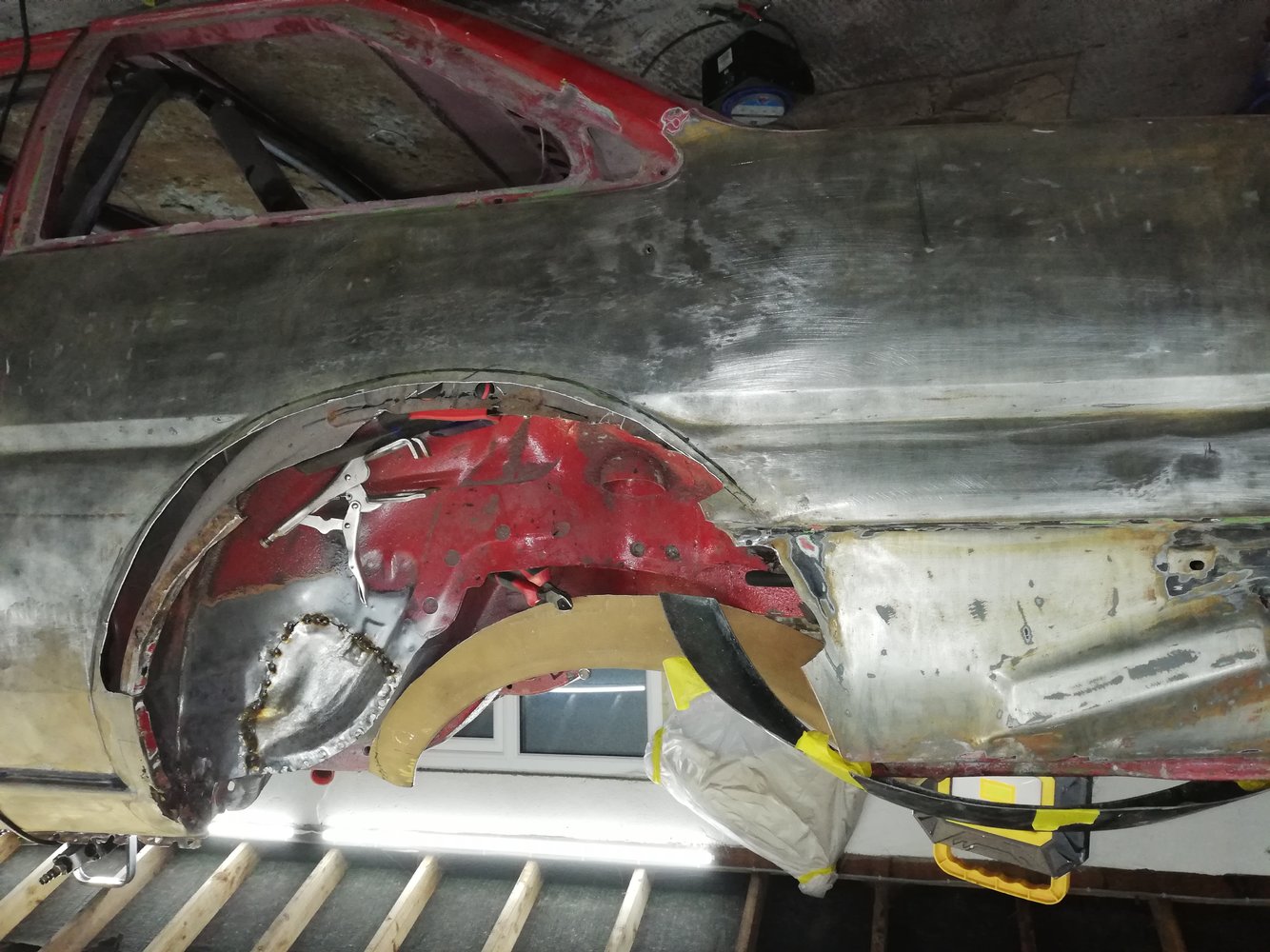

Yeah, I bent it over first, then stretched the flange to form a curve. I started using a crosspein hammer... but soon got bored with that so I switched over to the air-hammer.

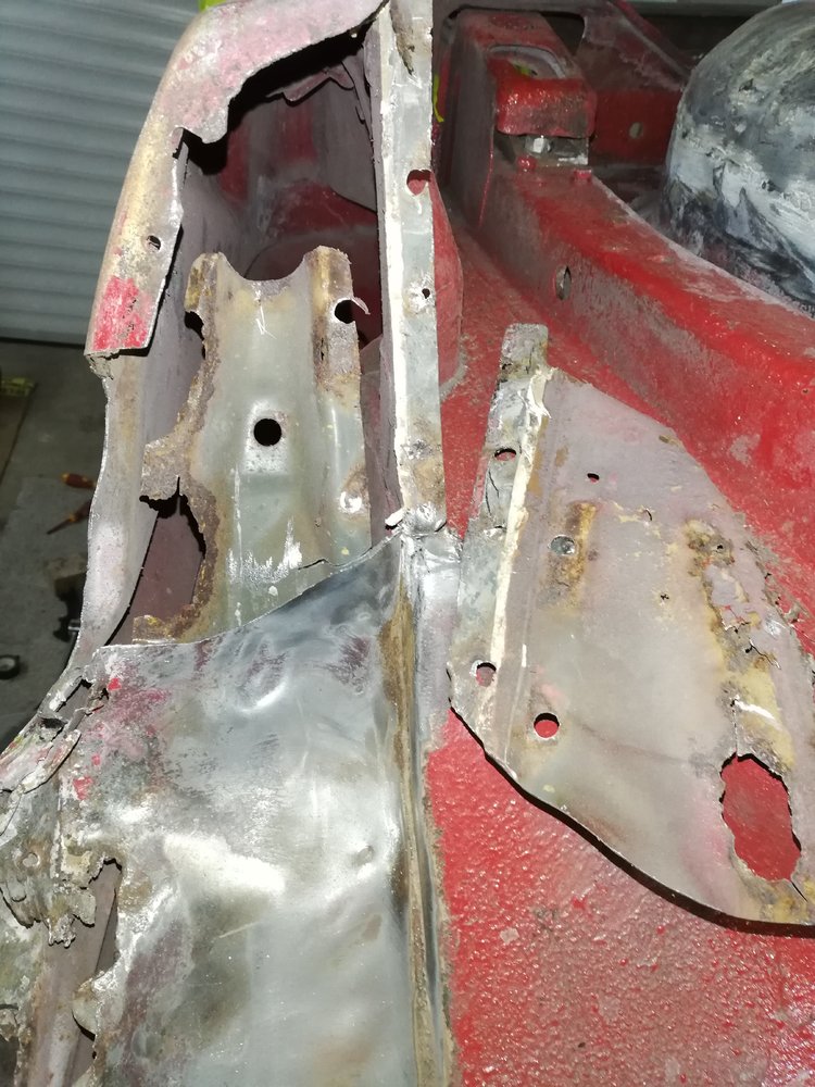

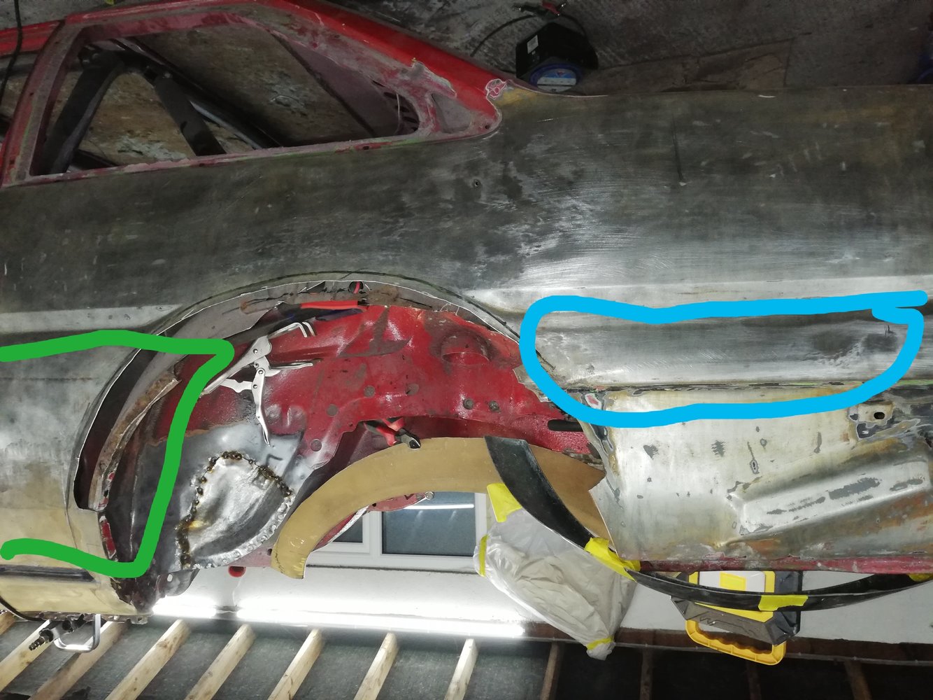

.... bearing in mind the inner and outer wheel arch is non-existent
