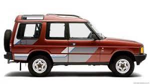

Like one of these?wasnt on about old bangers more modern cars before metric
Then you have the Land Rovers that used a mix of imperial and metric fasteners
