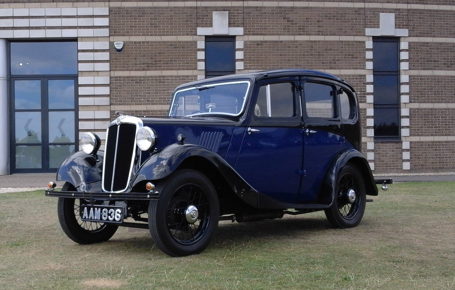

The 918cc engine in the Morris 8 and Minor were metric even in the 1930's. William Morris however, in his infinite wisdom, did insist that although it used all metric threads, all the nuts and bolts would have Whitworth heads on them!
