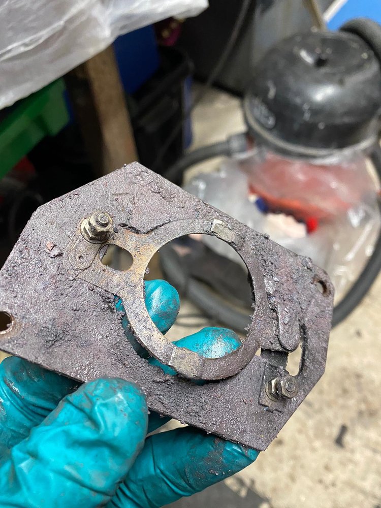

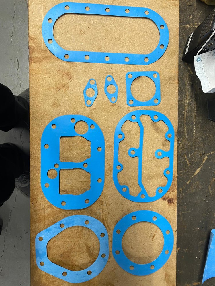

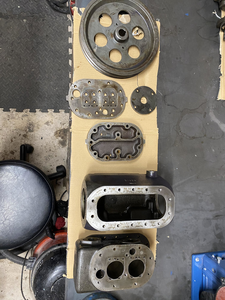

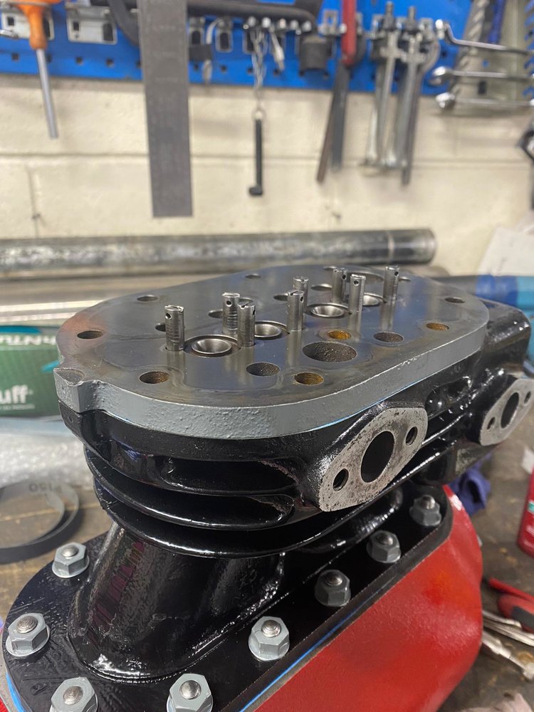

Be careful with the gaskets, given the age it may well be asbestos
That’s a very good point, I’ll be make sure to wear a mask when I scrape it off, thanks for the heads up better to be safe than sorry

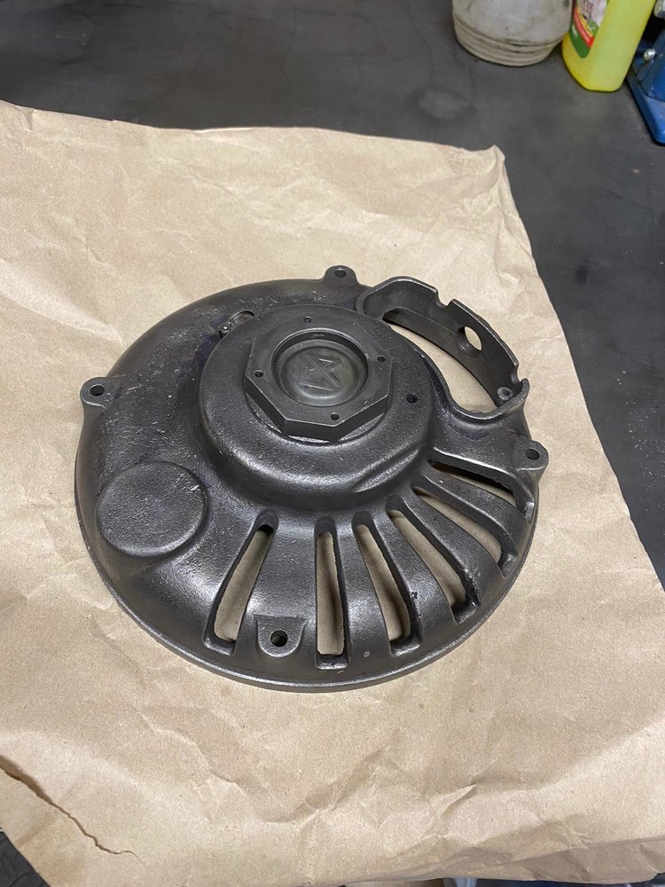

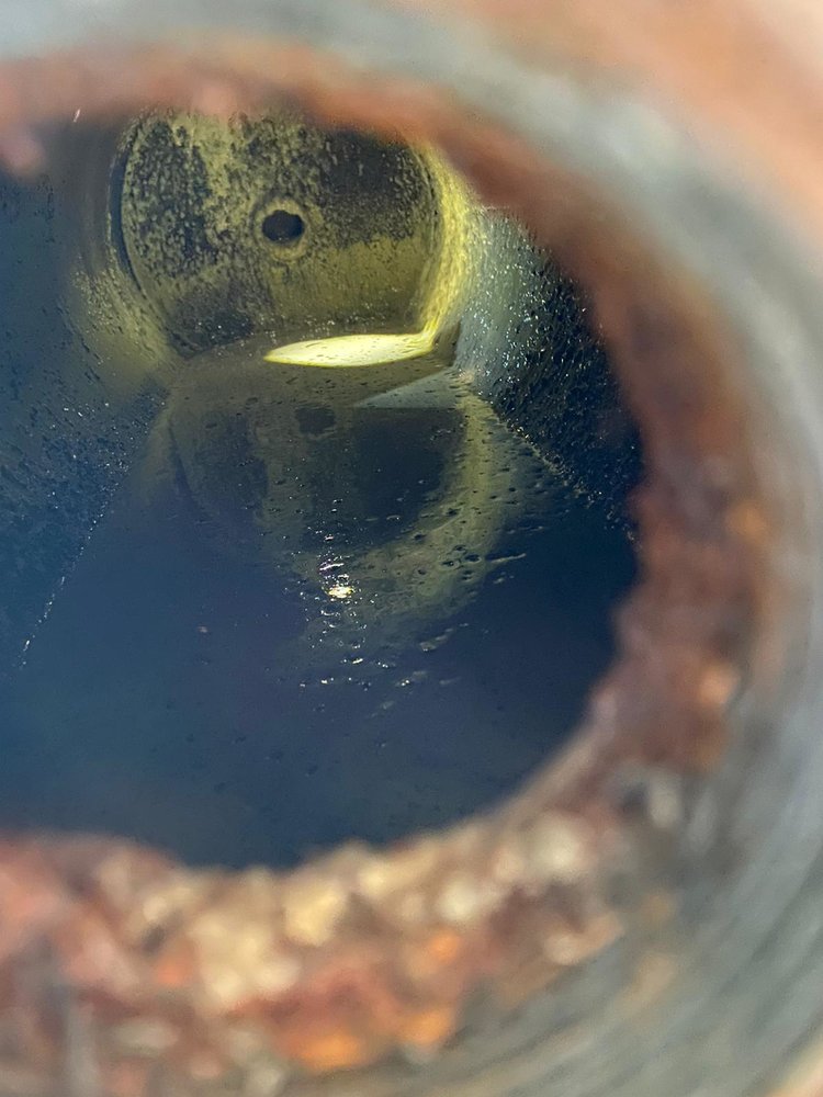

I doubt that that was how it came from the factory. It looks like rust pitting from what I can see.
Better off soaking it in WD40, stops the fibres getting airborne in the first place.That’s a very good point, I’ll be make sure to wear a mask when I scrape it off, thanks for the heads up better to be safe than sorry

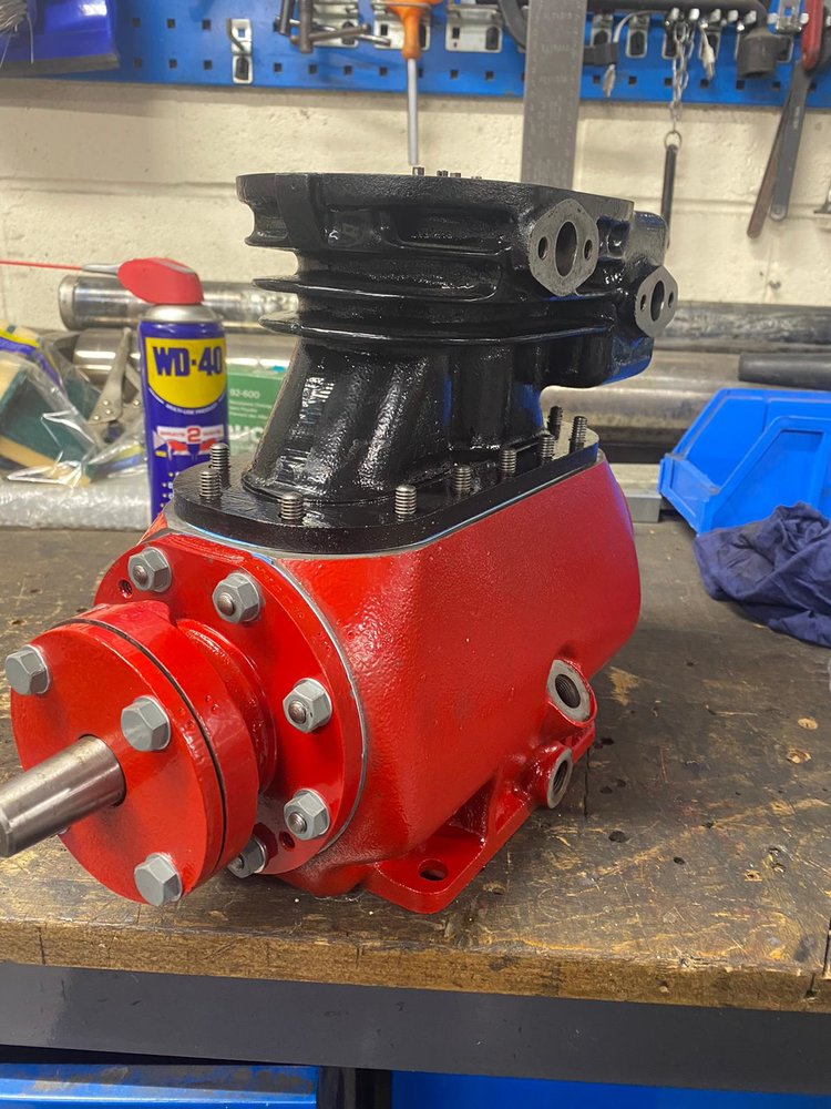

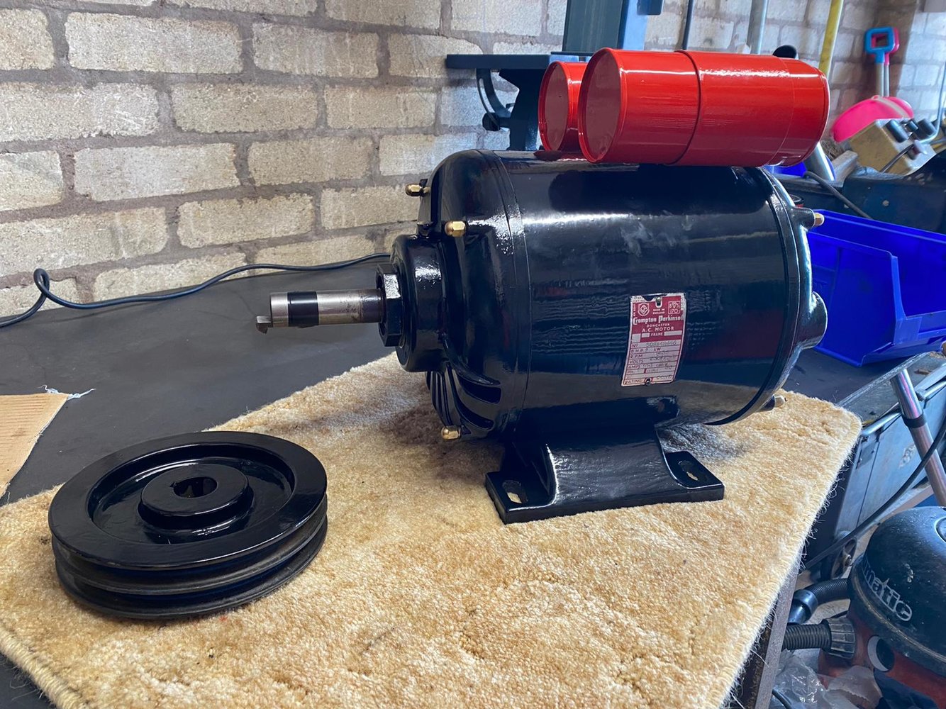

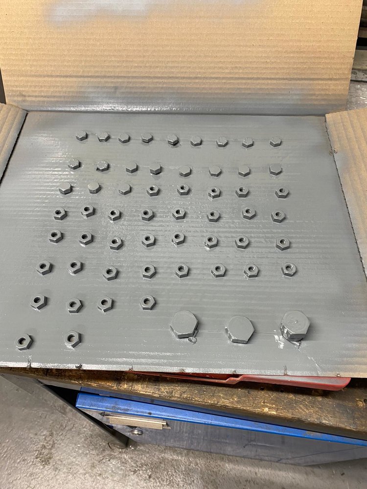

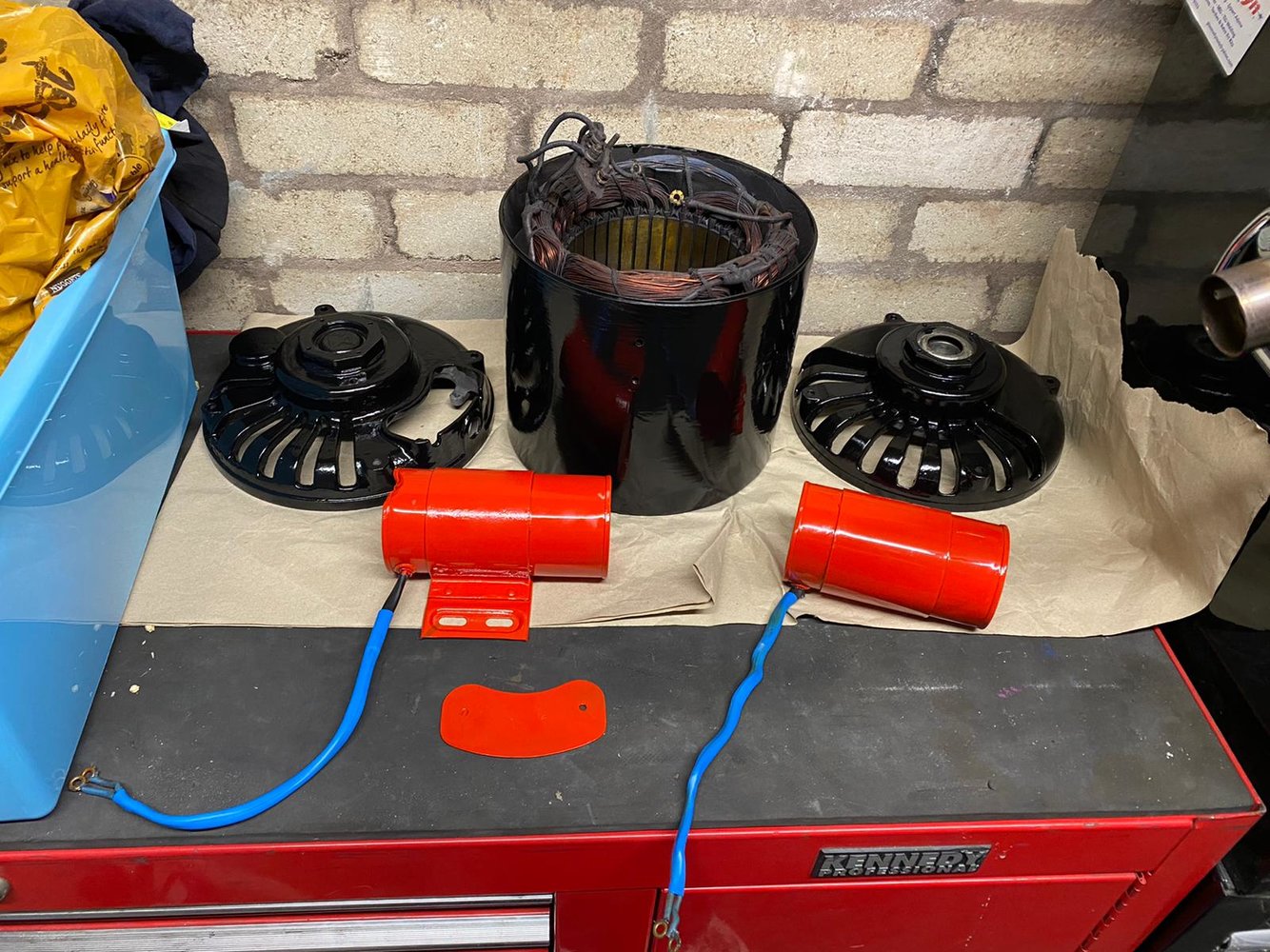

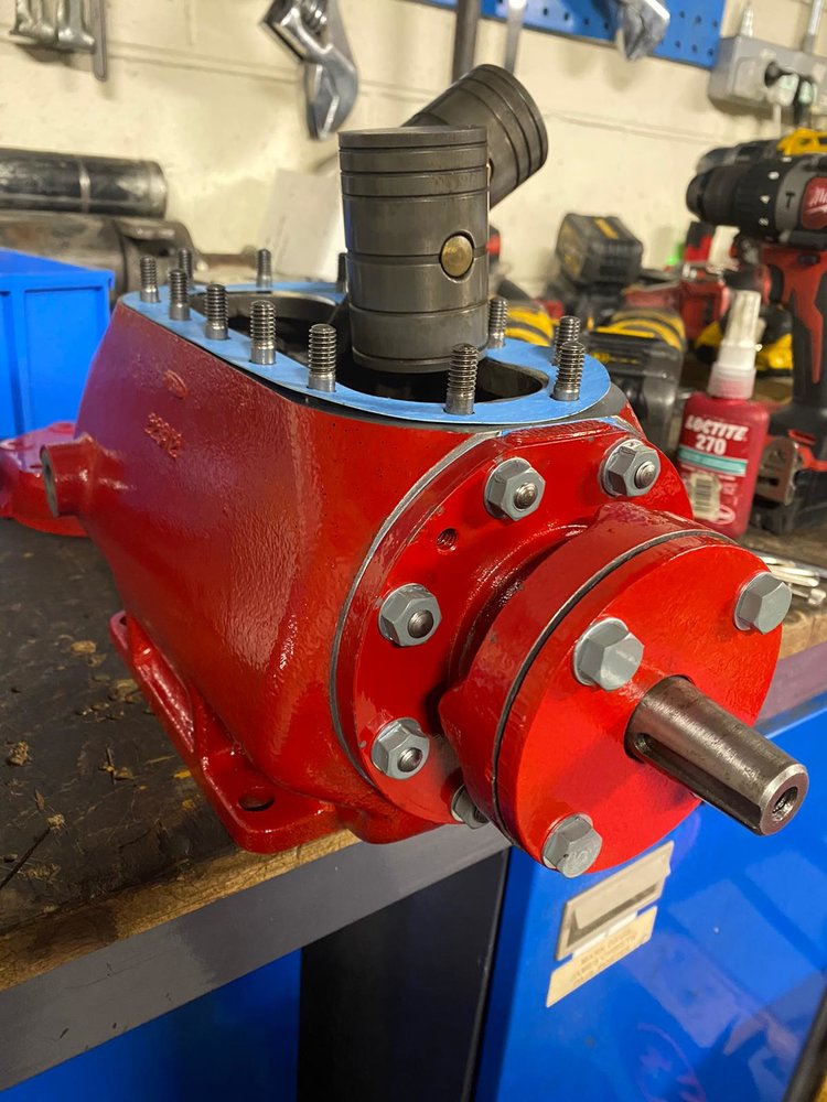

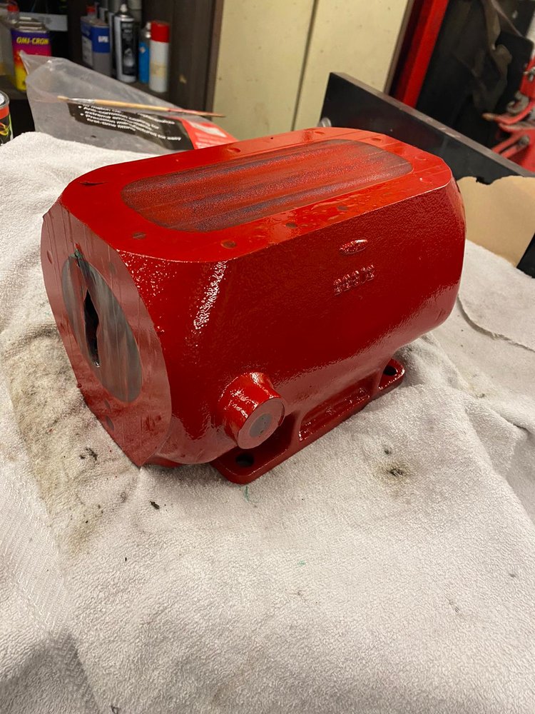

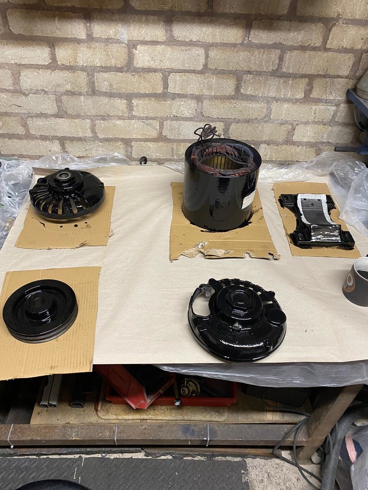

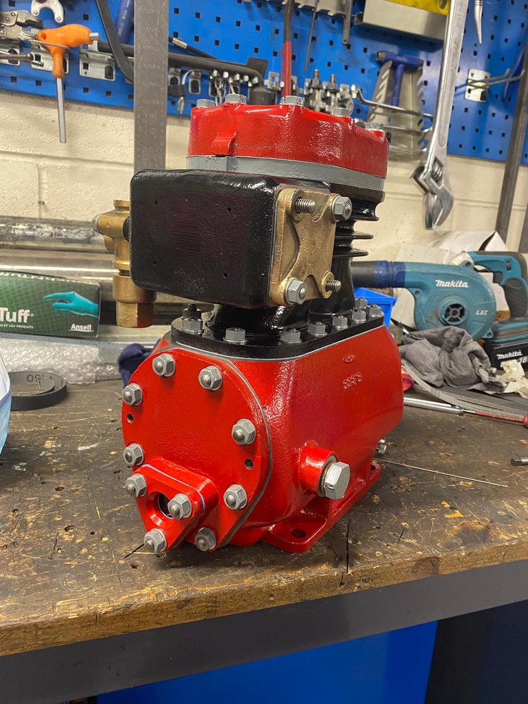

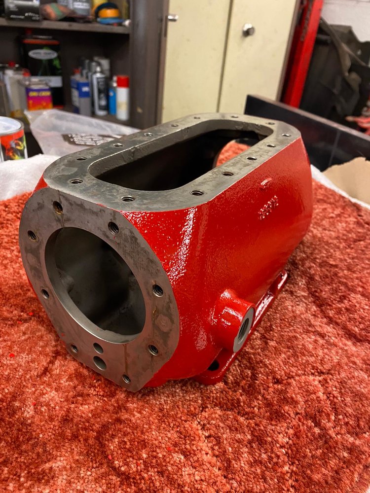

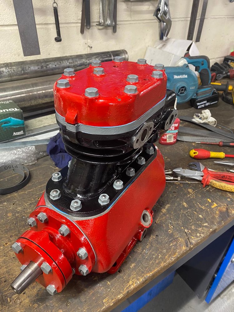

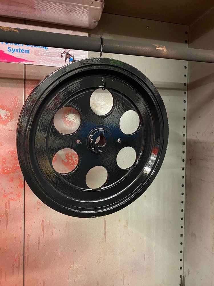

Deep metallic BlueMost definitely no point doing all that to make it looks pants still, just not sure what colours to go, any suggestion?? I’m currently deciding weather I do the motor an tank aswell now or just the compressor for now.

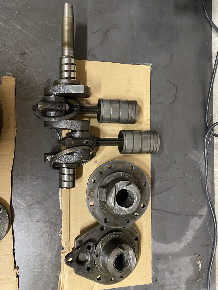

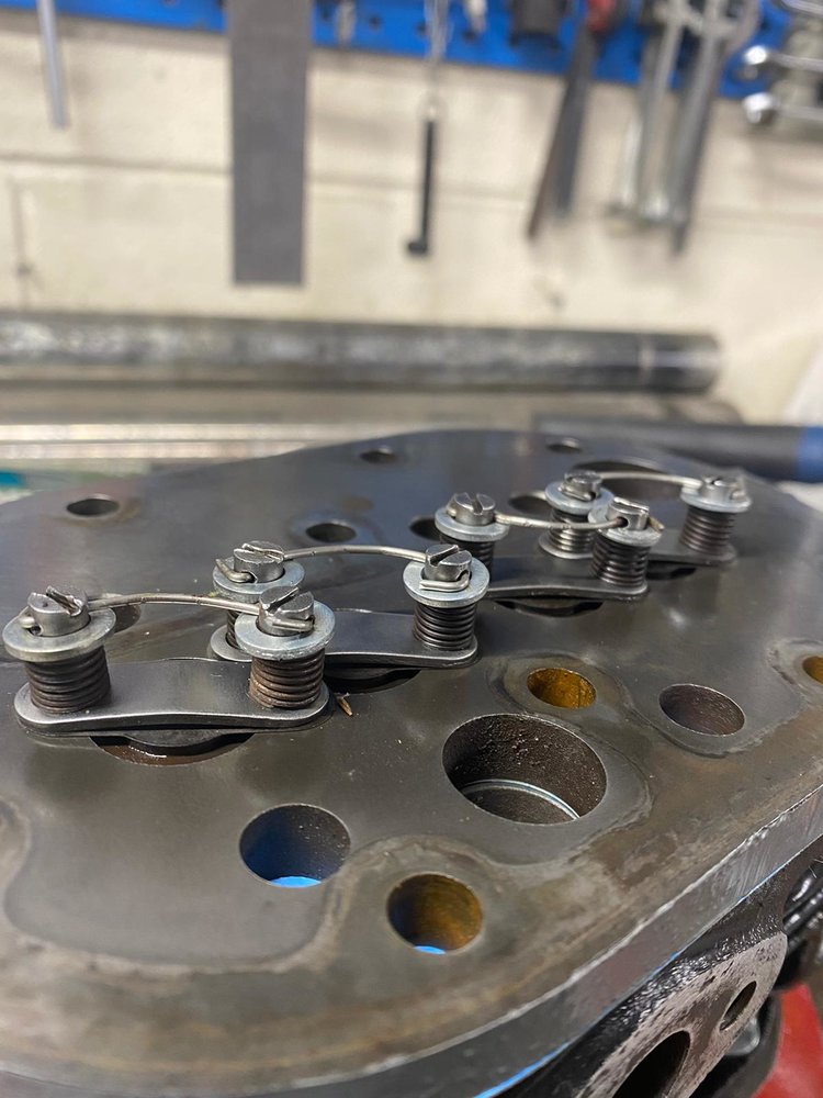

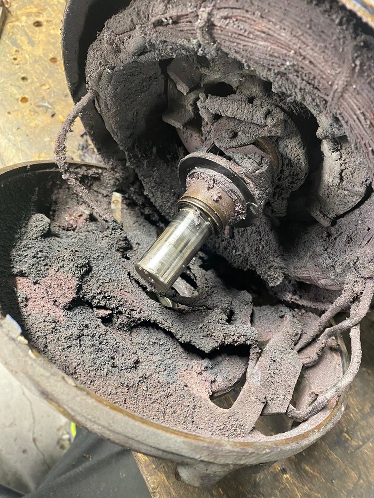

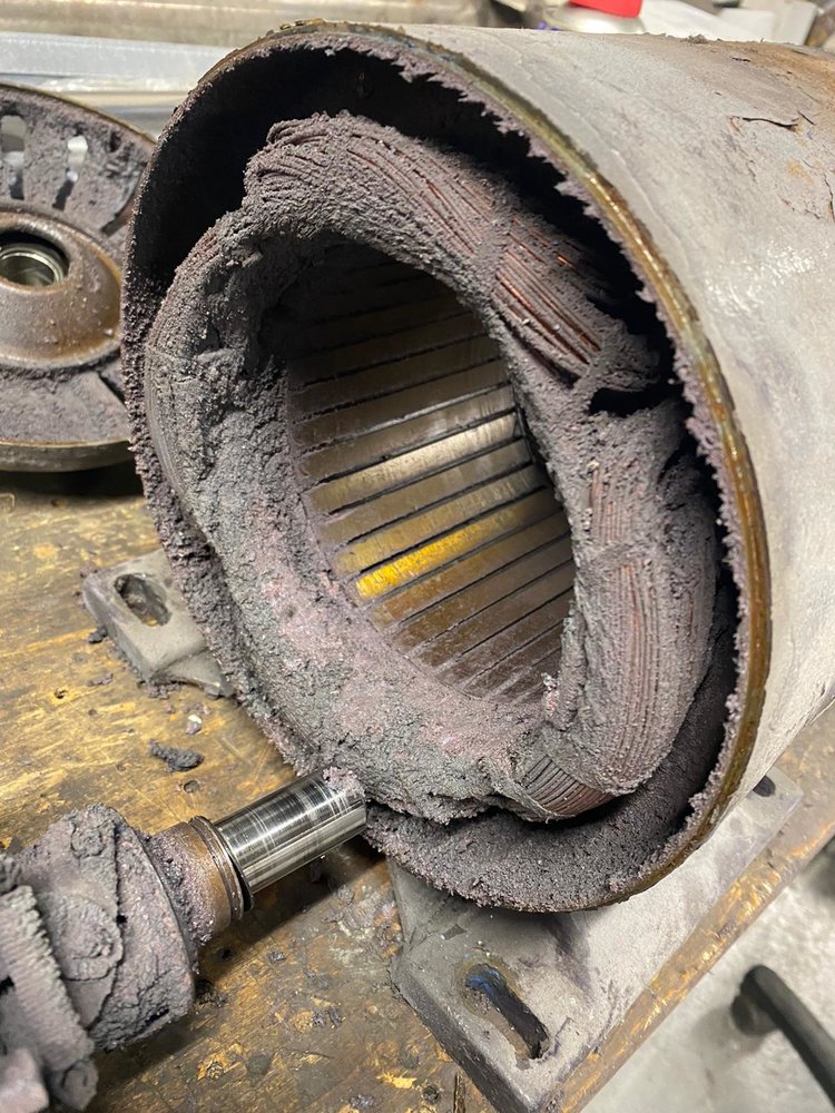

Unlike air compressors ,fridge compressors are not sealed crankcase the intake gas enters the crankcase so an amount of oil will pass through the compressor they normally have an oil separator in the discharge line.continuted
SO like I said not 100% on how there was so much oil in the outlet valve unless its just from years and year of operation, like i said i dunno how ling this has been like it.
Yeah I finally figured that one out after I saw the hole from the inlet into the crank case, haven’t looked in the tank yet to see if there is oil in there too, for the amount of time I’ll be using it, the compressor will at the most run for a hour a week, if I find myself using it more I’ll think about adding a oil separator in of some sort just to incase the oil does get into my airline. Would you know roughly what type of oil is best for these fridge compressors?Unlike air compressors ,fridge compressors are not sealed crankcase the intake gas enters the crankcase so an amount of oil will pass through the compressor they normally have an oil separator in the discharge line.
We always used shell clavus 68 this was in the old days of r22 refrigerantYeah I finally figured that one out after I saw the hole from the inlet into the crank case, haven’t looked in the tank yet to see if there is oil in there too, for the amount of time I’ll be using it, the compressor will at the most run for a hour a week, if I find myself using it more I’ll think about adding a oil separator in of some sort just to incase the oil does get into my airline. Would you know roughly what type of oil is best for these fridge compressors?
Thank you bornfreeWe always used shell clavus 68 this was in the old days of r22 refrigerant

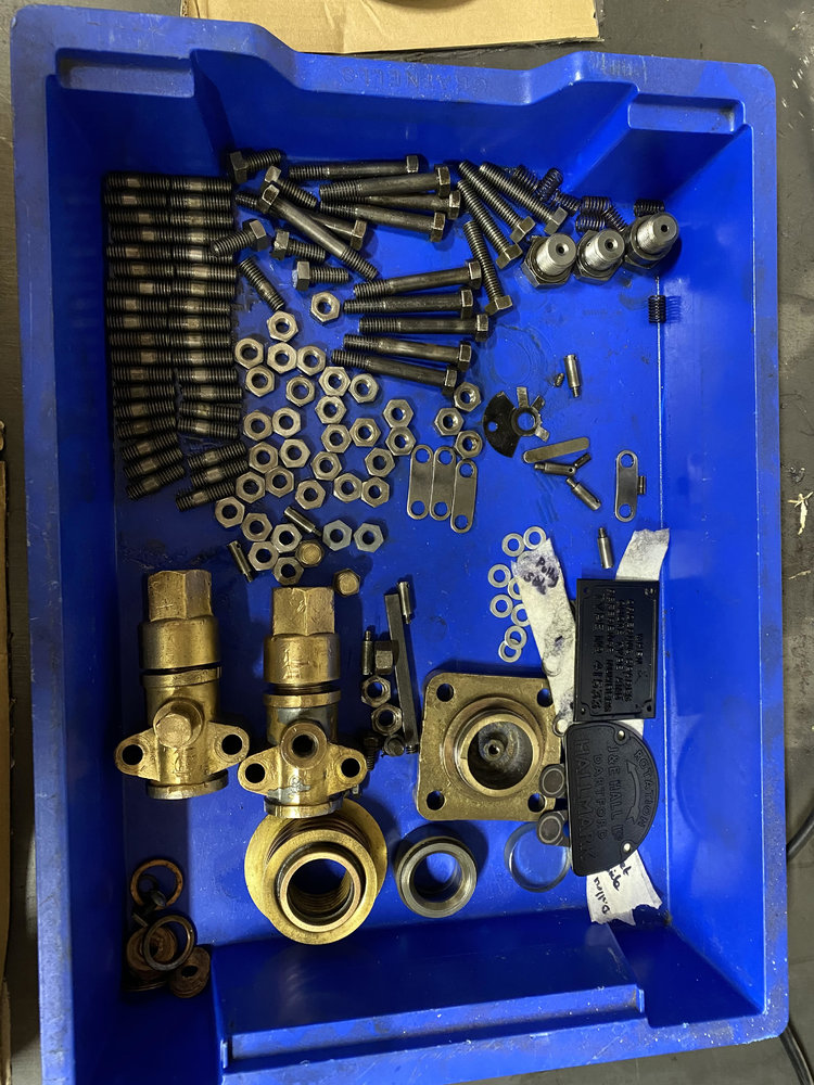

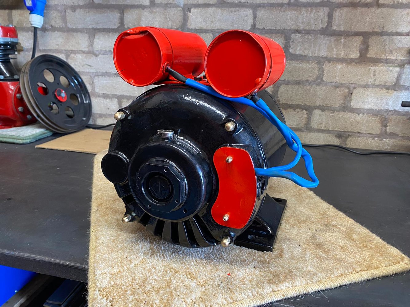

Thank you @3000alloy much appreciatedWow, really impressive. Well done so far.
That rebuild is a credit to you.Thank you @3000alloy much appreciated
