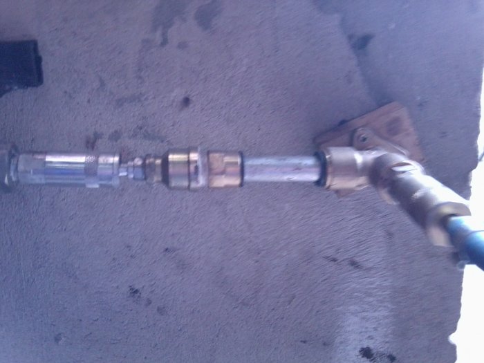

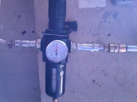

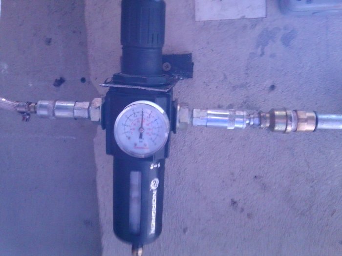

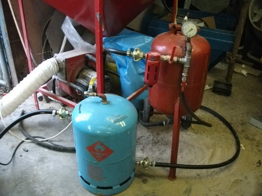

hi mate nice job where did u get the reducer so the 1/4" bsp female coupler could screw in to the metal pipe and what r they called thanks

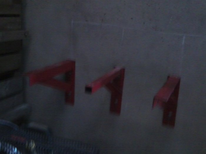

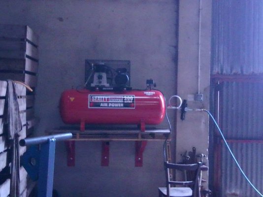

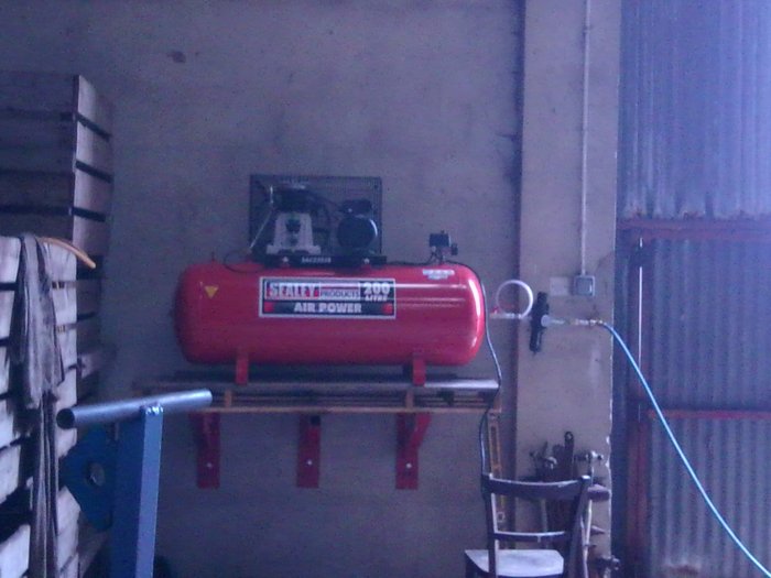

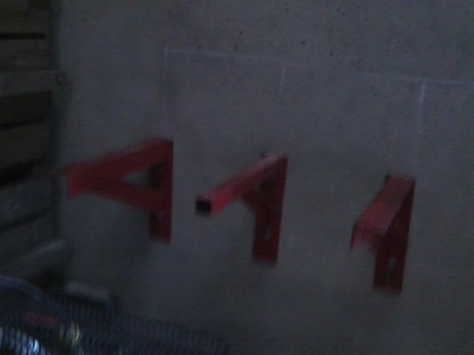

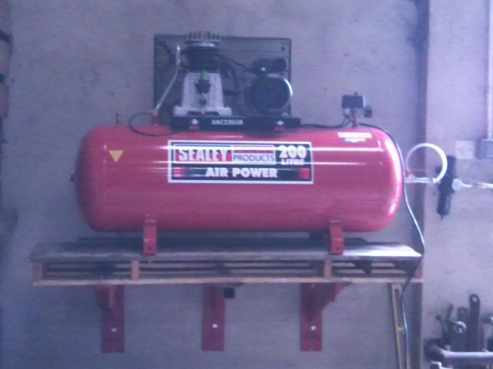

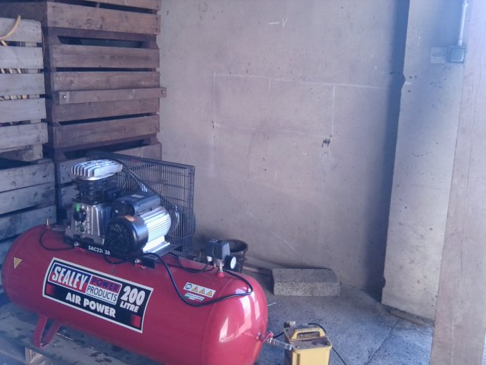

I hope the vibration doesn't loosen the blockwork. I would fit anti-vibration mounts at the very least.

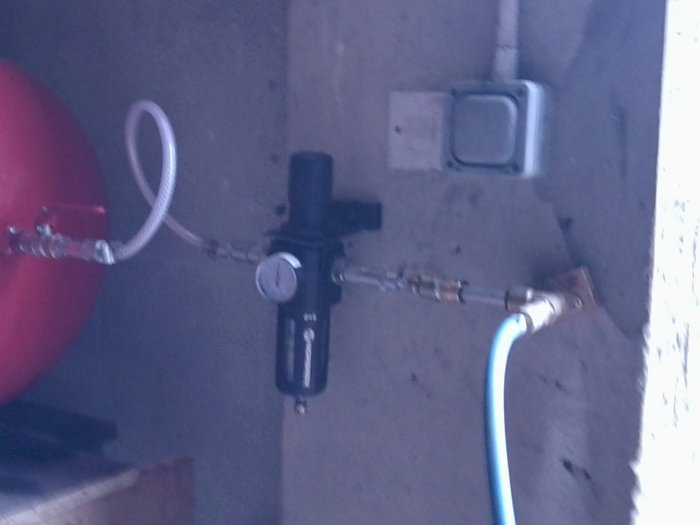

best sometimes to use 2 one on the tank and one near the end of your hose and keep it as sraight as possible i use an extra small tank near the end of the line which helps reduce and catch the condensation if using a lot of airShouldn't the water separator be much further away from the tank, always understood this??.
