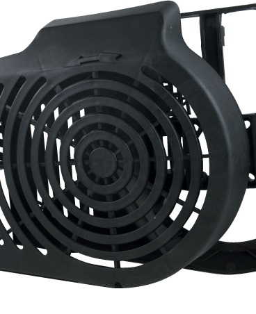

AHH I get it now so my compressor is rated to operate at 11 bar and 16.5 test pressure makes sense now thank you for clearing that up for me you learn something new every day
Thank you I don't know how you found anything on the compressor I looked everywhere I'll get a look at it after dinnerHere is a pdf for abac compressor pumps it lists spare parts and dimensional drawing for them, It also shows recommended power requirements and cfm
Well at least we got to the bottom of it looks like 7cfm on the compressor do you know if these big compressors can run for long before they over heat since you've had a couple yourself my wee cheap compressor £100 job does three cycles then it shuts down for 20 mins to cool down but it does have 9cfm shocking it's half the size of the old girl I appreciate all the helpIve had two ingersoll rand compressors and both have had abac pumps, but only found that file when i purchased my second one as really wanted to know the output of the pump and like you said earlier the model number doesn't seem to get any results only more second hand ones for sale
Now that you have mentioned it what your saying makes sense I wouldn't even of picked up on that I seen the big fan cooling wheel and thought that should keep things cool but as you said it's not actually at it full potential because it just blowing air all over the place I'll see about getting a cover for it and have a look at her tomorrow to check the direction of the fins on the cooling wheel if that's what it's called to see if it's blowing air at the compressor or away from it your a world of knowledge carbon I might end up with a usable compressor at this rate I did notice a air leak under the pump looks like a black bicycle brake cable didn't get a chance to have a proper look at it until tomorrowJust had a quick look online and found one picture that shows the direction to be anticlockwise when looking at the pulley. Not sure if it the one for yours but think air flow should be forced over the pump.
