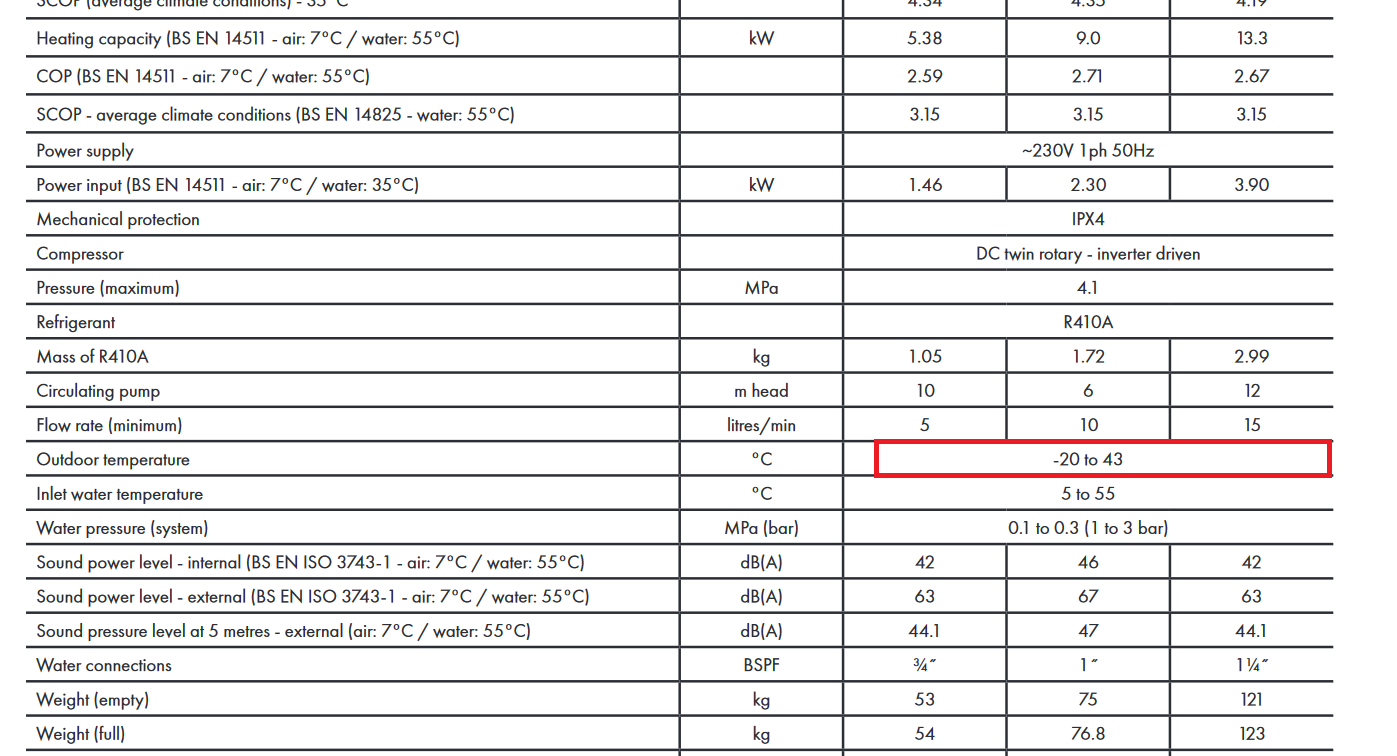

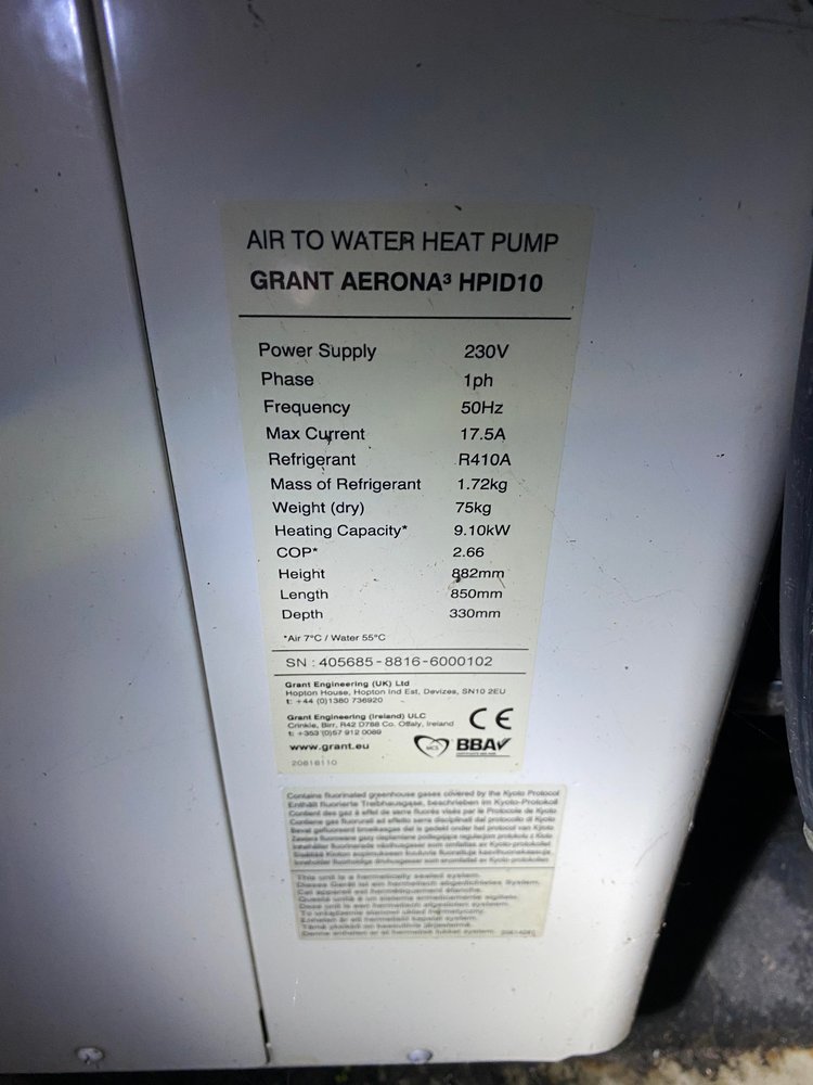

We have a 9.1kW air source heat pump. House is 6 years old, well insulated, current regs etc. Its a wet system so air to water.
UFH downstairs, rads upstairs.
It manages fine all year until the weather gets to circa 0 degrees when the DHW starts to go luke warm and the heating struggles.
Its been serviced etc, and no known faults. We've been told that the heat pump is undersized. A quick wizz round with the laser shows the house is 200m2. The internet tells me that a 9kW heat pump is correct for up to 200m2, 4 bed, well insulated house.
I'll upgrade the heat pump if I have to, but i'm not sure it needs upgrading?
Any ideas of what to do/what the problem might be?![Thumbup :thumbup: :thumbup:](/forum/data/assets/smilies/thumbup5.gif)
