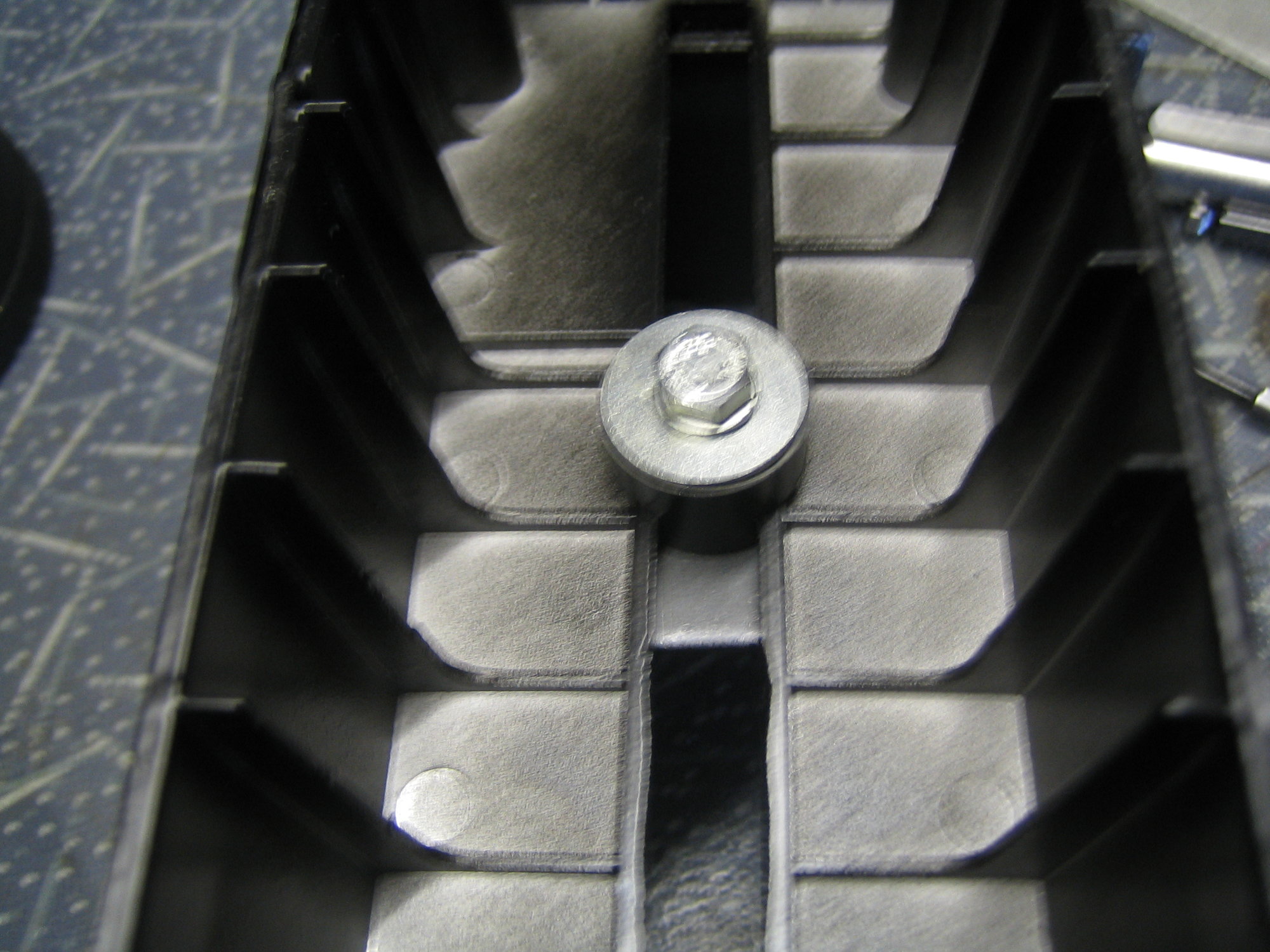

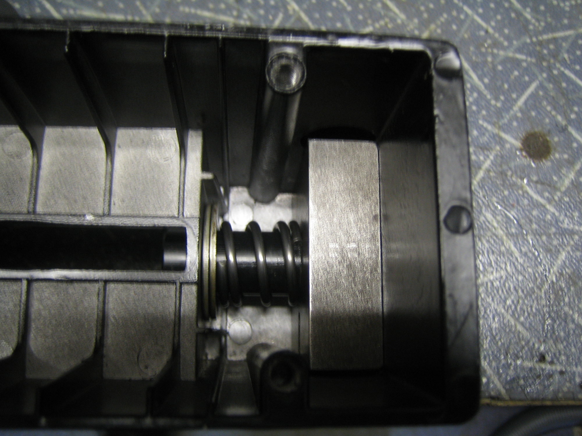

Yep, I'll grab it later and take a few pics, basic mod to stop it riding over, Did post on it but no chance of finding it.You modded the vice I see. I've the earlier 1100 model and the "cam lock" style vice has just basically given up. Did you detail how you modded it? Cheers.
@OnoffSome of the rugby was cancelled so I did some alterations to the vice!

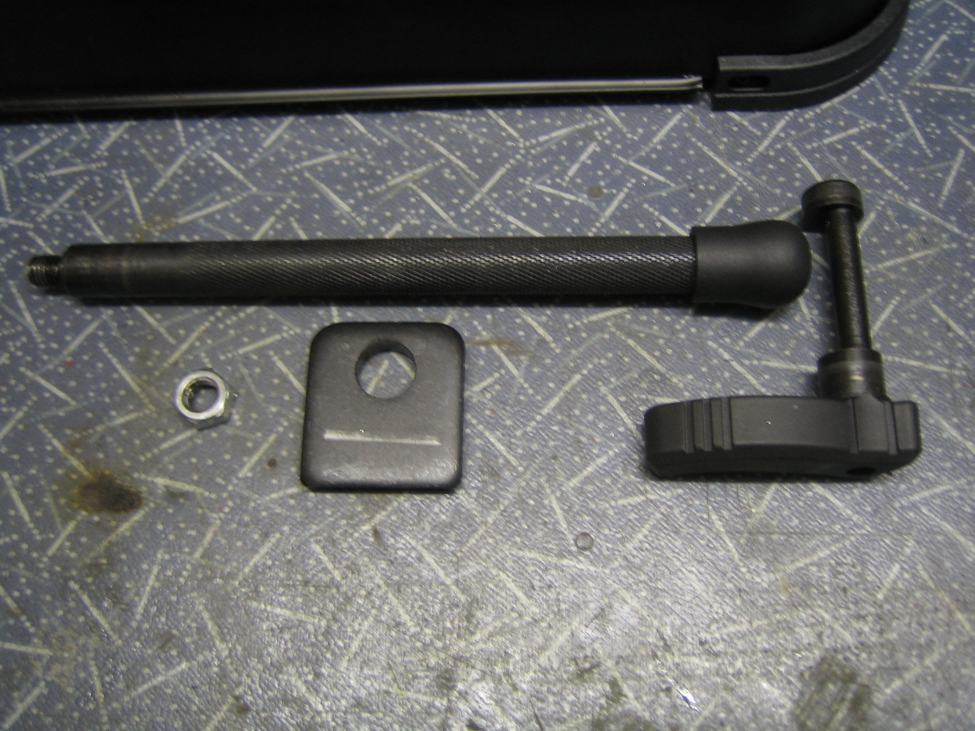

Old system:

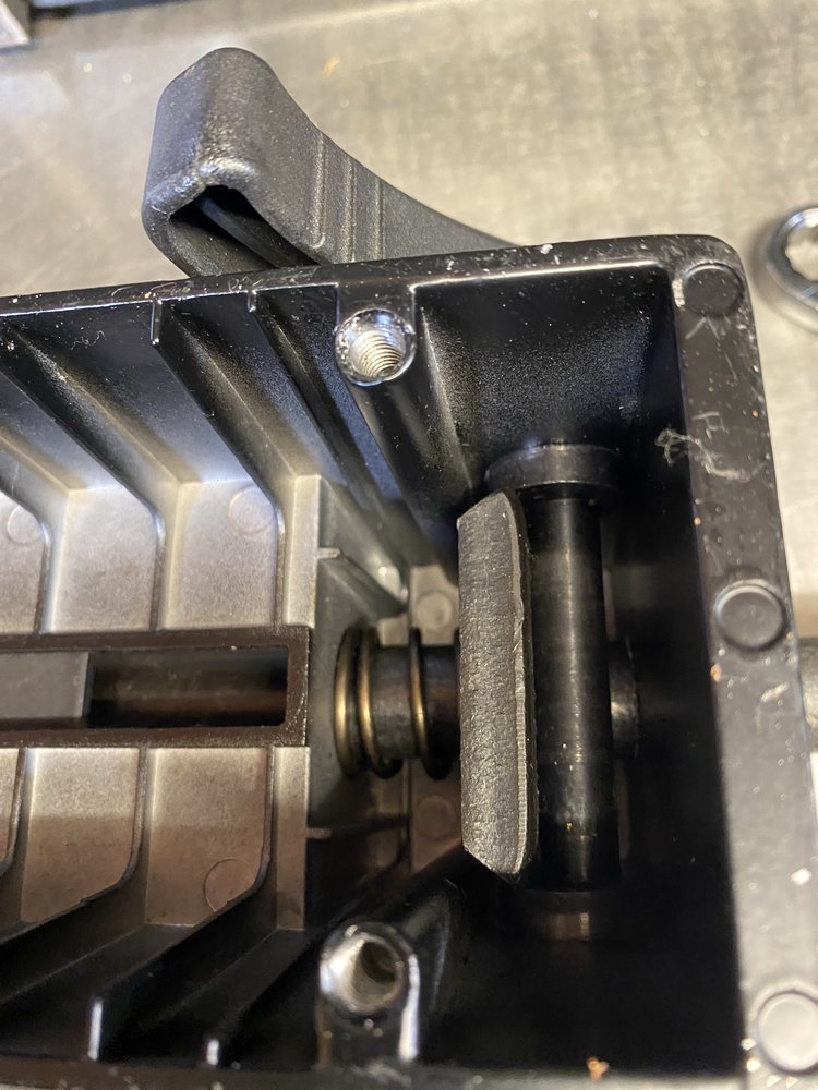

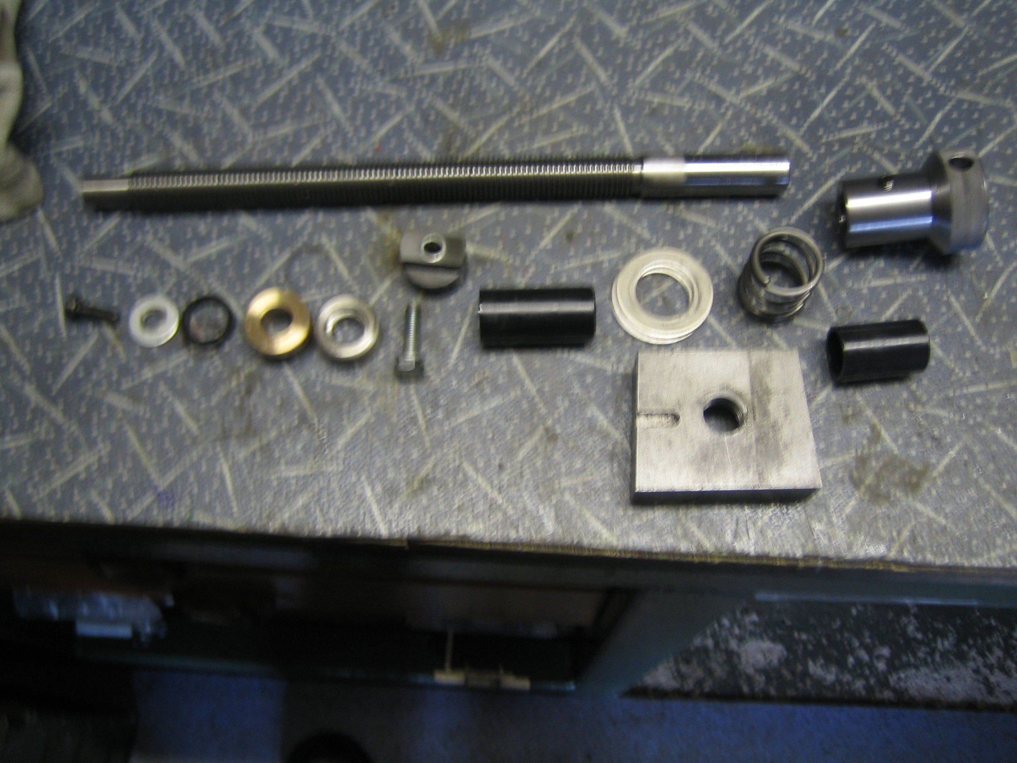

New Parts:View attachment 195966
The threaded steel block is tapered to fit the housing, the original spring, two pieces of plastic conduit and a couple of washers keep it located:

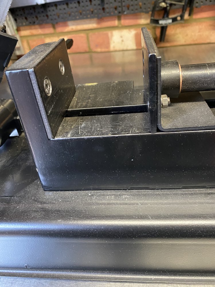

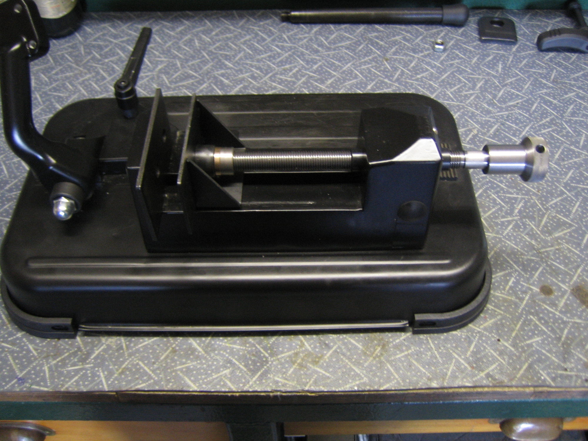

The small nylon T piece is to stop the moving jaw lifting as they put a nice slot in the vice base to allow me to fit it:

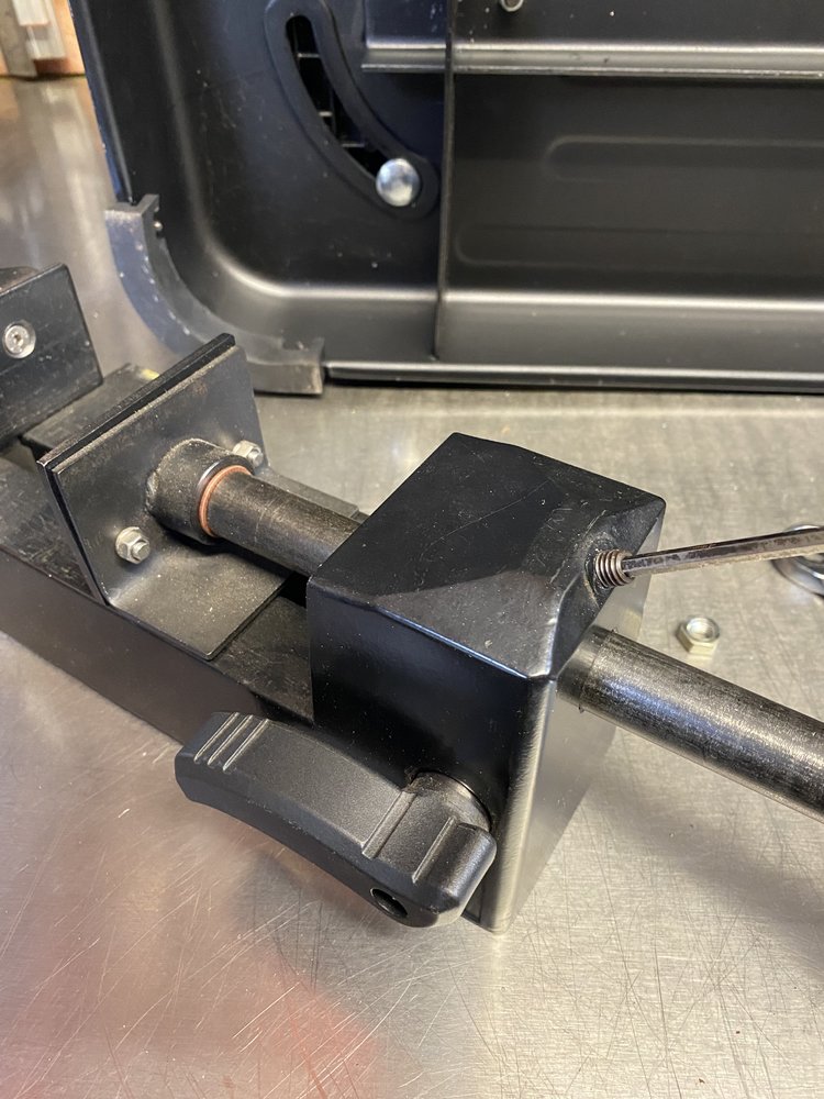

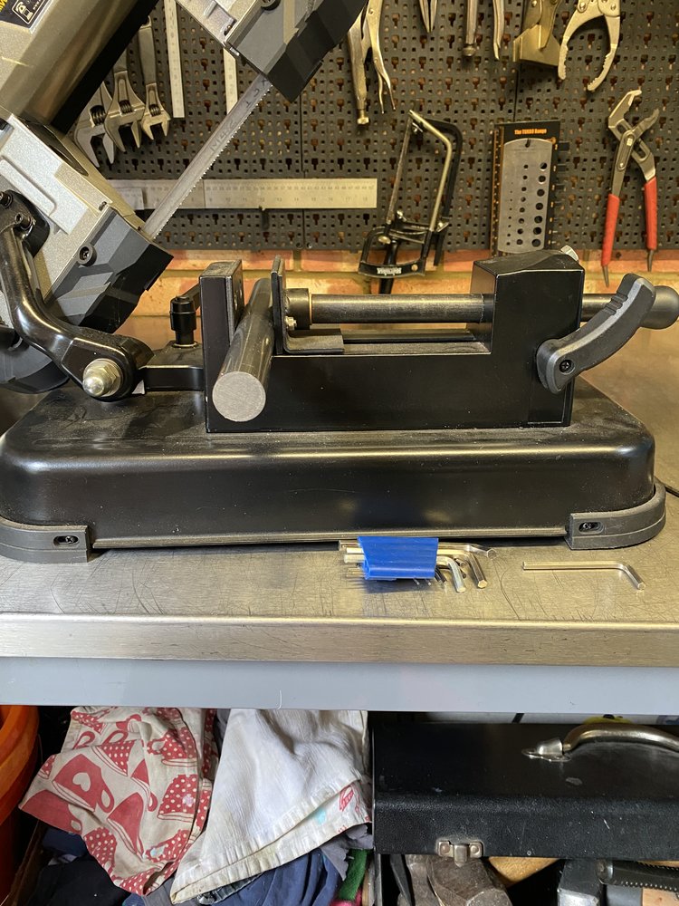

All screwed together:
