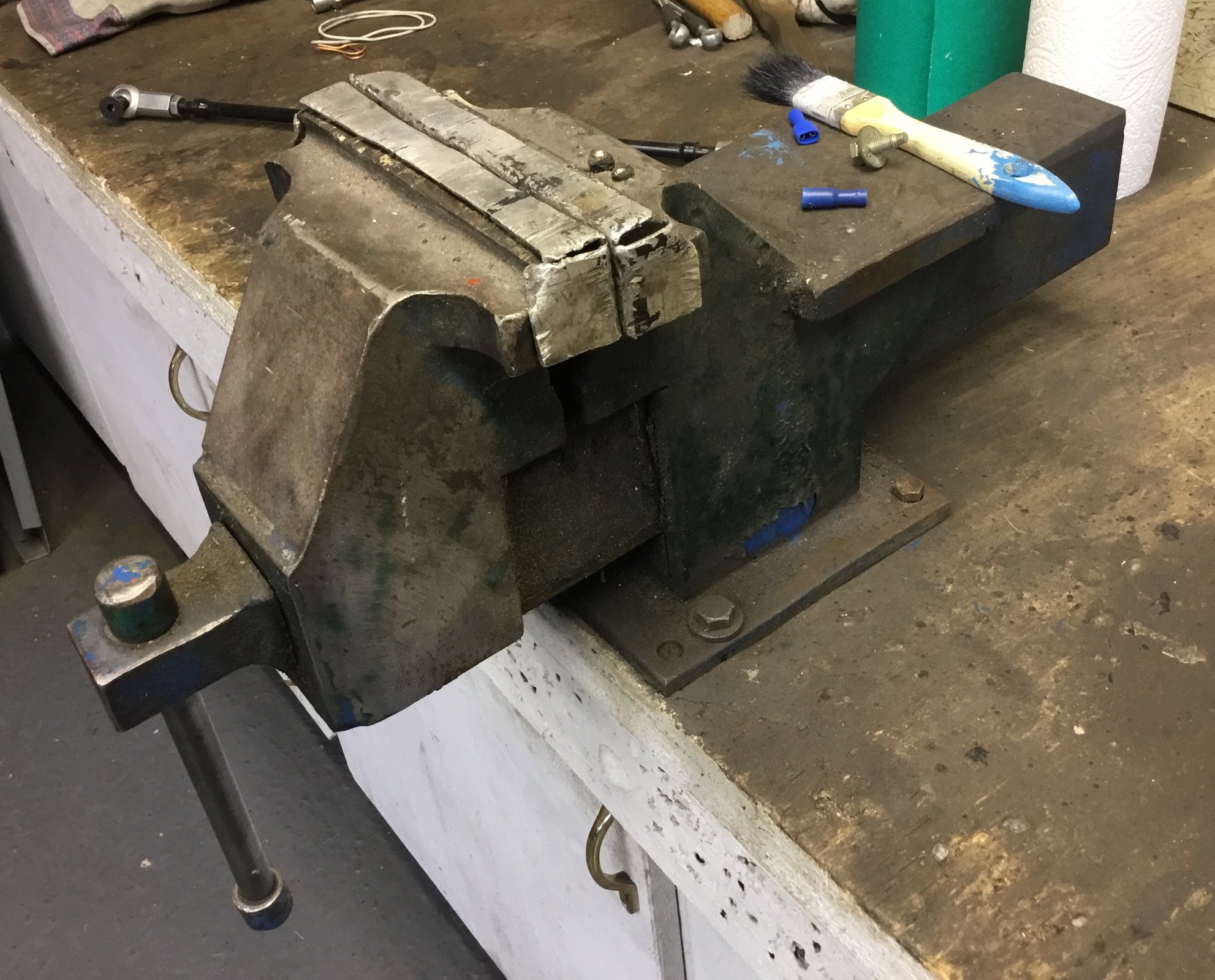

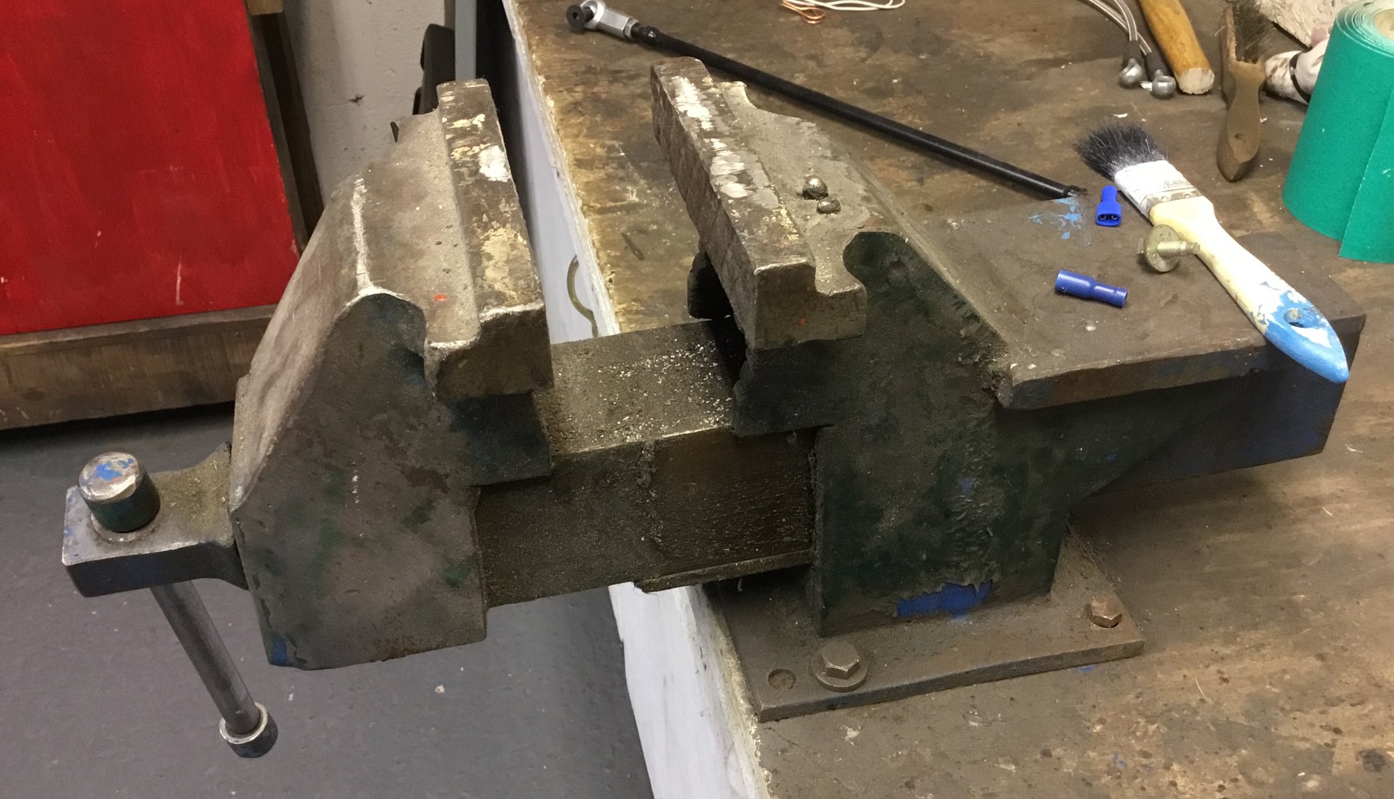

I have a 6” vice in my garage that I bought in the Philippines some 15 years ago. It was hand cut and fabricated entirely from steel plate, very labour intensive. I paid about £10 for it brand new. Labour is cheap in some places......

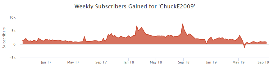

Although might have cost a bit to get it to your home in England.Sad thing about chucke2009 now is that he has drank the coolaid of some of the American extreme preachers and is moving in the direction of ramming his opinions on morality down people's throats. Think he's losing all relevance since his projects have slowed down and he's trying to get a new following. Just a bobble head now really.
You often find large acme screws in posh running machines, used to raise the running bed up, a good source of DC motors as well, and many other things, cheap if not free.Having built 2 very large vices for myself, the biggest issue I found was getting the screw and suitable nut, and a nice pile of suitable scrap steel to sort through. Next issue was making the jaws, you do need a grinder and a largish welder though, and lots of cutting and grinding wheels. I think that my cost was less than $100 each. You could look at machinery wreckers for the screws if they are nearby.
Good value at that price!Although might have cost a bit to get it to your home in England.
That vice is awesome Morrisman, shows what can be achieved with inexpensive tooling if the skills are there
Guy who made that obviously had talent, though like you say not well rewarded for all that
