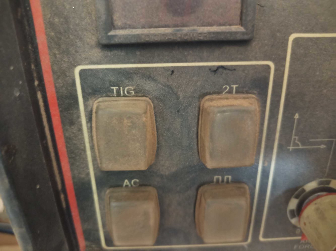

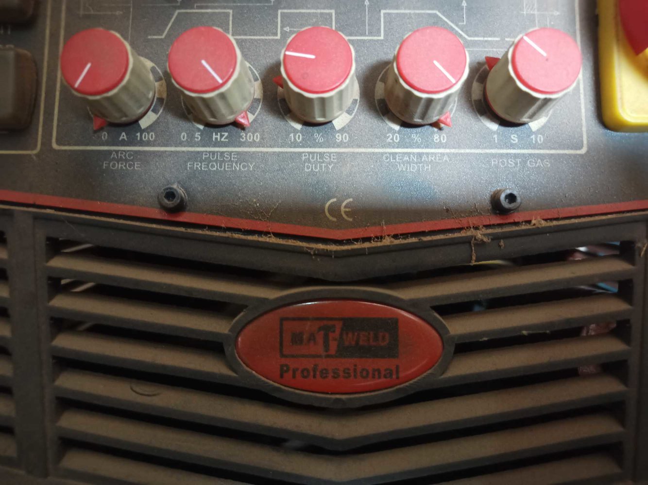

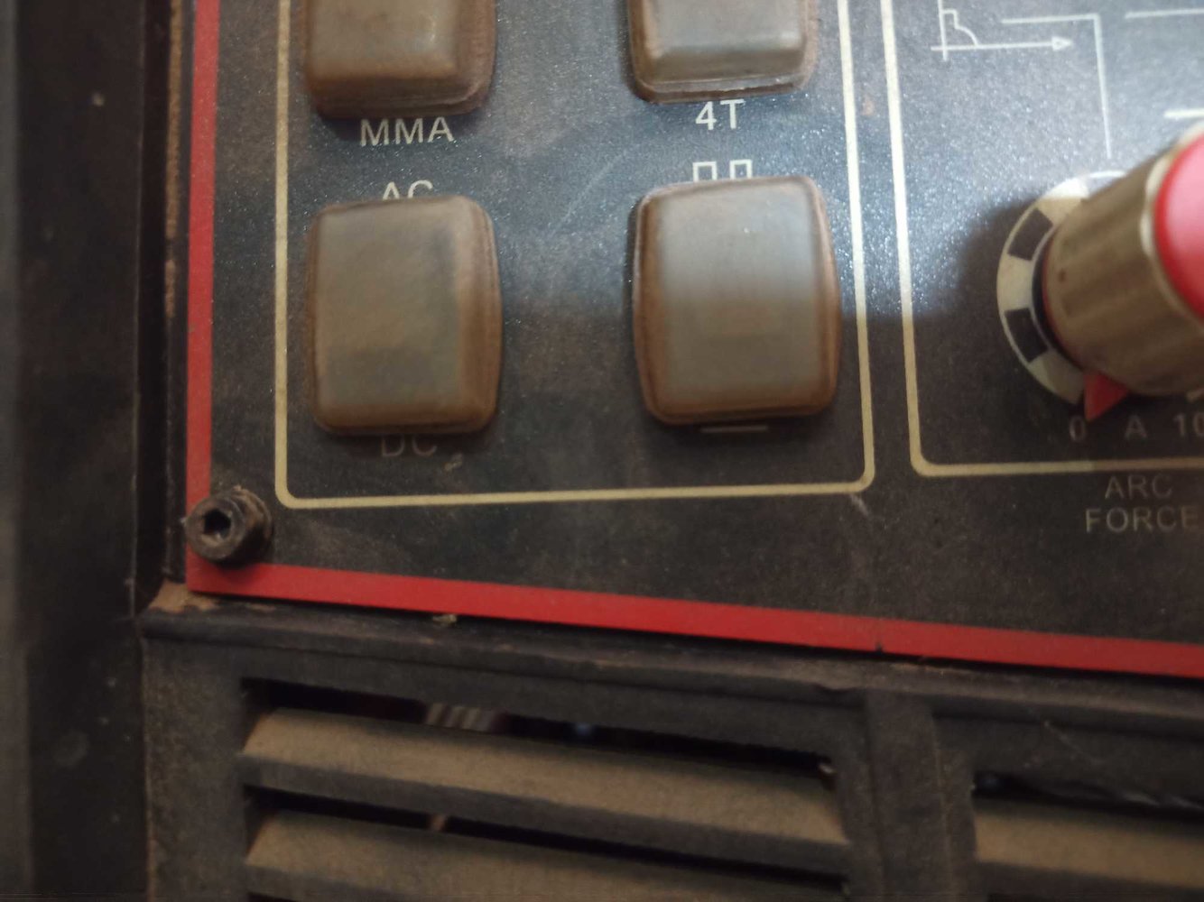

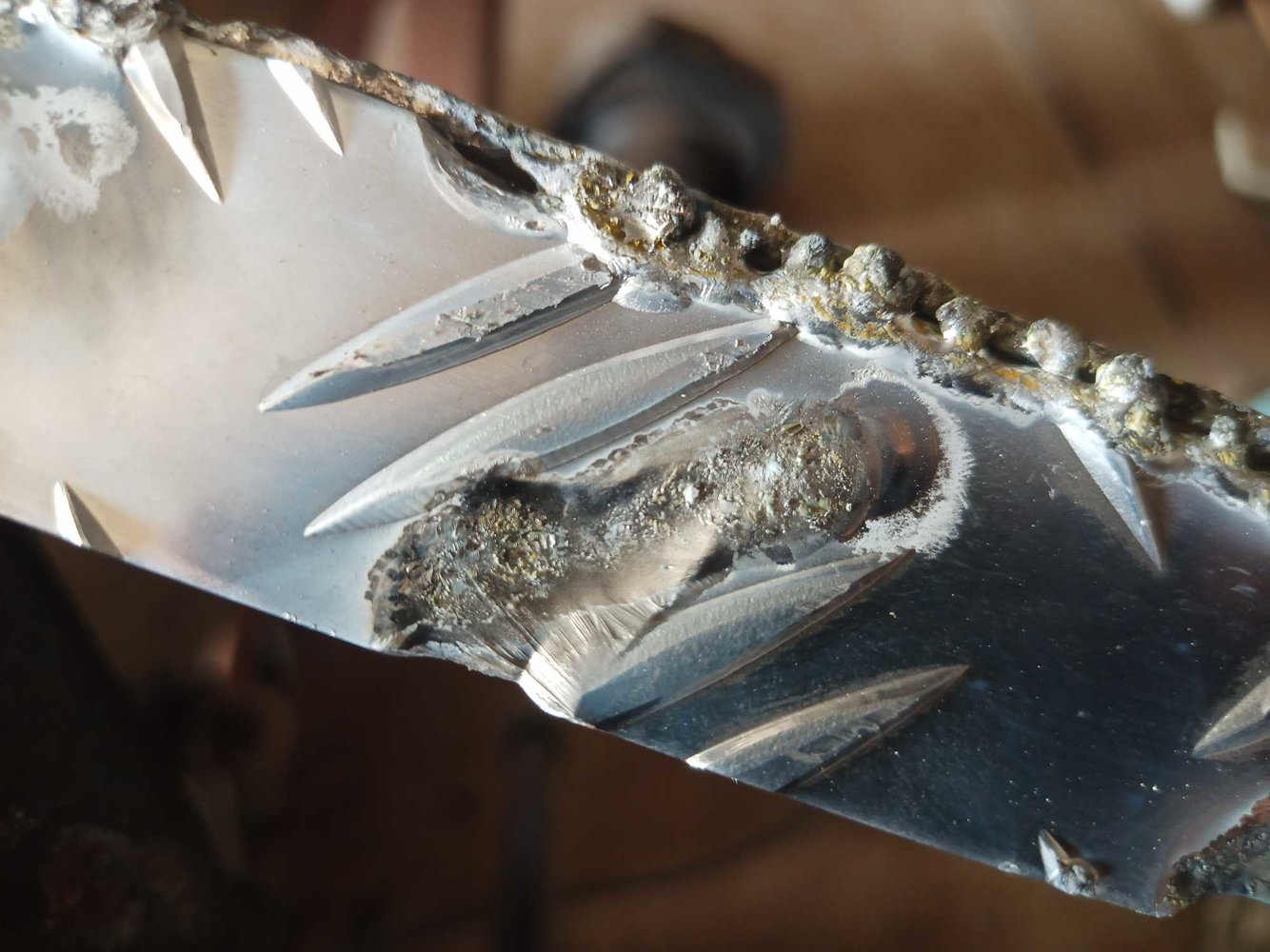

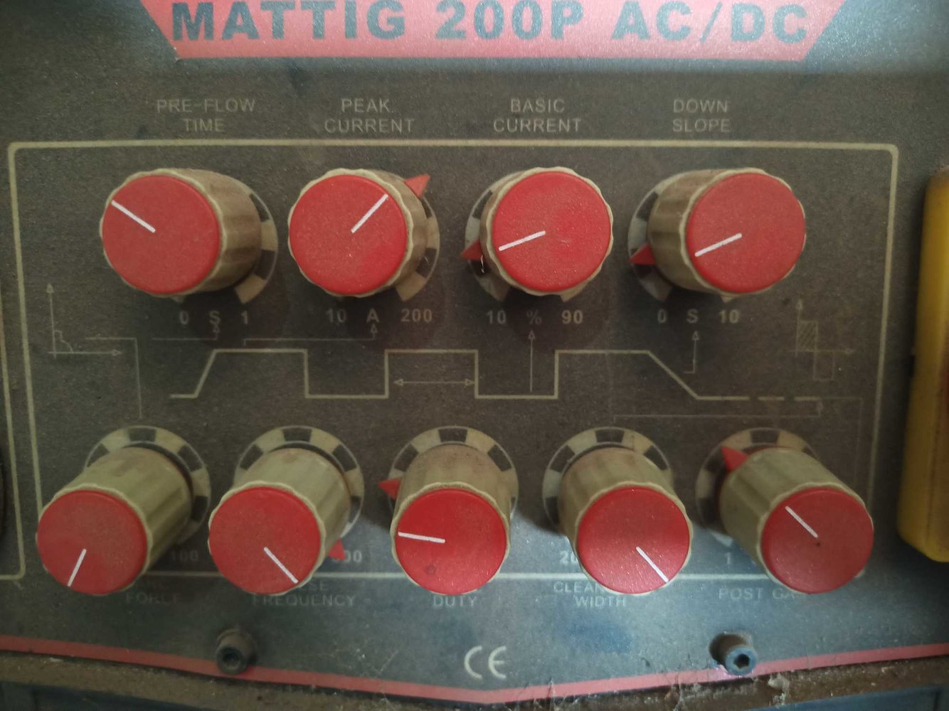

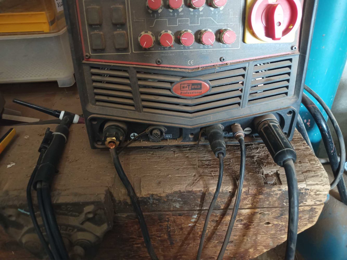

Can anyone please assist me. Im struggling my ass of to get my TIG welder to anything close to good aluminum welding. Ill attach a few pictures can anyone please assist me with the correct settings. I cannot seem to get any settings to work.View attachment 471510View attachment 471509View attachment 471508View attachment 471507View attachment 471506View attachment 471505View attachment 471504

First go, preflow looks ok. Peak current roughly 40 amps per mil of thickness, basic ok, down slope ok, ignore arc force, pulse frequency about 100, pulse duty ok ish, clean area width about 35 to 40. Post gas 8 seconds.
AC, 2T, and pulse the square wave off. 2T is basically arc on when button pressed, and off when released. 4 T is for not holding button down.

YesMust the torch be in the neg side and the ground clamp on the pos side?

Ideally clean off any oxidation and anodising using a stainless steel wire brush, used only for aluminium. Before using the brush, totally degrease the surface, using panel wipe or similar, and allow this to evaporate. The metal has to be scrupulously clean before welding.How do you clean off the anodizing. I start 3mm from the Aluminum.
It is set to AC but where must the torch go + or -
You can "bump weld" anodized but it's not a beginner friendly process. The best thing to do for your practicing is to grind the shiny bright surface off altogether using a clean flap wheel. It's a relatively thick coating usually so a little bit of wire brushing doesn't usually help much.How do you clean off the anodizing. I start 3mm from the Aluminum.
New clean non anodised metal, when learning remove anything that might cause issues until you get going…or there is a good chance youll get so frustrated you give up.As addjunkie and Munkul have said, that's anodised. If you look at it you can actually see where the aluminium is melting under the anodised coating.
This is because anodising is basically a oxide coating but thicker than the one you get on bare aluminium and it melts at something like 4 times the temperature of the alloy underneath it.
You need to get rid of the anodised finish and back to bare aluminium.
1.6 is probably too small for that metal, but might just work to get a puddle if you get the settings right. Did you adjust the 'Cleaning Width' control as suggested above? (It is set at 80% in the photos).Good morning. Can it be that my tungsten is too thin. I have 1.6mm tungsten and it is as if it burns away
The Clean Area Width control is effectively the AC balance. Start with this set to about 50%.
How must I check itDid you check the Argon flow at the torch itself ?
It was on pulse will switch off pulse and try again. Where do I adjust the ac frequency1.6 is probably too small for that metal, but might just work to get a puddle if you get the settings right. Did you adjust the 'Cleaning Width' control as suggested above? (It is set at 80% in the photos).
Are you using pulse, or just plain AC? (I can't tell from the photos). If you are using pulse, switch it off - there's probably not enough heat going into the work.
Try setting your AC frequency down to mid range too (about 80Hz).
