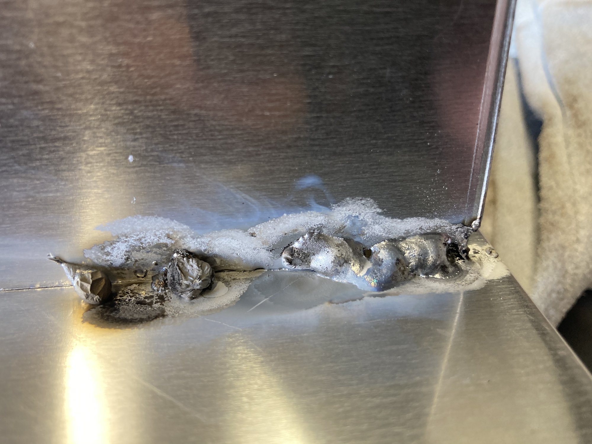

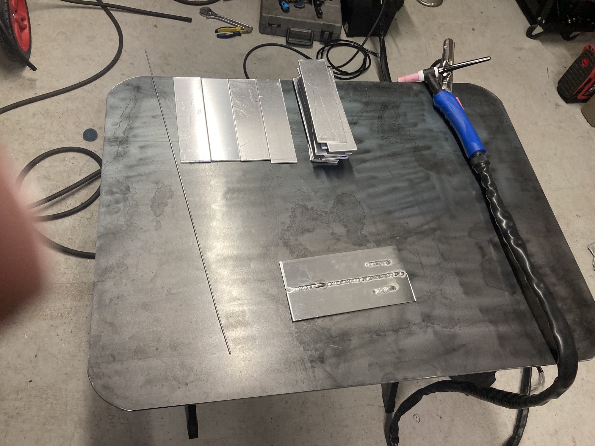

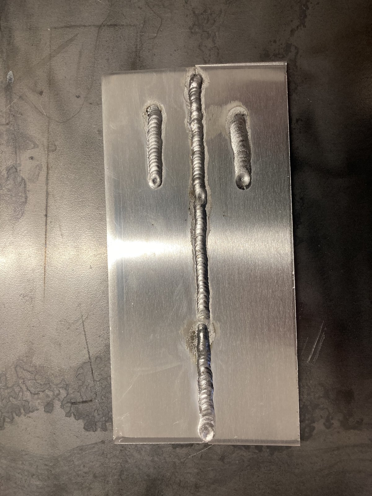

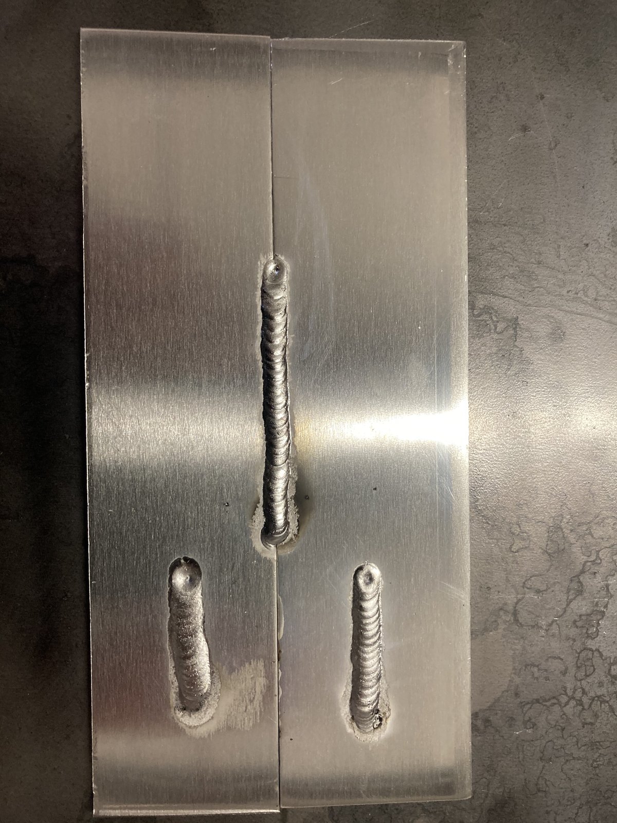

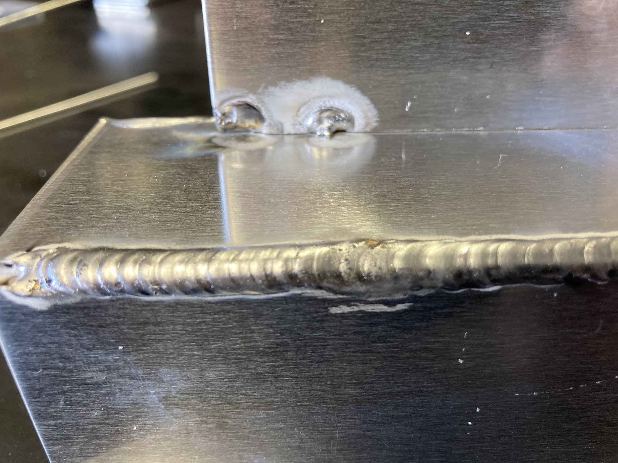

No, the Sherman doesn't have the trigger tap function. What you would be best doing is use 2T with a long downslope, if things are getting to hot then release the trigger and keep welding as much as you can but repress the trigger before the slope ends and it will go back to main, you can repeat that as often as you need as long as you always repress before the downslop ends.
Nice, i see the experinced an, tnx a lot
