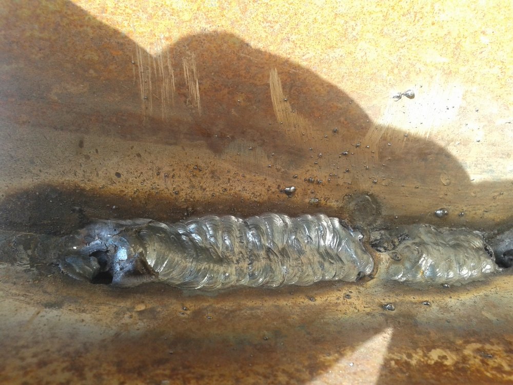

I think you can forget about distinguishing the pool or slag on vert up, and rely on timing and watching for build up on toes for regulating speed
Just practicing I meantGrinding lines along the sides of a weld is bad news - It creates a bad stress raiser and increases the liklihood of a fracture.
It works for me, thats why I stated-I think....Why?
I dont know what chalk youre using, but I want some.Not how I read it and, I can assure you, easier to follow and burn away a chalk line (when practicing) than a tram line ground into metal being welded!
