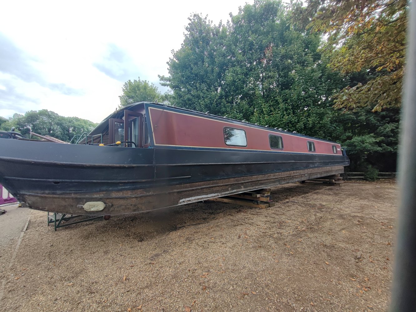

Evening folks.
I'm after a bit of guidance. Although I do a fair amount of arc welding with my work on narrowboats Its been a while since I've had to do any overhead welding and most of the time its 6 mm steel but this time Im having to overplate the bottom corners of the boat and the base is being done with 100mm by 10mm flat and up the side will be 6mm so it all matches the specs of the hull. I'll be using bohler aws 6013 rods. i've got 2.5 , 3.2 and 4mm's but would would you guys recommend and what amps
