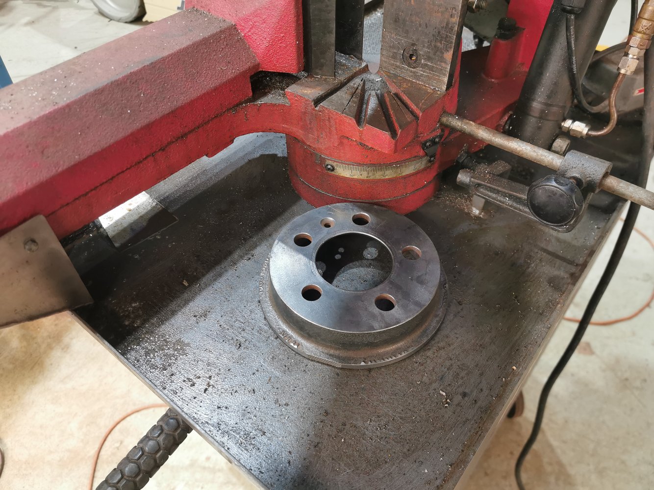

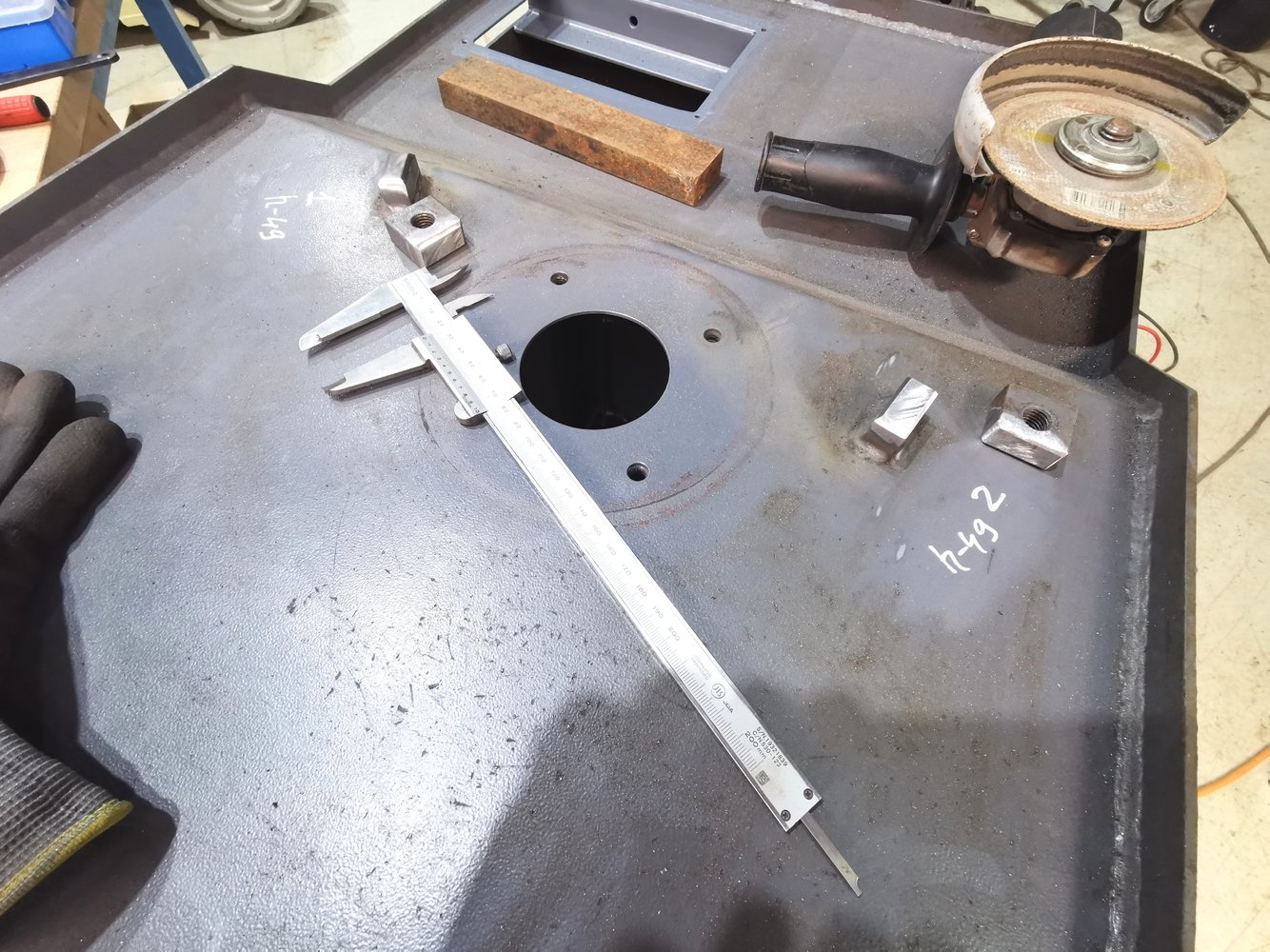

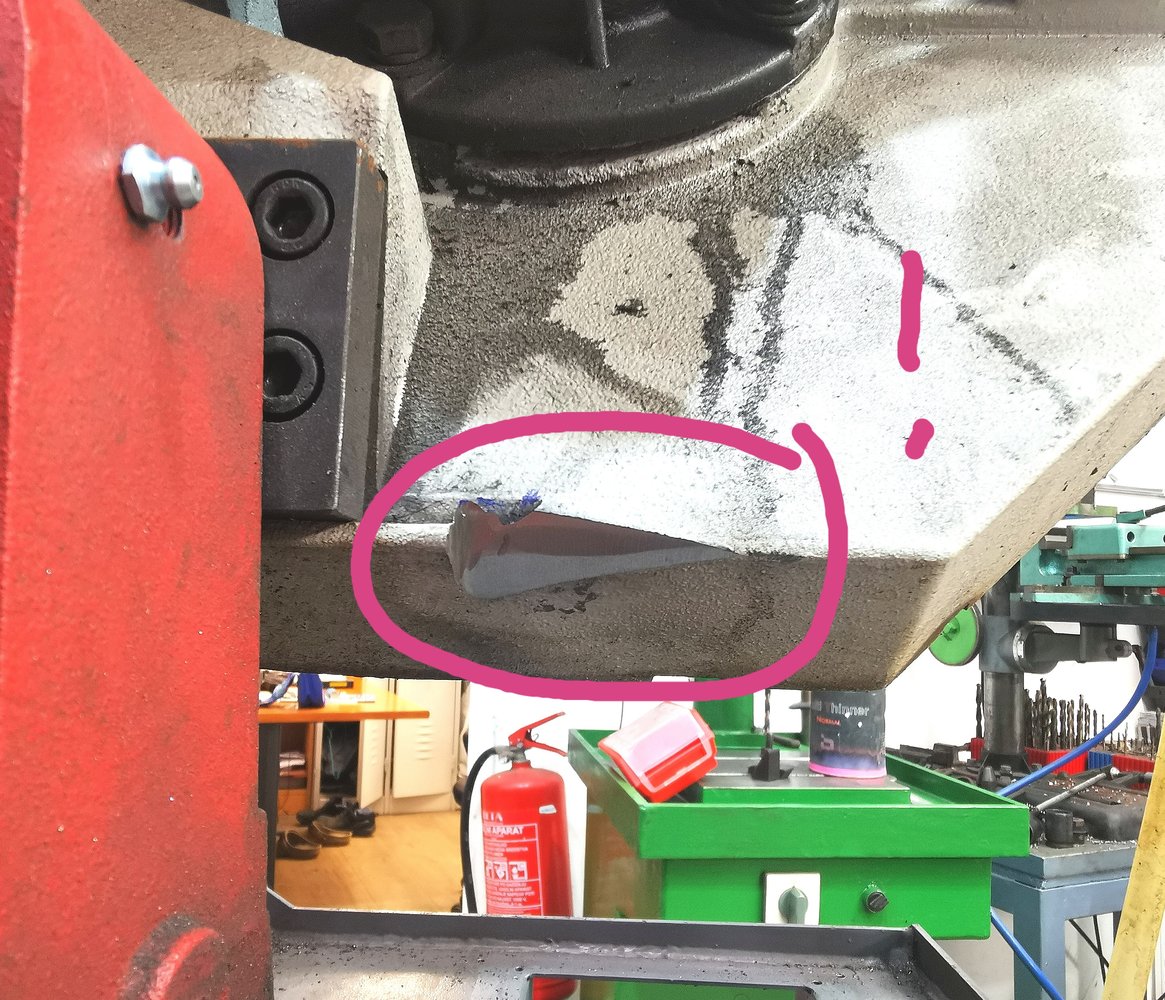

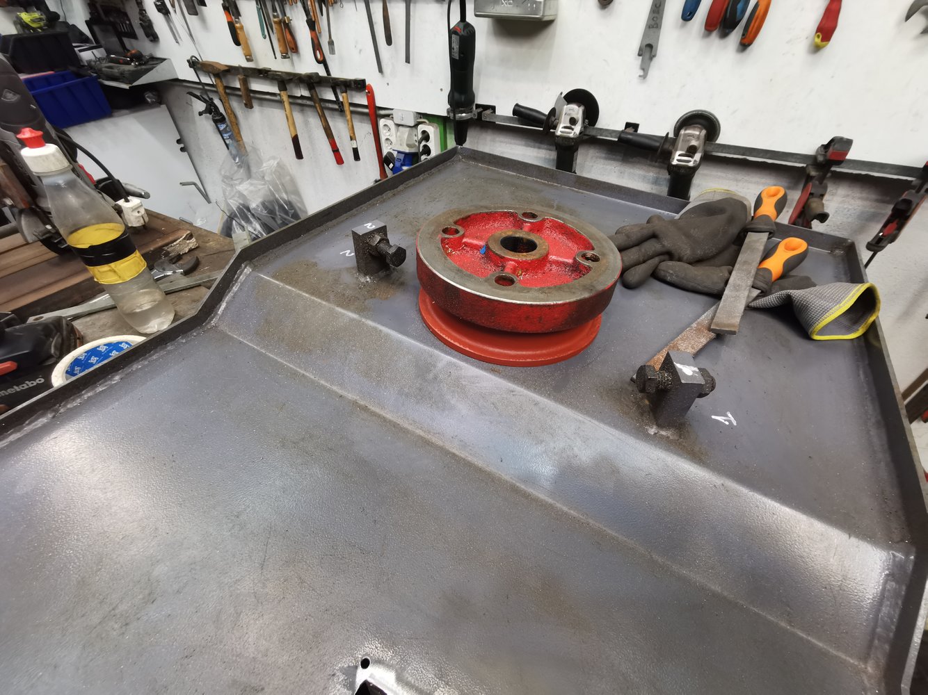

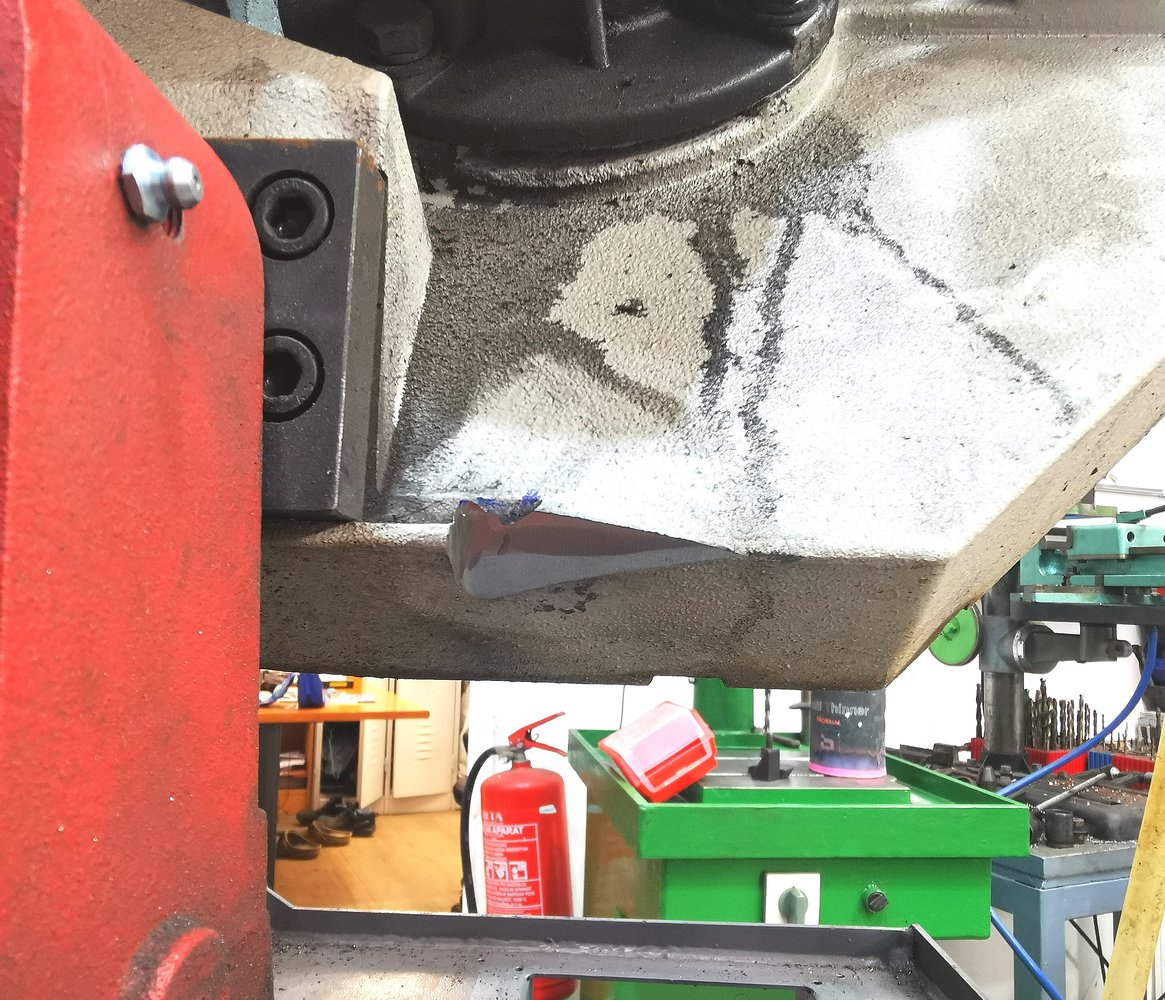

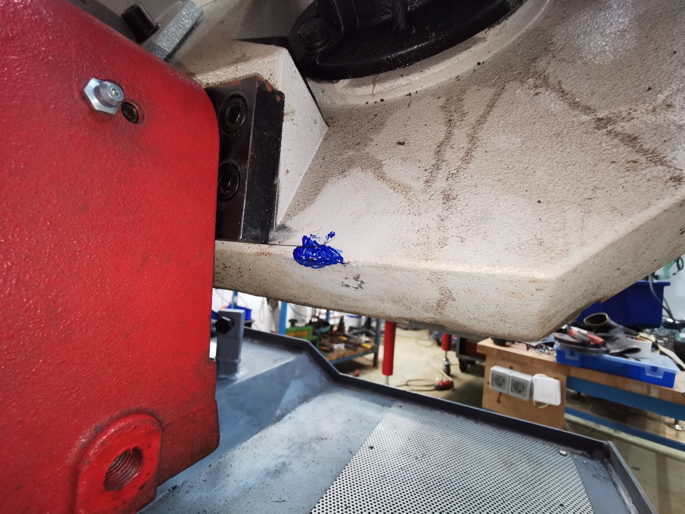

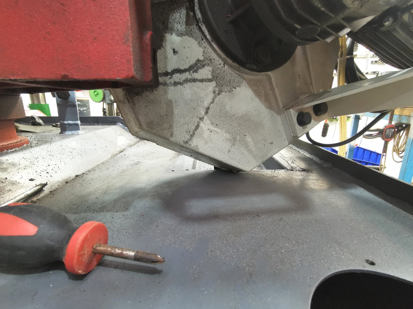

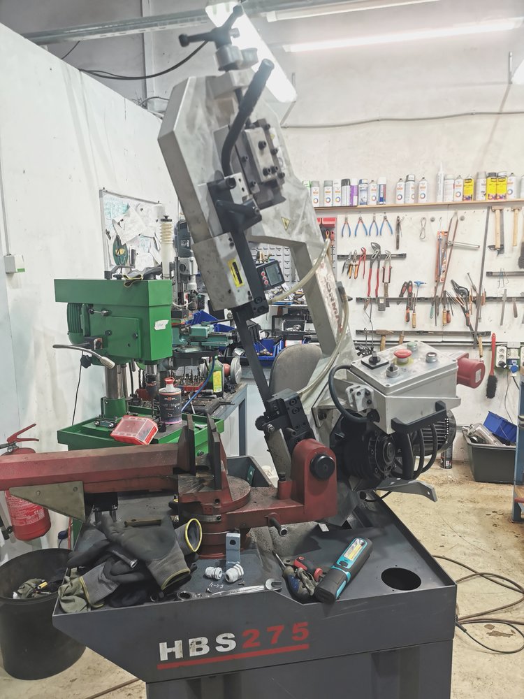

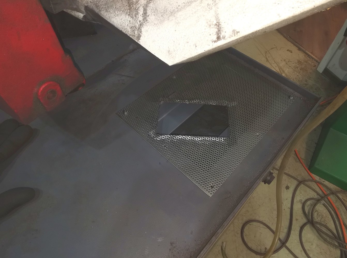

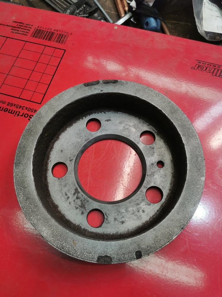

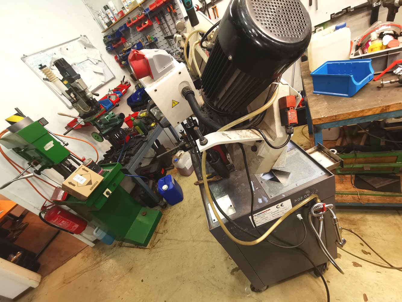

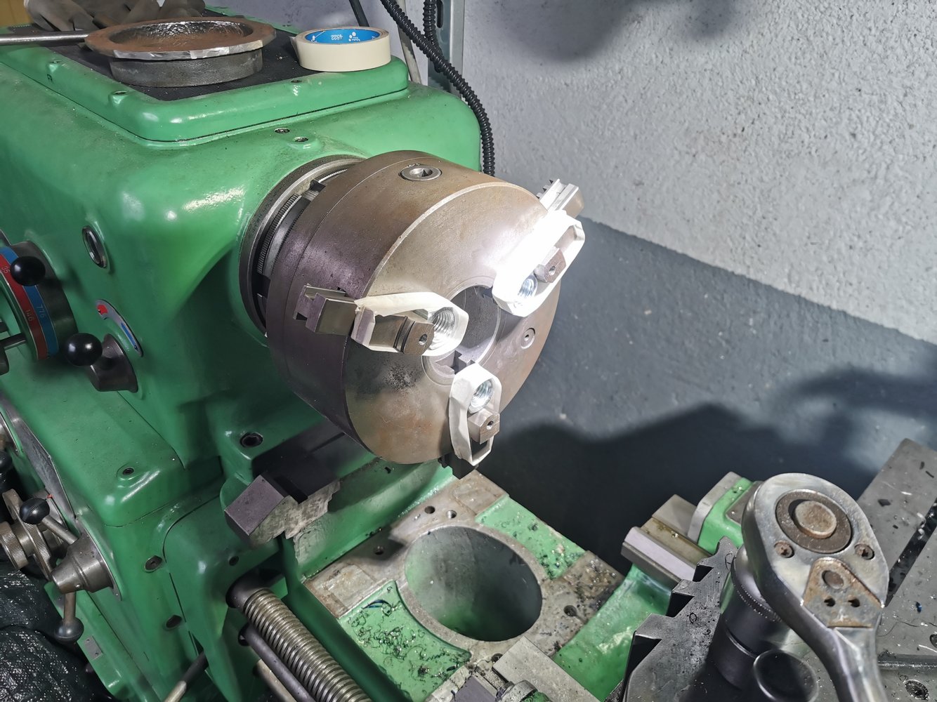

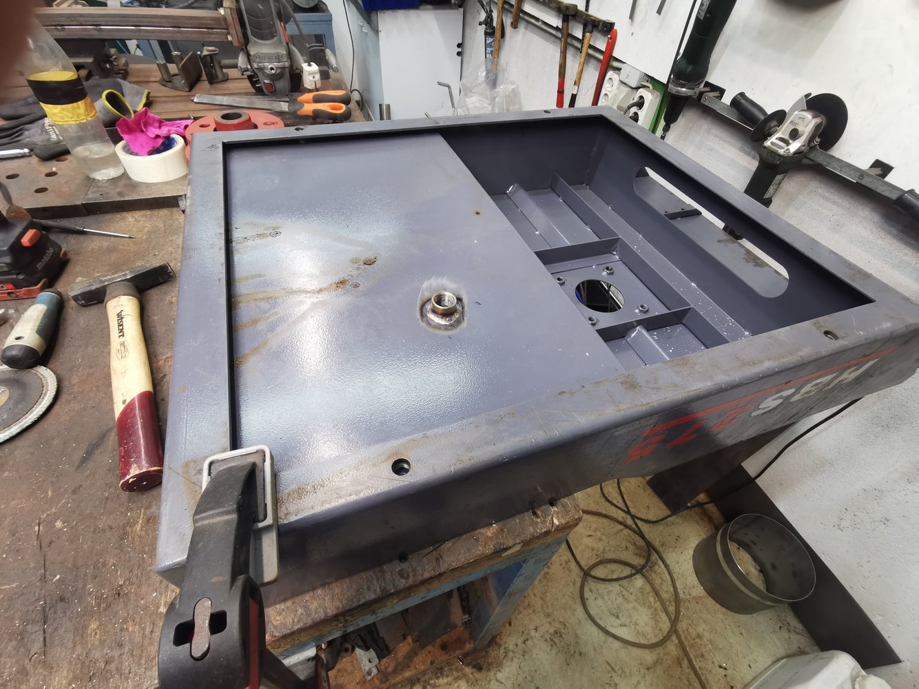

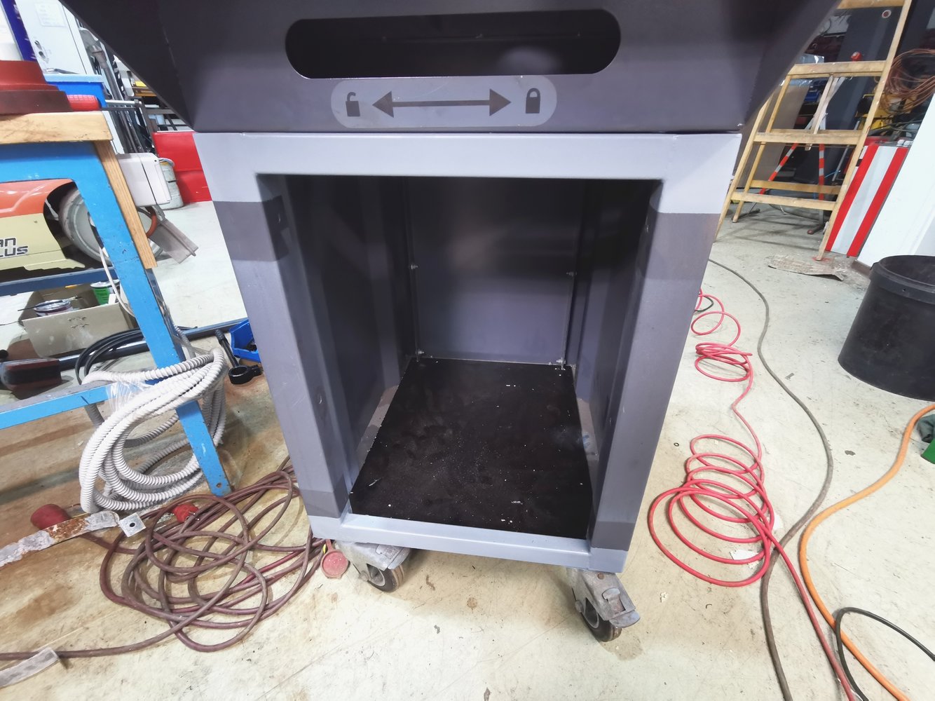

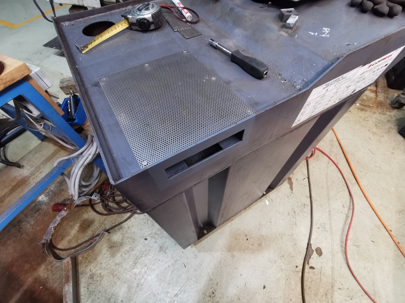

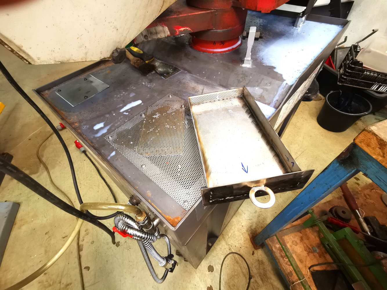

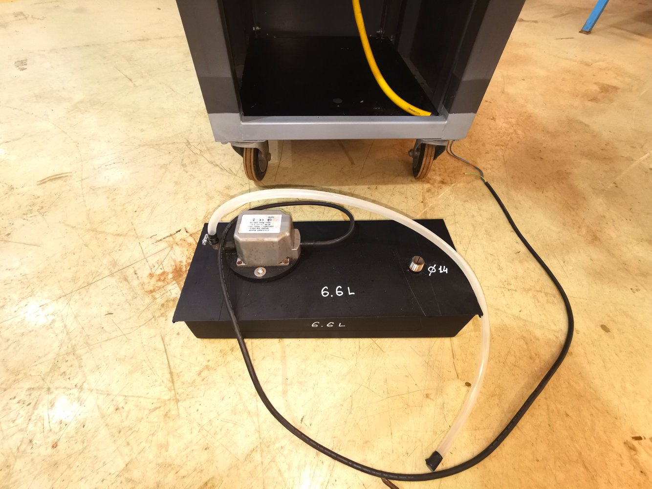

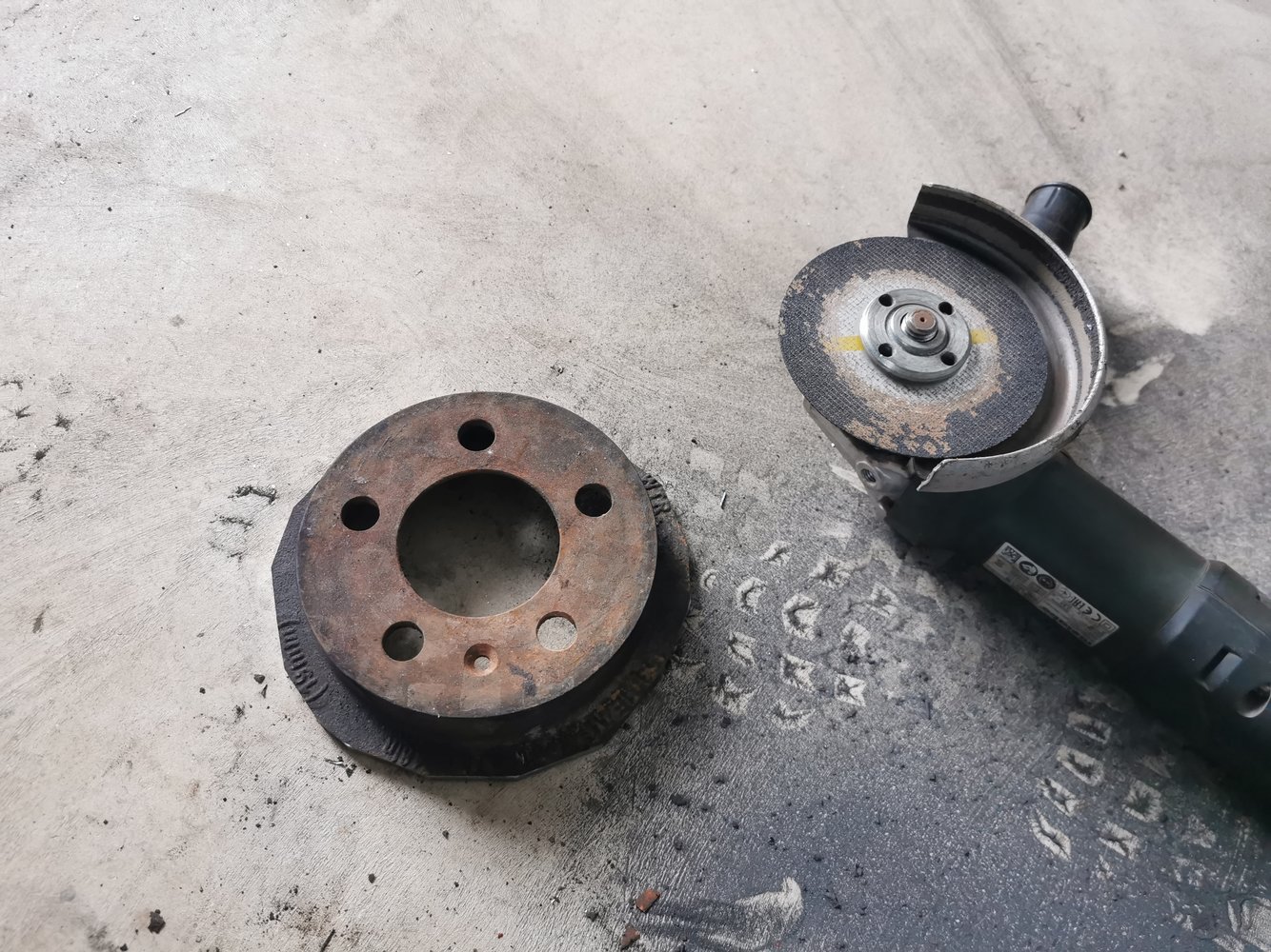

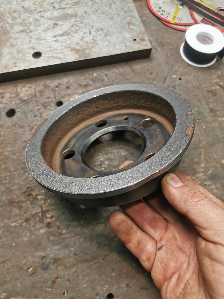

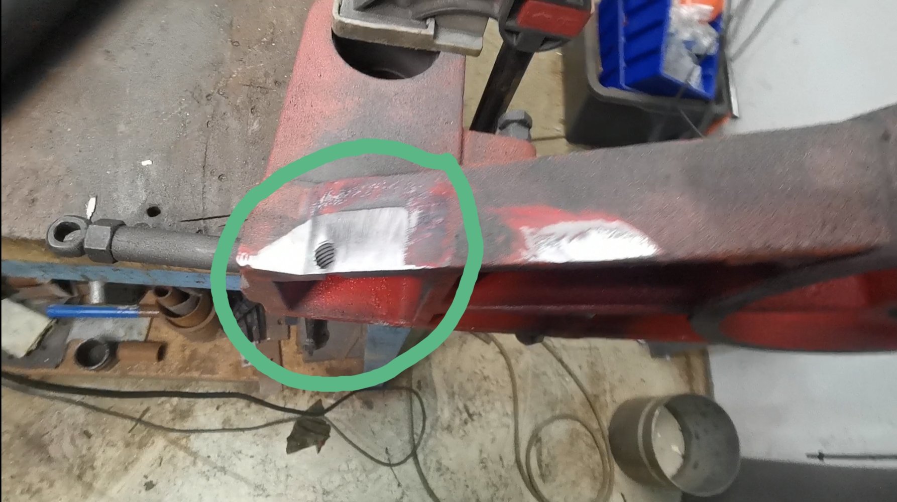

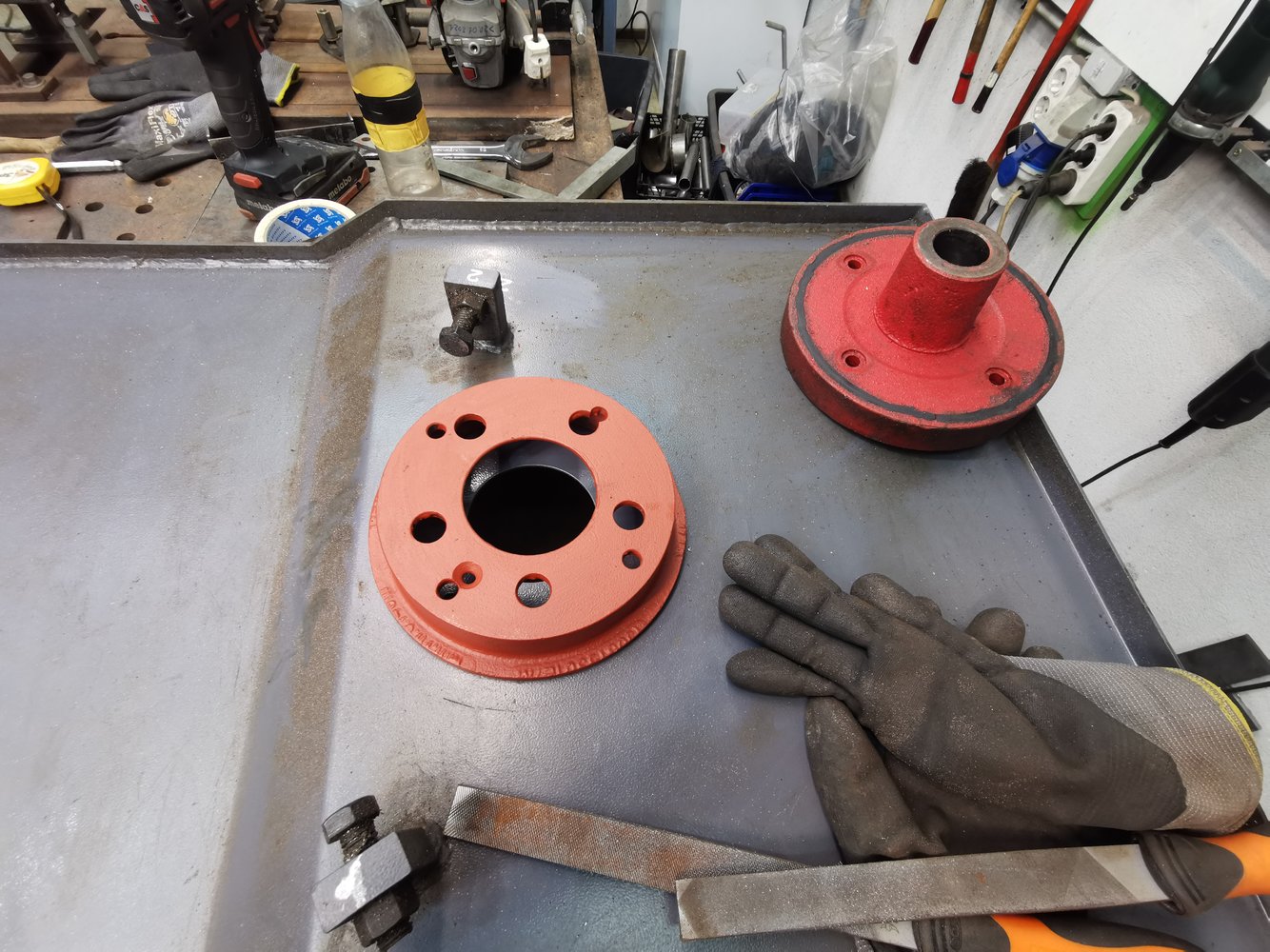

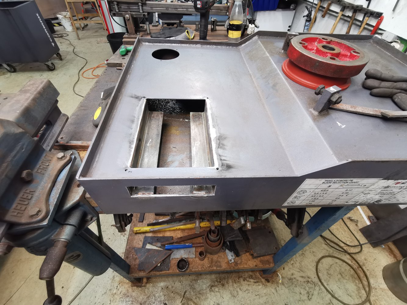

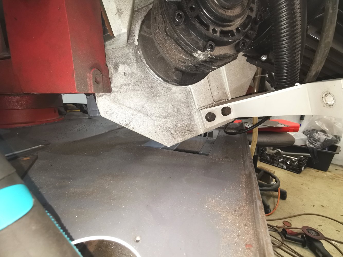

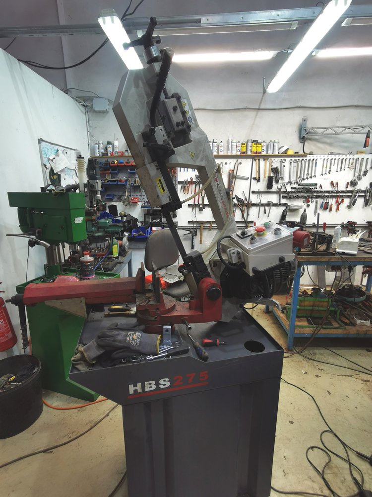

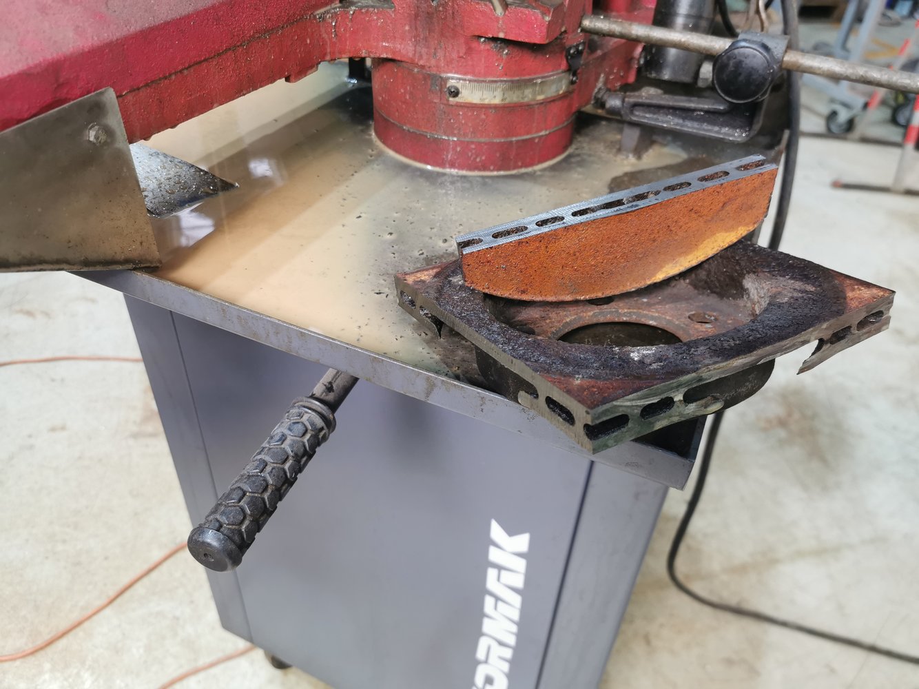

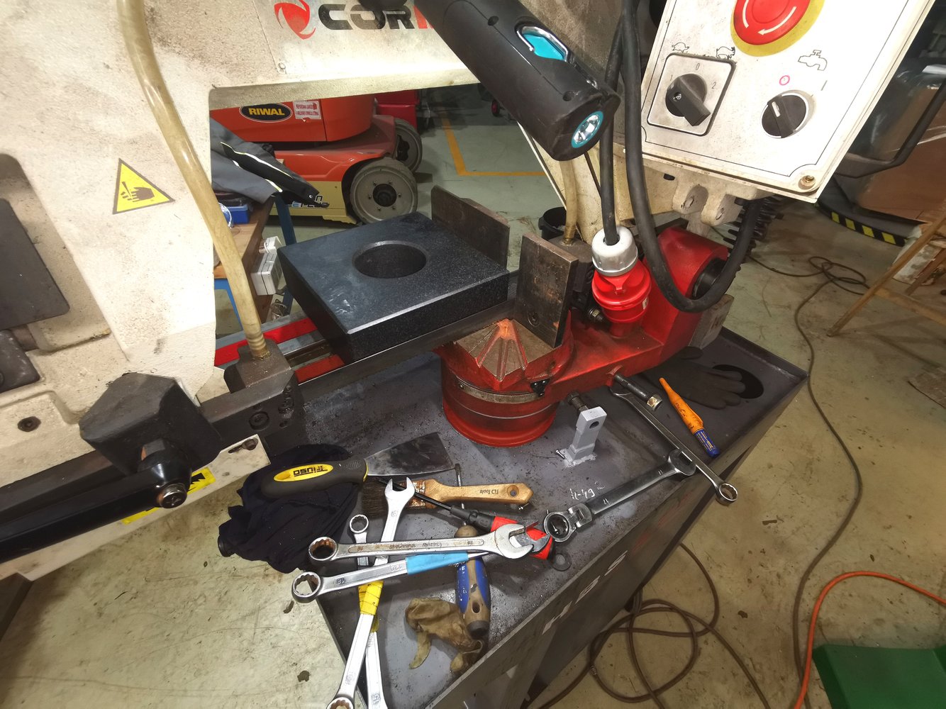

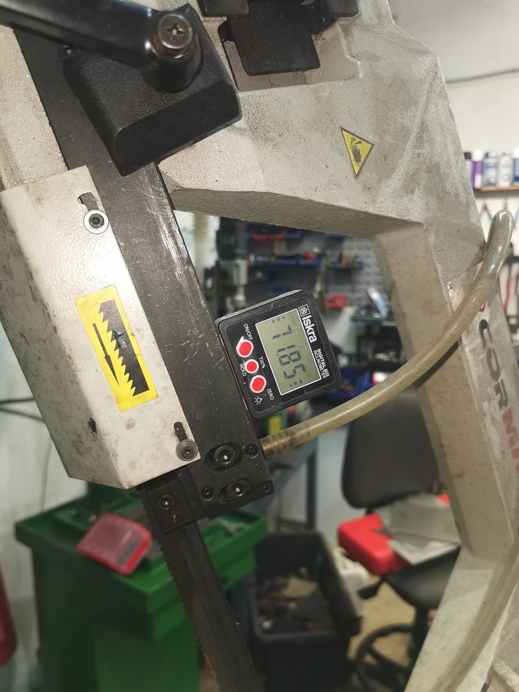

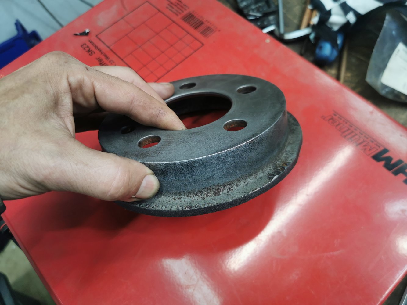

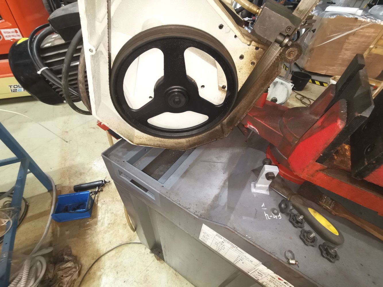

I took some measurements, and there is a good chance that I could get by with a spacer ring to give the saw blade a vertical position. Luckily, I found an old brake rotor and a lathe in my scrap pile. You may have to saw off the protrusion into which the bolt is screwed in to limit the lift of the saw itself, but the threads in the cast iron body should be sufficient. Or I'll make a different locking mechanism. There are a couple more ideas (I’m not happy with the factory design), and what needs to be redone. The conversion is reversible. Basically the saw works horizontally.
