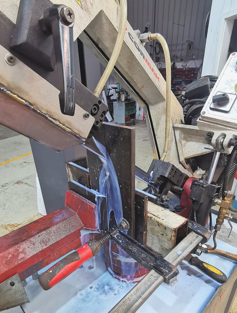

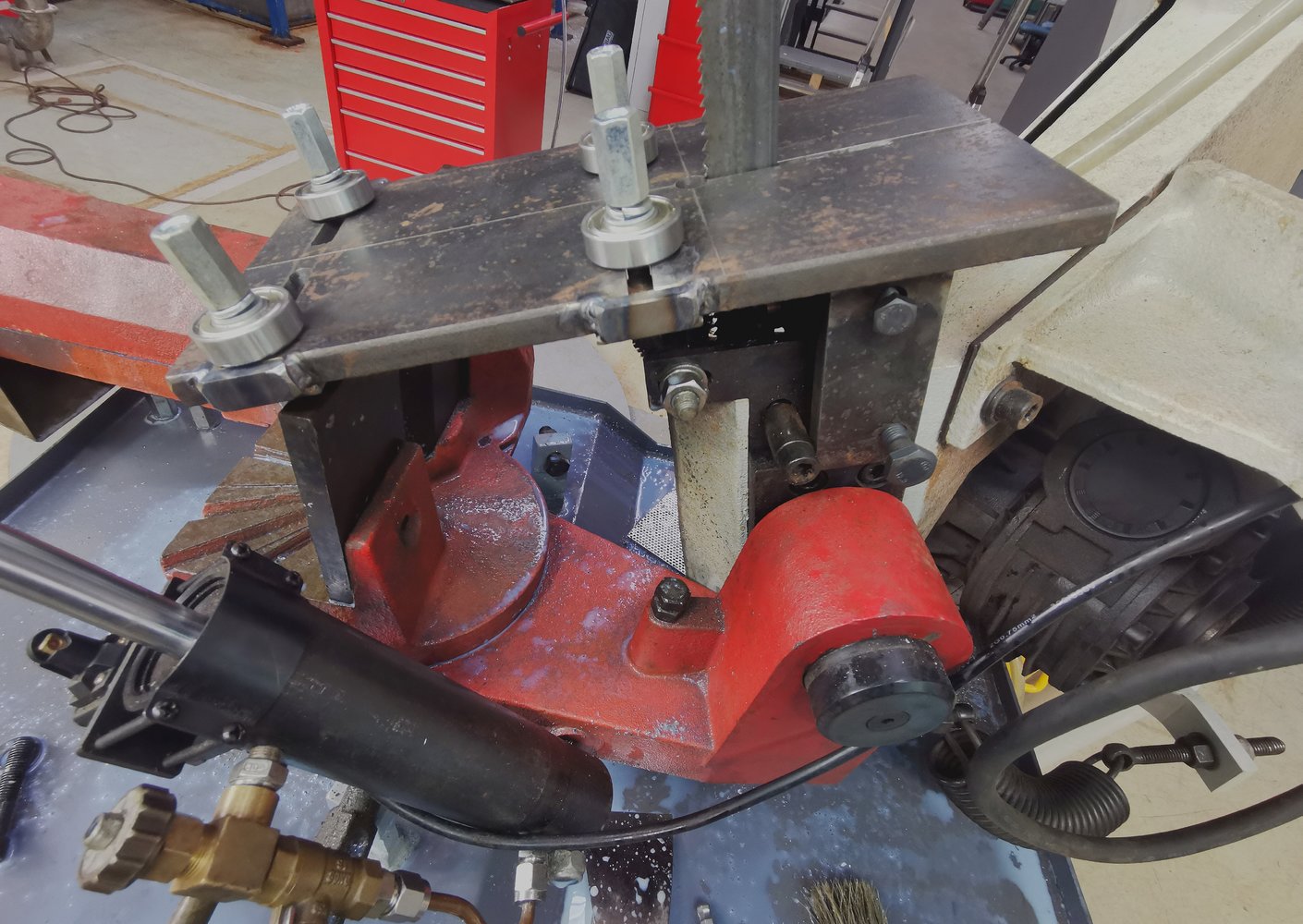

The coolant pump turned out to be not sealed where possible. The coolant tank will have to be made from scratch. The lid must be placed inside the tank, then all leaks will flow into the tank.

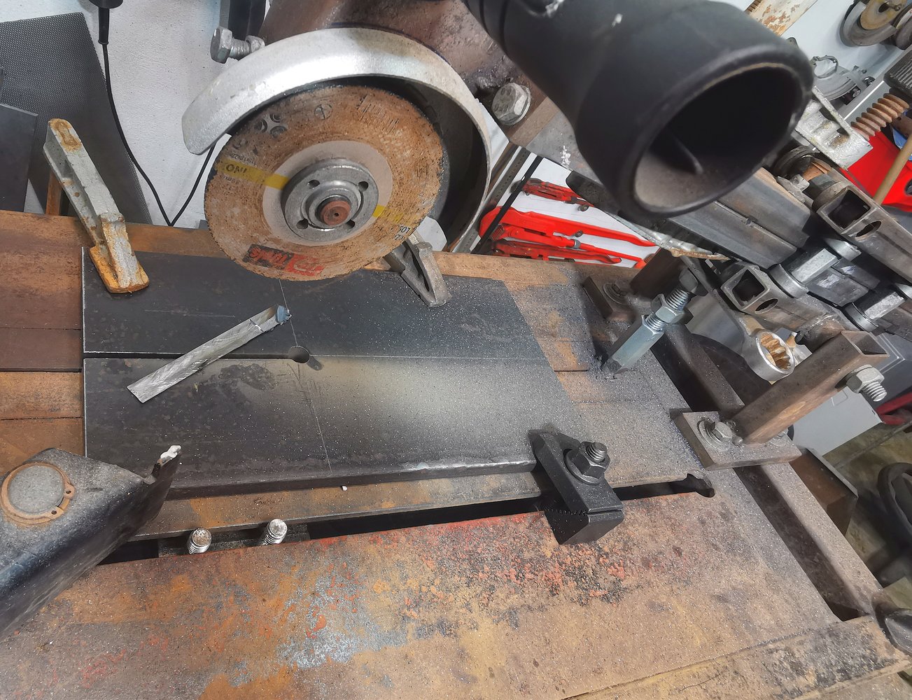

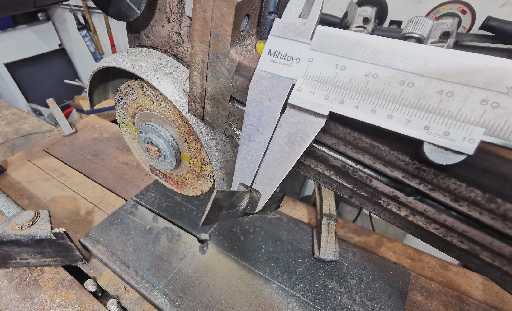

I started making a table, made a cut at maximum settings, feeding the strip downwards, pressing it with my hand on the first 3 cm of the cut.

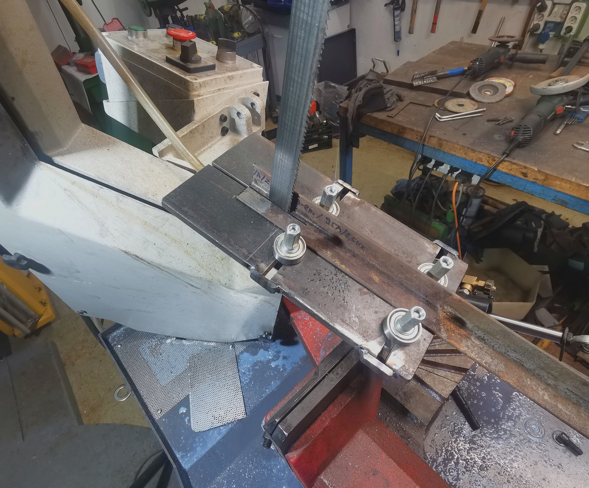

The shower head works as intended. The outer row of holes is sealed with silicone sealant. It washes away the shavings where I need them.
![IMG_20231027_144857_edit_432057606067404.jpg IMG_20231027_144857_edit_432057606067404.jpg](https://www.mig-welding.co.uk/forum/data/attachments/419/419167-121ff6ed13605fcf32152b5542cd396c.jpg)
