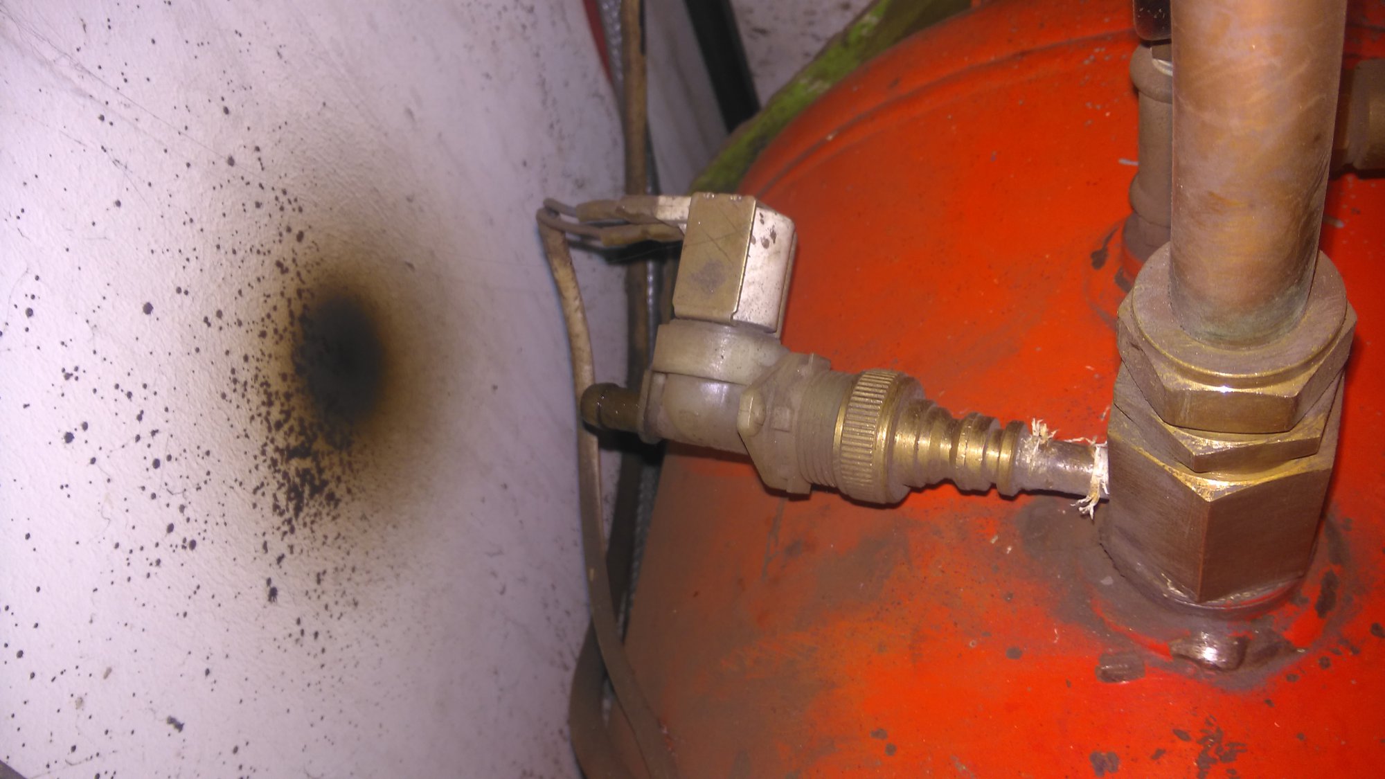

I added a soleniod valve to mine, in the feed line from the pump to the tank before the one way valve. The solenoid is on a timer connected to the motor so that the solenoid is opened for 4 seconds each time the motor starts .
This lets the motor get to speed quickly and pumps through the solenoid until 4 seconds is up. Been working fine for over 7 years so far,,
