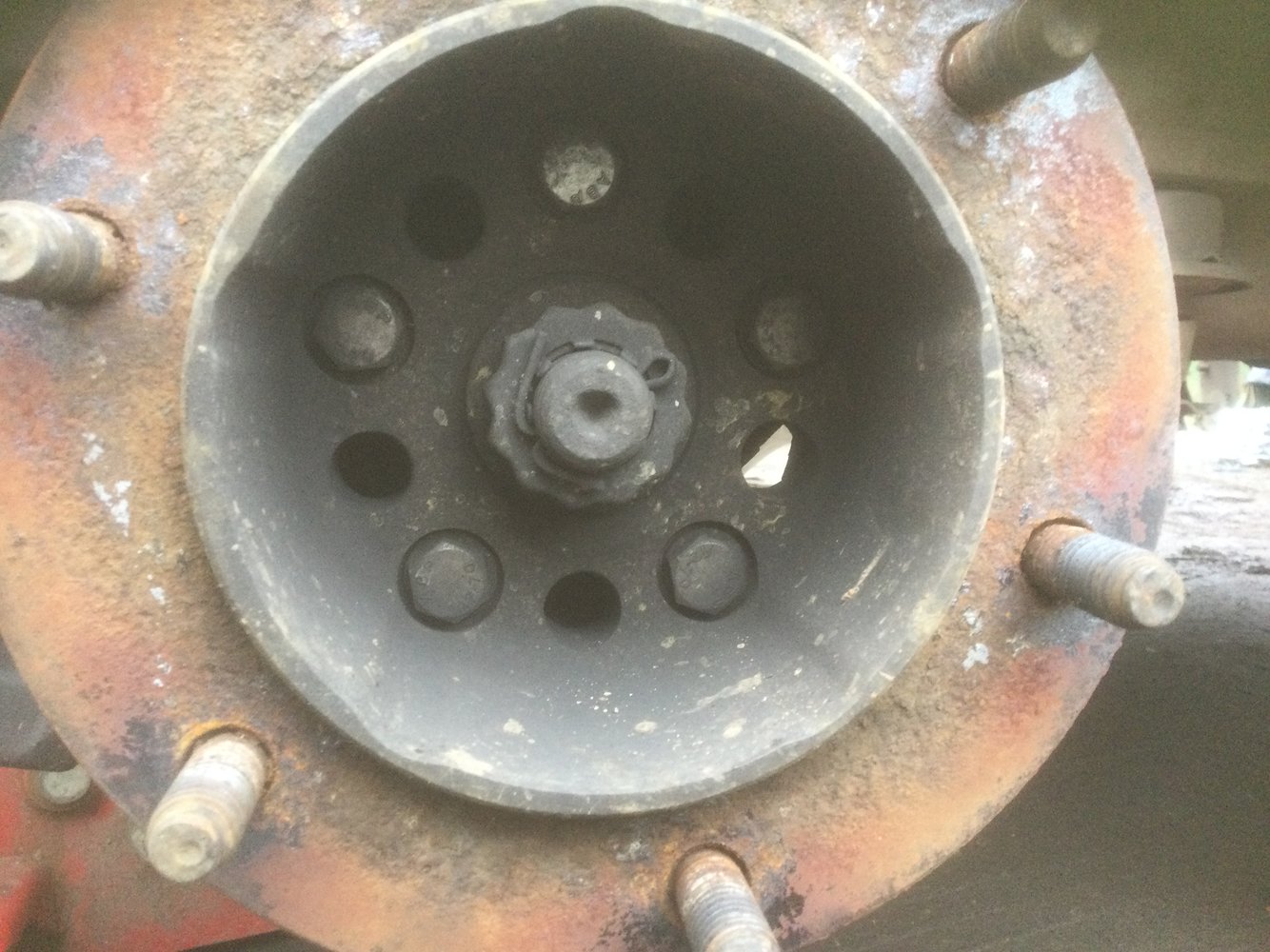

Odd title I know, but I had to take a pair off the other day to do disks on a transit.
That’s the third one I’ve done. I usually knock them out from behind with a socket that fits perfectly.
Every time I think I’ll make up the right tool for next time….. and forget or never get round to it.
Yet again, I forgot to measure the bolt pattern of the hub bolts to cut the tool out

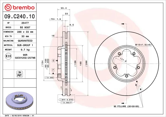

So. Does anyone have one still in the bin they’d be good enough to measure please? Or even better the actual tool they could measure/ take a good pic of. All the tool is, is a flat plate with a threaded boss in the middle for a grease filled power screw like you get in puller kits.
Thanks
