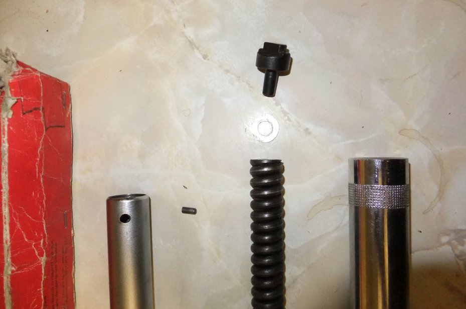

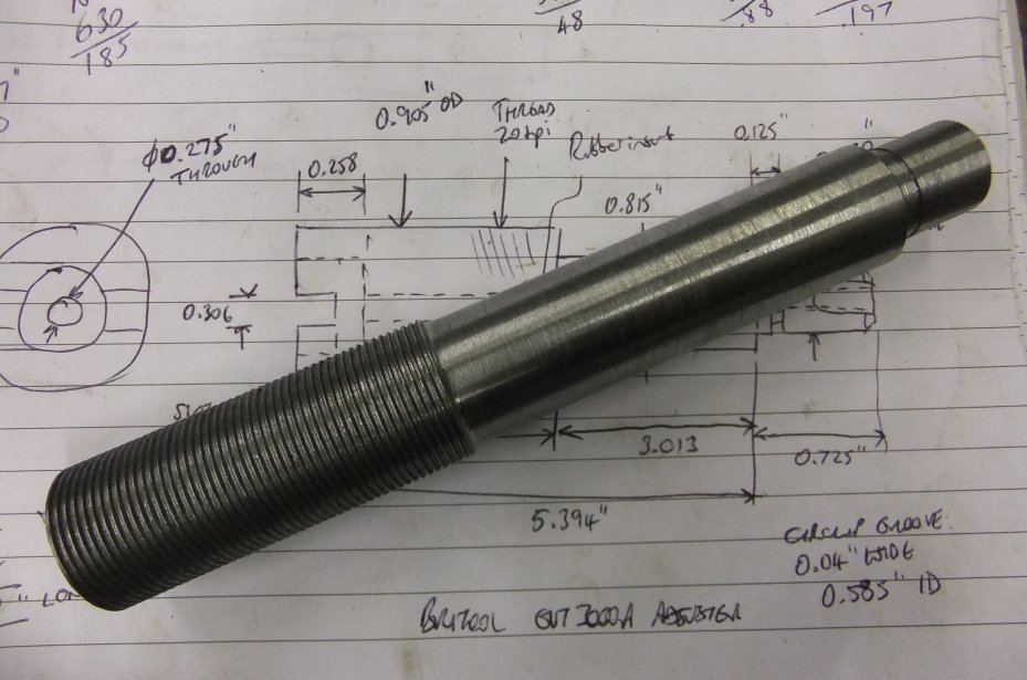

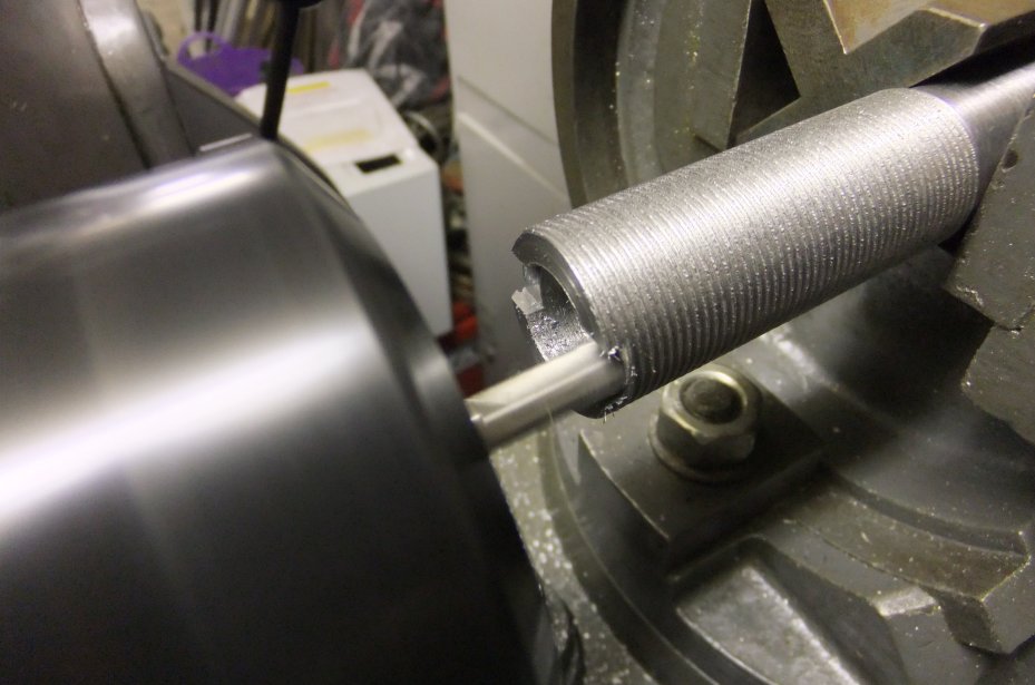

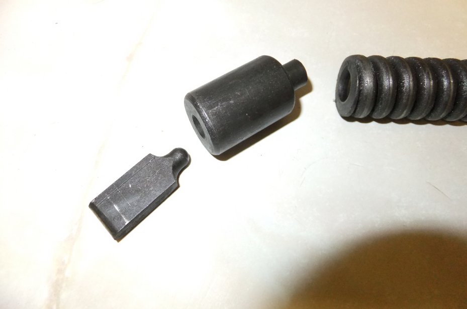

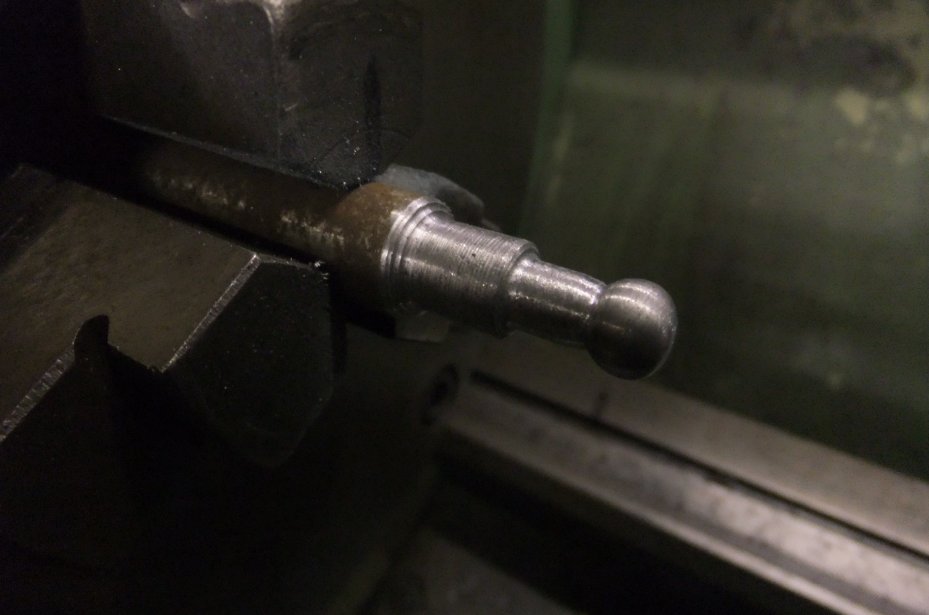

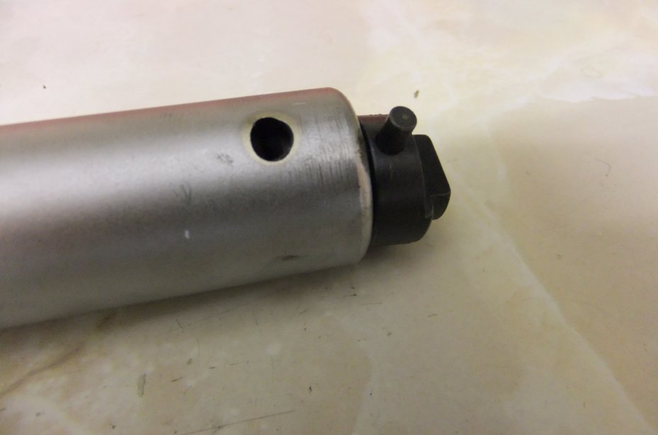

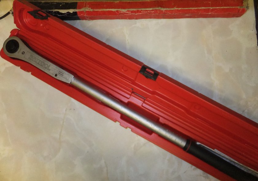

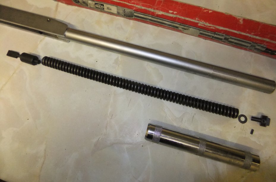

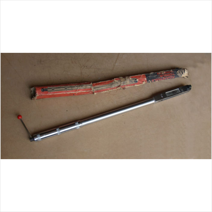

...or one from the same series... the type with the red knob you pull out and twirl to adjust? Not the later type with the plastic handle, this one has a chromed steel one with knurled bands.
I have had one in bits for some time now because an internal part broke... I came up with the idea of turning a new part but when I extracted the wrench from its place of repose (in the loft ) I found that the cluster of bits that were with it, are no longer with it, so rather than scrap a potentially useful tool I'd like to have a crack at replacing the parts, if only I can identify what they look like, how big they are and what they're made from
Needless to say, Britool themselves no longer exist (that I can find) and anyway, what's the point of owning a lathe and not using it?
And yes, I have looked under the loft insulation...
