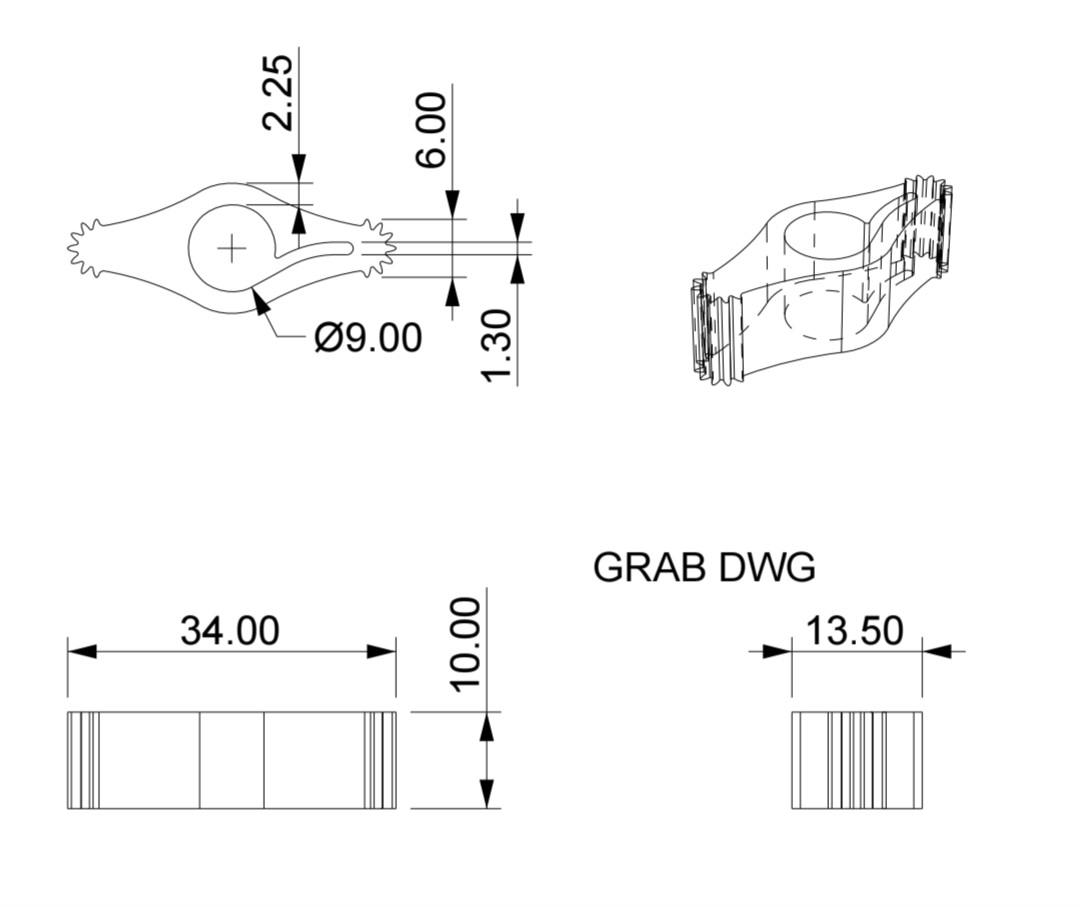

I agree!That detail will be lost on most laser cutters, its just too thick. That narrow slot in particular will turn out wierd. Rule of thumb is holes should never be less than 0.5x material thickness - ideally 1x.
You'd get away with that shape in 5mm in N2 cutting, but 10mm O2 cutting no way.
Yeah waterjet might be a good option. Wire eroder would be even better for accuracy... Obviously cost goes way up thoughI agree!

I would have thought laser cutting was accurate enough for the job being it's the bees knees of cnc cutting, guess I'll have to hope my 3d printed test piece is good enough to simulate a metal version!

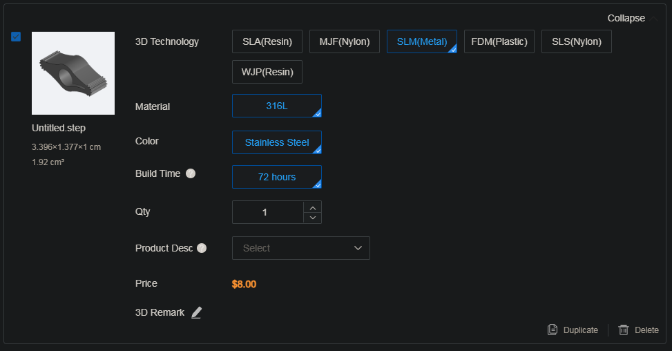

You can 3D print in stainless now. That might be a possibility.I would have thought laser cutting was accurate enough for the job being it's the bees knees of cnc cutting, guess I'll have to hope my 3d printed test piece is good enough to simulate a metal version!

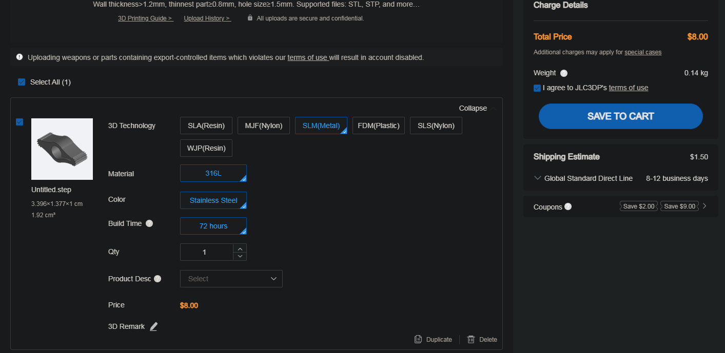

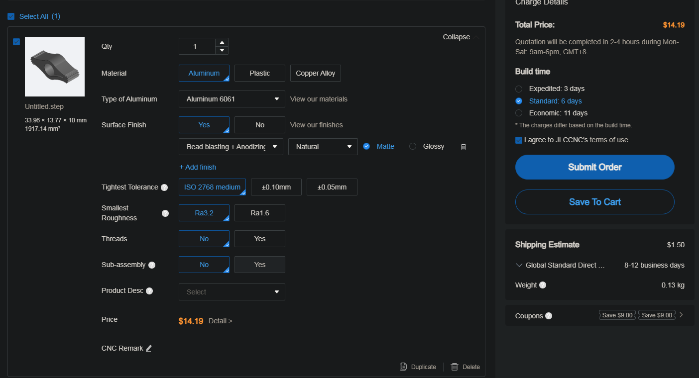

Yea jlc3dp is £6 for a piece in 316 and there's a new user coupon of £5 off, I'll just add it onto my upcoming cnc quoteYou can 3D print in stainless now. That might be a possibility.
