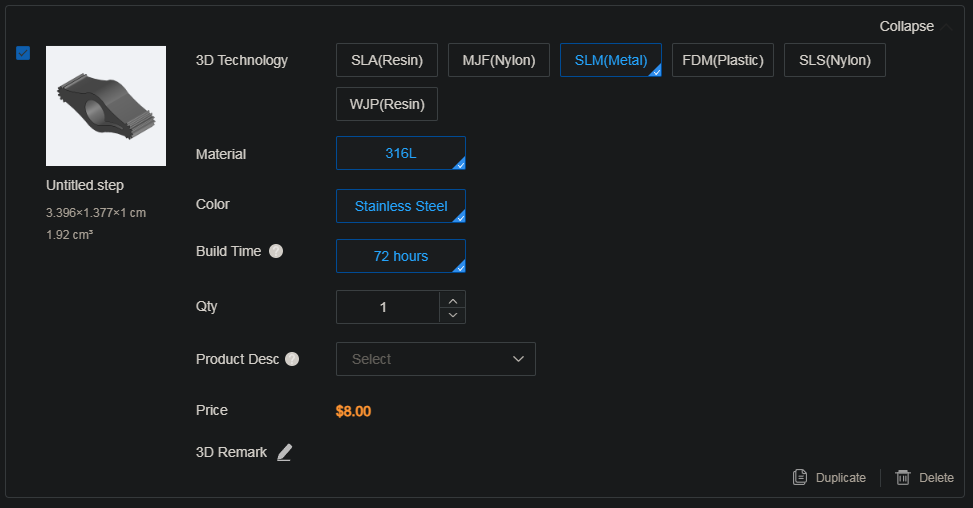

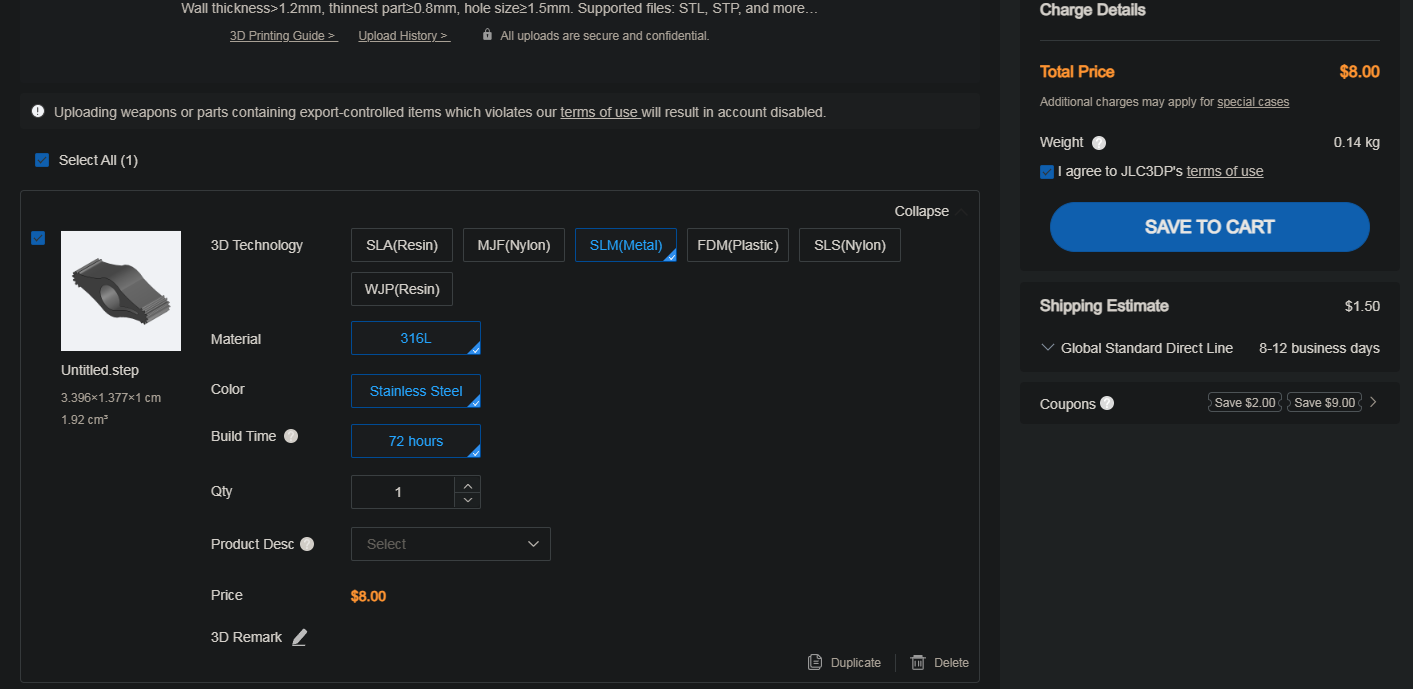

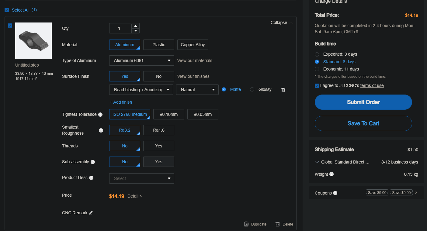

Yea it's £7 a part so gonna do that and hopefully tap a thread in some of them, it's not gear teeth just a random profile I created as it's designed as a rope grabI was curious so I quickly traced your drawing and made a 3d model 10mm thick and stuck it in JLCCNC for a quote. Surprisingly low indeed.
those aren't properly involute teeth profiles of course since I just did a more or less freehand trace but for the 3d sintered process that doesn't matter and for the machined one its just gives an idea. Shame they don't machine in steel.
I image you wont have to look too hard to find online EDM services too and it'd be a cinch for them to do that part.

Any laser-cut item will have a heat affected zone, which will complicate tapping. Do some research on tapping a sintered part.
I don't like the sound of a brittle failure on a rope grab...
