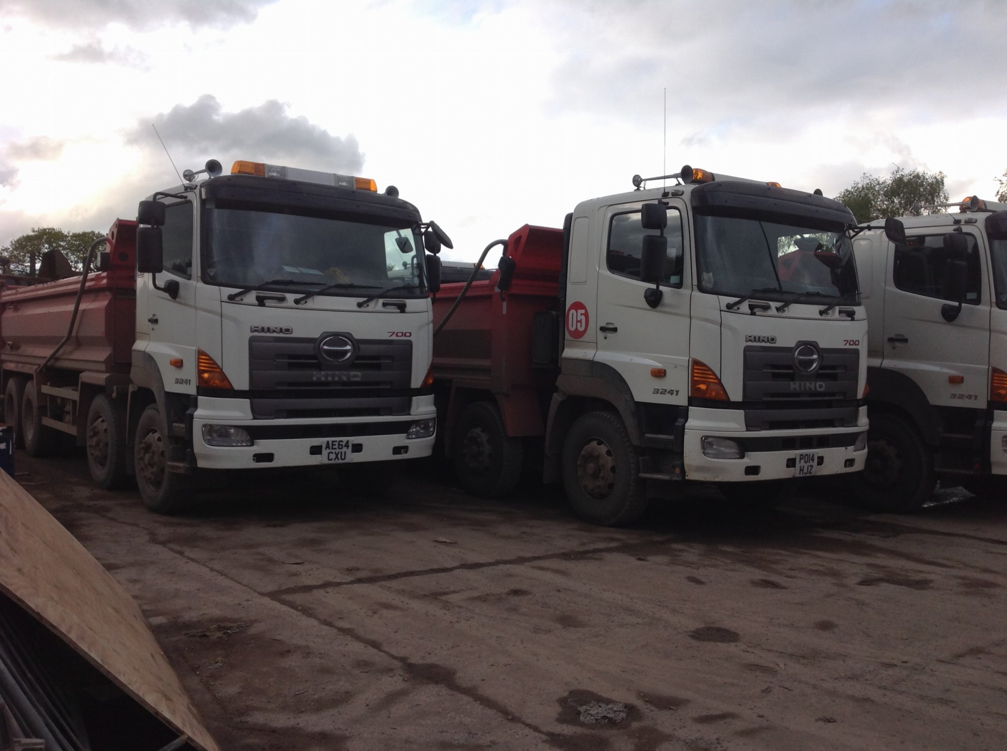

Ive just looked up the auction details, and they were indeed listed as Hino 700 mirrors.
