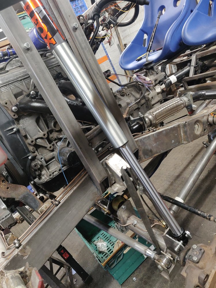

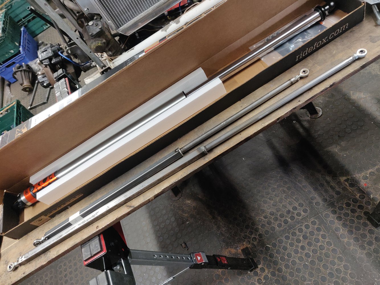

I've finally received my Fox 2.0 air shocks and started fitting to my buggy.
I've done some basic reading on how they work but still have a lot to learn about them so this is just the start of the journey.
I had hoped I could depressurise them so that I can cycle the suspension and check nothing interferes (I have 18" travel so things are tight!). But now I'm reading deeper into the subject I'm hearing that I shouldn't depressurise or do anything myself because the oil can cavitate and needs to be factory bled.
Can I at least slightly depressurise them to get the car to sit at ride height so I can continue working on the build?
I bought them from the official UK dealer so I should be able to get official support.
I borrowed nitrogen filling equipment as I thought I could tune the shocks myself.
