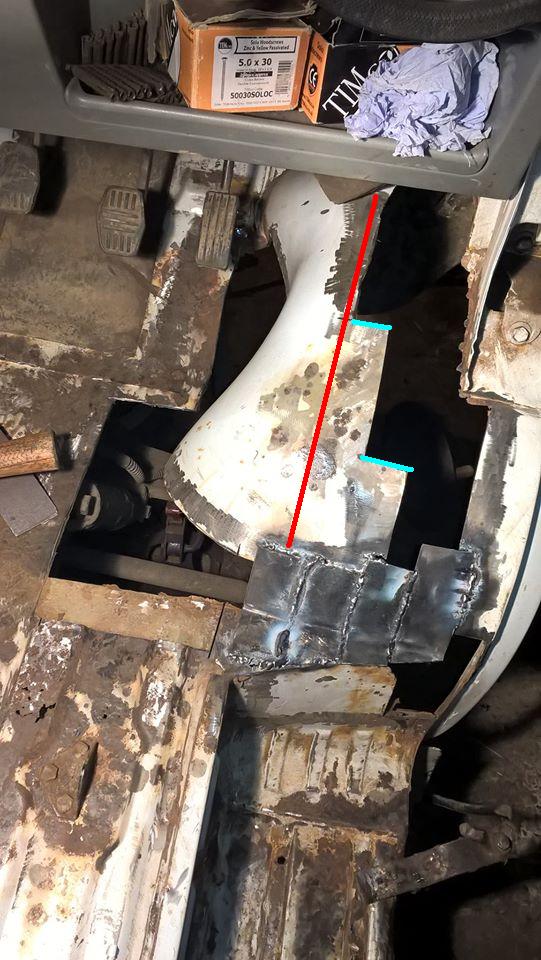

so have a bit of an emergency job putting a floor back in a van.. factory floor is roughly 1-1.5 (more on the 1 side) throughout, I am plating it up with 2mm sheeting as I dont keep 1mm in stock (who uses 1mm?!)
now both my leccy welders are broken, as per another thread, so I back to old faithful, 200amp petrol 2stroke 1 lunger,, I only have the choice of 30 or 50amps, and obviously I cant be using anything other than 1.6 rods(6013) 30 is no good so I am using 50, which feels about 45-48 to me, a little high but not too awful.
my problem, as you can imagine, is blowing holes in the damn thin factory sheet!!!! the 2mm I am having no issues with, I can keep it from blowing and join it up nice, but the 1mm is a rear struggle, I can barely get 1/2" run before the head build up puts holes in it.. its very slow going.
the old bloke with 40 years in the job said (if you can weld that with that, your doing better than most,)
my new super fancy (hopefully) inverter arc&mig is on the way, so that will help no end, but until then.
any advice on ways to stop putting holes in it? I cant do negative welding on this machine as i'm fairly sure its AC, and dont have any ideas.
also, when I get the new machine I am assuming I need to go straight into mig, and I will be giving myself a very crash course, but what wire thickness, feed, amps should I be using for this kind of job?
I will be using gas with it. argon &C02 iv been told.
