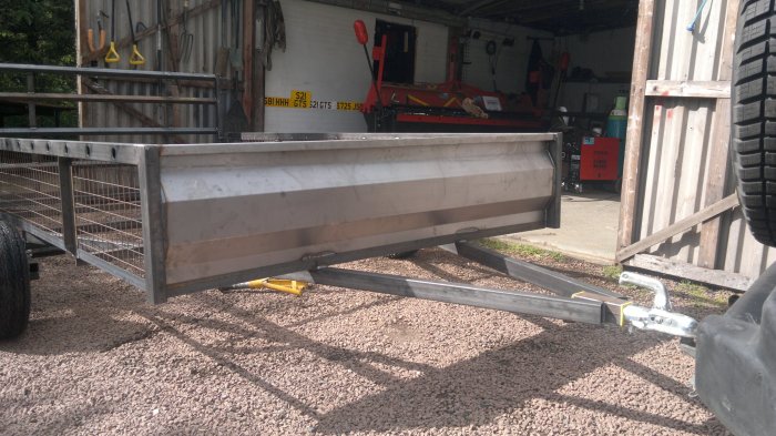

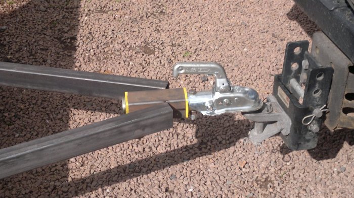

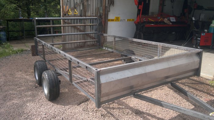

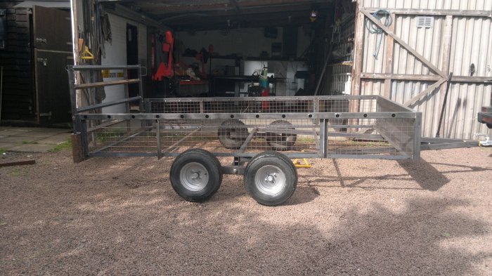

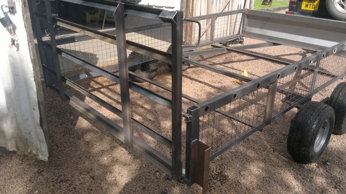

Finally got the trailer finished! All ready to get dropped off for galvanising tommorow morning.
Here are some pics of it completed - minus the floor obviously!
it is right on the 2.55M width limit allowed for trailers in the UK. I am also happy with the weight of it - can still lift it with 2 people fairly easily.

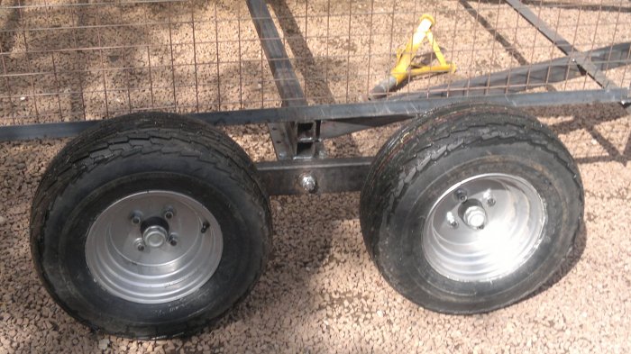

the suspension is a "walking beam" design; basically it allows the trailer to "float" along and the wheels move with the terrain. This type of suspension is typically found on Agricultural type trailers and ATV trailers.
