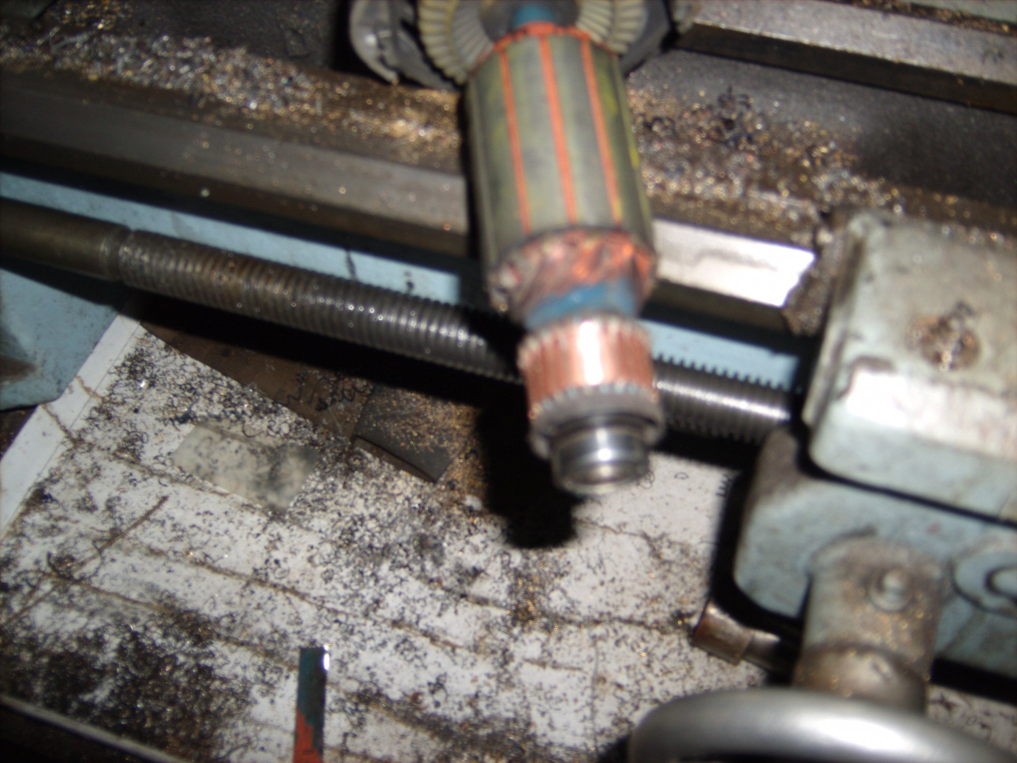

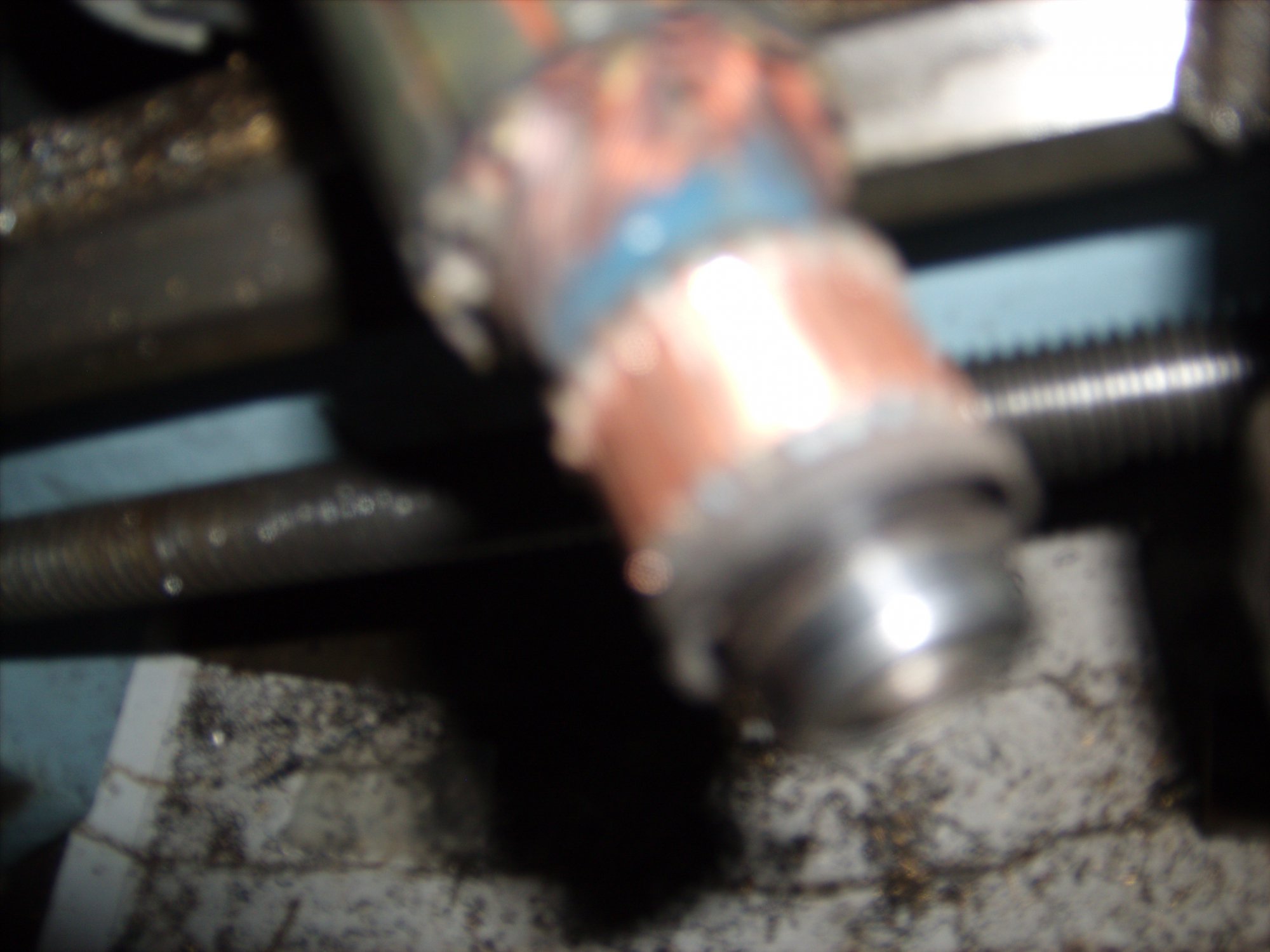

Remember that well Robotstar an old 5 Hp motor or larger finger all cramped up nicks where the you had not noticed you were griping the blade not the handle, then polish with the fiber glass stick.
If people use hacksaw blade remember to grind the set off the blade you only want to cut the insulation not the copper.
You need to get the cut so it cleans the gap leaving no remnants of the insulation on the sides of the cut, if left as wear takes place it breaks off damages brushes & increases wear a vicious circle.
CPC sell fiber glass pens for around 90p will do for light work not a quality item.

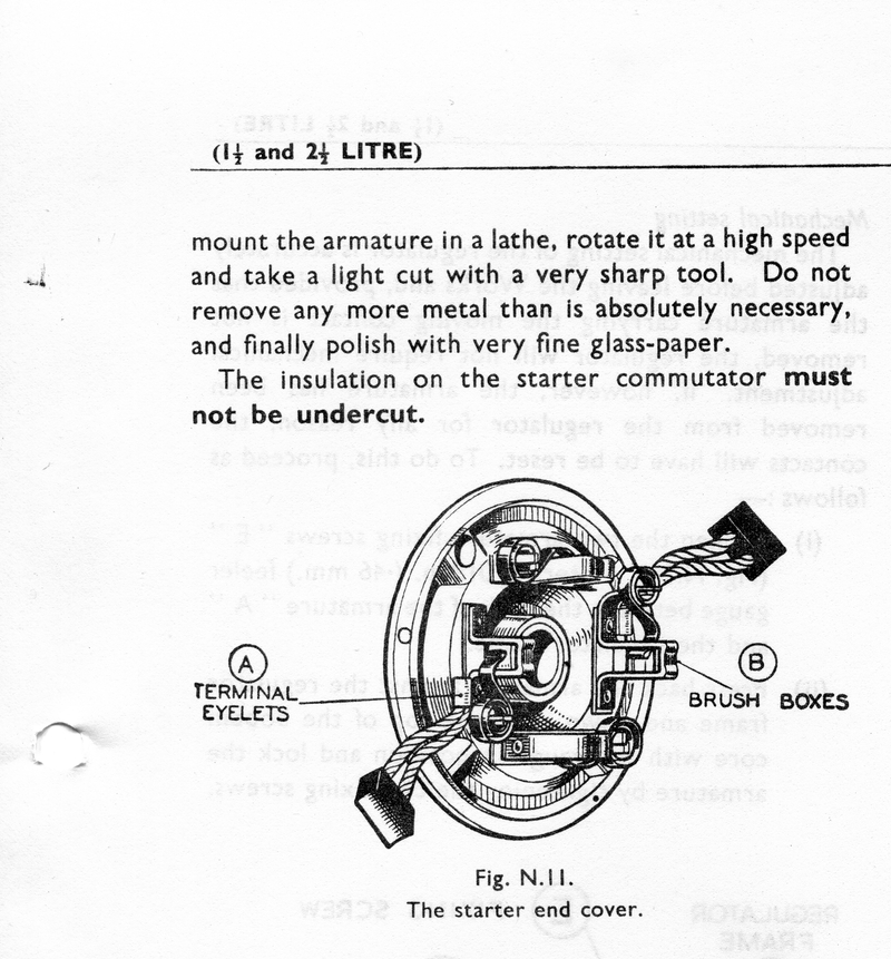

It is starters you don't undercut.
