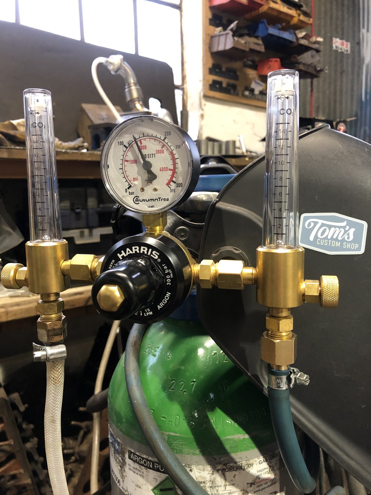

You’ve not got a problem then. Waste of gas going down the Hollywood route of huge ceramics and high gas flowsYes. Clean and shiny underneath.
On say an exhaust tube I block the end with tin foil etc and restric the flow to stop oxygen creeping back in if the flow is too low, after the initial purge.Once you’ve got the oxygen out of whatever you’re welding back the flow right down to a minimum
