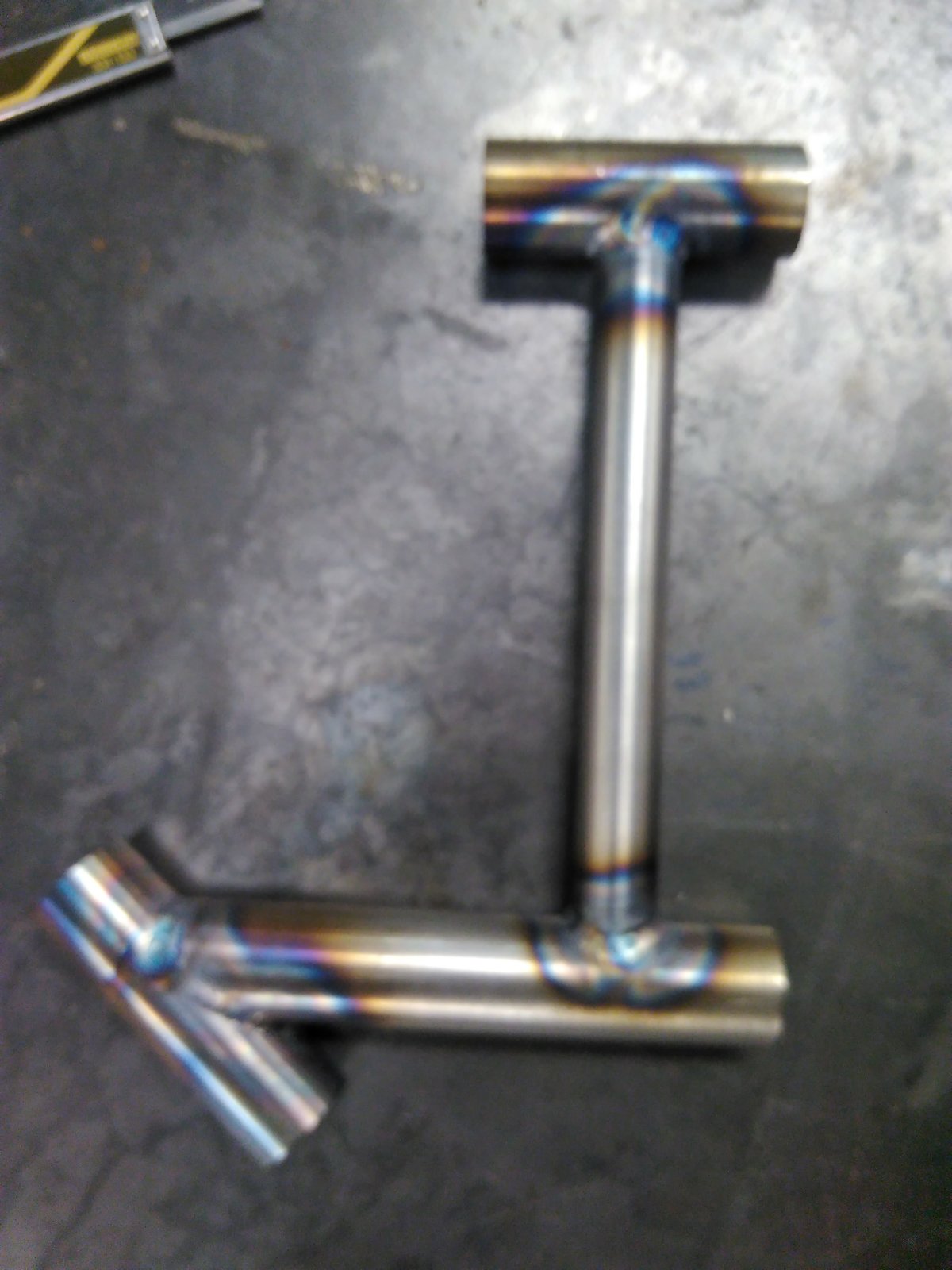

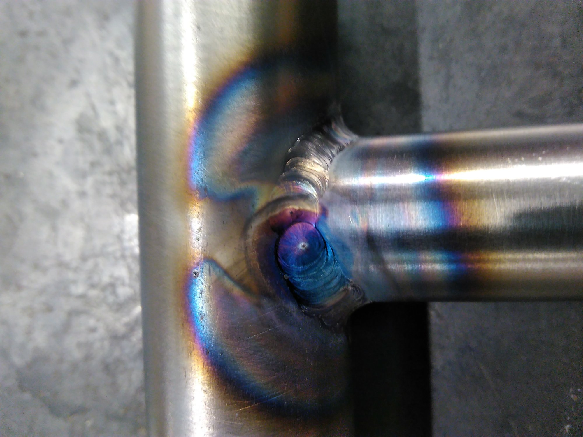

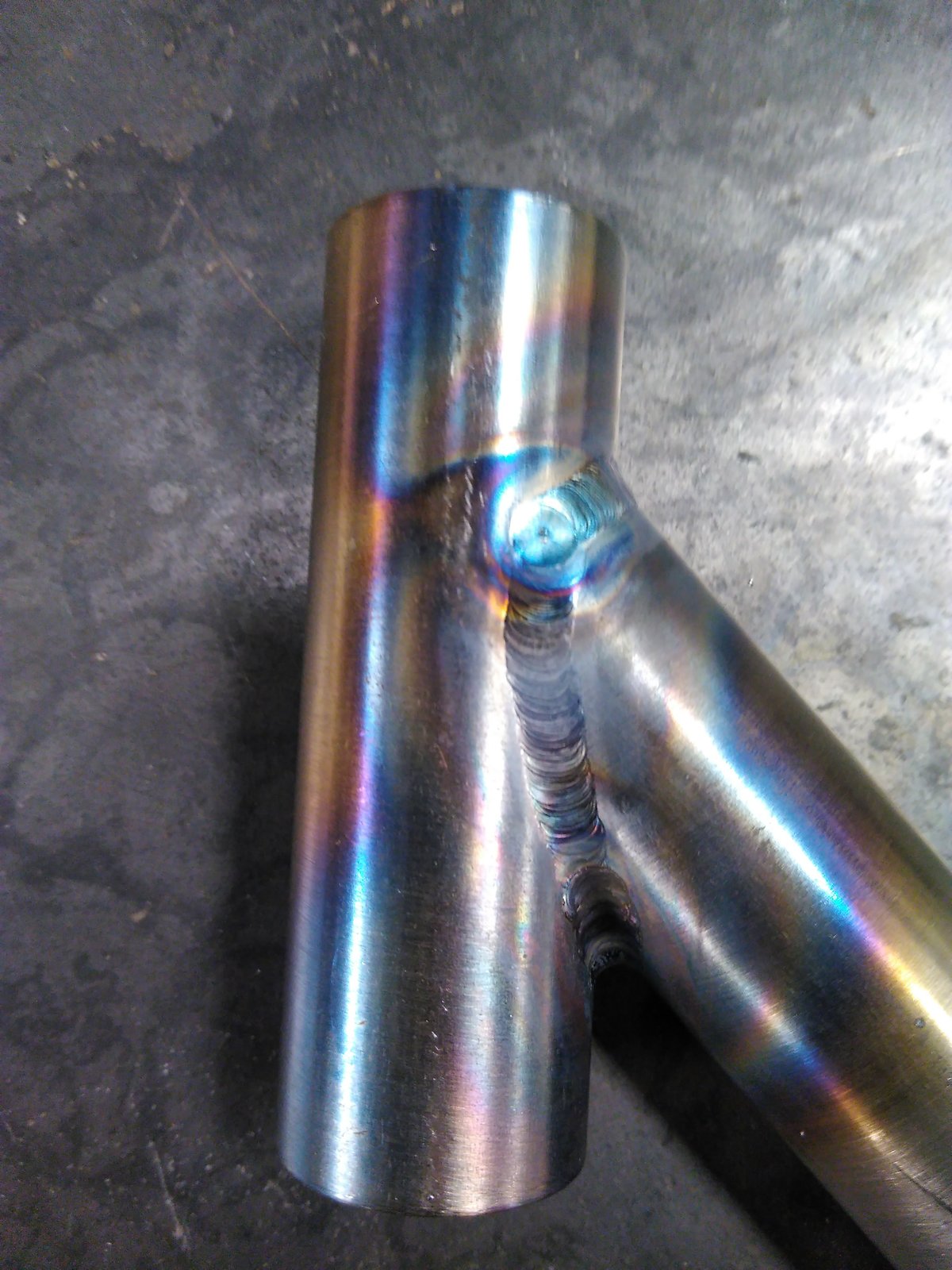

Does it have to be done in fixed position?It’s 4130, very nice to weld esp with A18. This was on the button. Not sure on if it specifies it in the regs, its all a bit vauge to be honest.
Seems silly almost. I'm guessing it's not too easy to turn an airframe over haha
Will be interested to see the differences between s2 and s6
0.5% Moly? Only come across it for pipework/boiler work.

I’ve just been through this. You will need to supply the samples as listed in BCAR A8-10, to an approved test centre.
Once you receive the test results these need to be sent to The CAA. They will then issue docs to say you are approved to weld on the grades you had tested.
If you think the test samples will not cover the joints, and or thickness. then samples of those also need to be tested.
I used Keighley labs in the end, @£65ish per sample.
I was going to use someone else but they wanted a ridiculous amount (£100s per sample).
