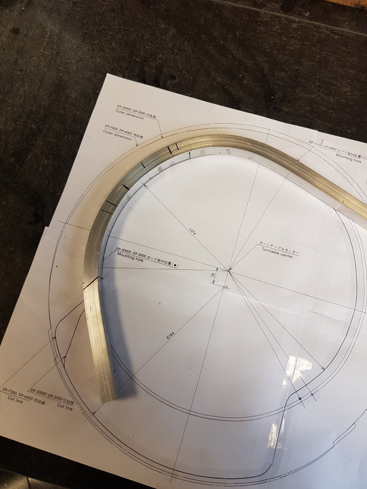

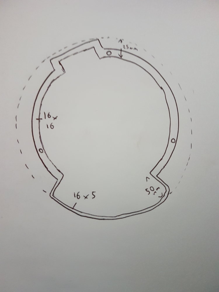

I am trying to make this shaped spacer.So do you need 1 or 2 rings made, (275mm internal and 330mm external ring)???

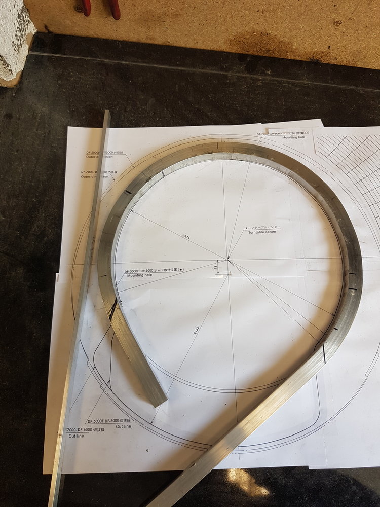

I was going to bend the 16x16mm circles then cut it into 2 sections. The front piece I was going to make from 16x5 flat bar.
Or, I could get it laser cut from plate, in which case it's basically 2 non concentric circles (dotted line) with an extra bit cut out the front
