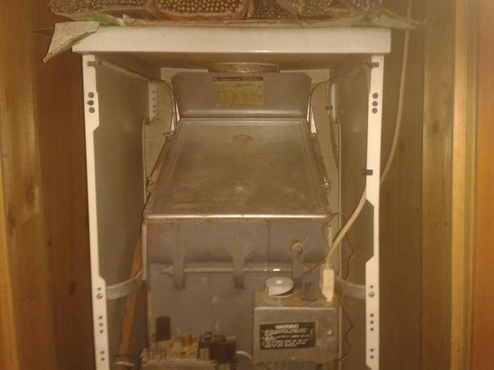

Hi guys,
just running an idea by ya,
my old faithful glowworm 100000btu 25yrs old and still perfect, stripped cleaned and serviced it today.
And it is running fine but I fired it up with the top off just to see how much heat passes the H/E--- WOW
so looked into condensing boilers but the reviews are mixed and the reliability is not good they recon 6-7 yrs and they are getting to the end of their lives etc etc apparently they have had 80,000 call out's in yorkshire this cold snap already. ( why Yorkshire was mentioned IDK?)
and unless you control the return flow accurately they cannot keep in the condensing window,
so the efficiency drops off to similar too the old units.
The general prognosis was with an older house if it is working dont change.
Now my idea was to mod the top of the boiler to include my own heat exchanger fins that pass through into the burner space and out of the top and to blow a fan over the fins to use this wasted heat and blow it into the kitchen
as you can see the wasted heat at the moment is my rod oven,
but you can see the top plate which is held by the thumb screws it would be simple to make a new one,
the top of the water heat exchanger segments is level with that through bolt so there would be plenty of space to slip fins through to pick up the heat when the boiler is running but also, when up to temp it shuts down but the heat is still passing out of the core and disappearing up the flue! It is like having a big rad outside.
my idea is to have the fins extending down into the boiler space then through the new plate up into the space you can see at the top and have a wide shallow fan at the bottom blowing over the fins, ducting the air and then turn the air at the top, back and out towards the camera into the kitchen,
when it is very cold we leave the front door off and it makes a big difference to the kitchen.
the boiler is behind a planked 'door' that just looks like the wall boards it would be easy to put avent in that door so the air can blow through it .
obviously the top would be solid ie sealed from the burner space.
The heat coming off the top would appear to be similar to a 2-3 KW electric blow heater!!
WDYT
