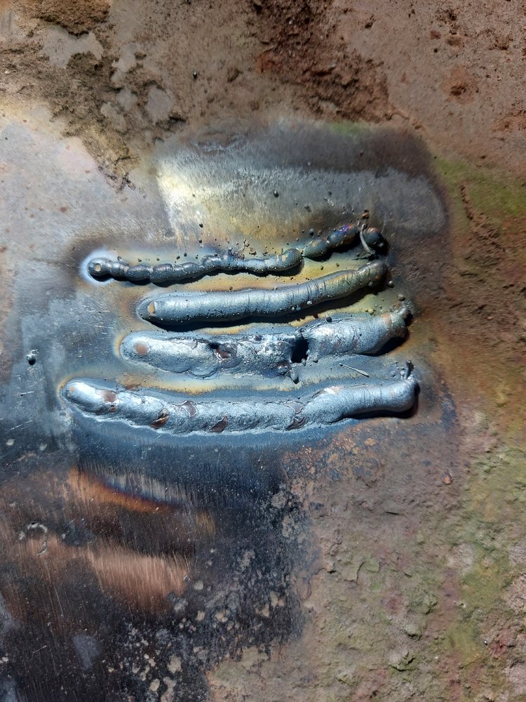

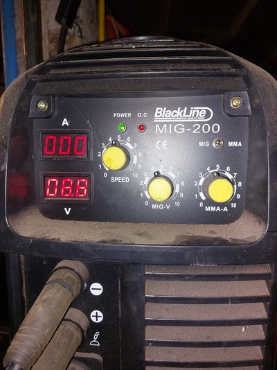

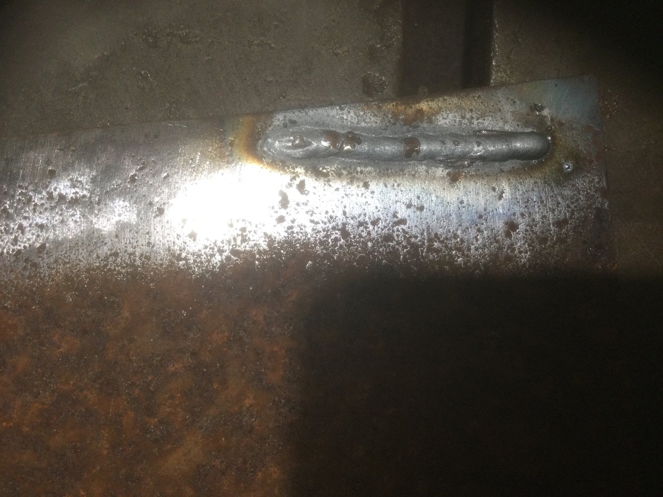

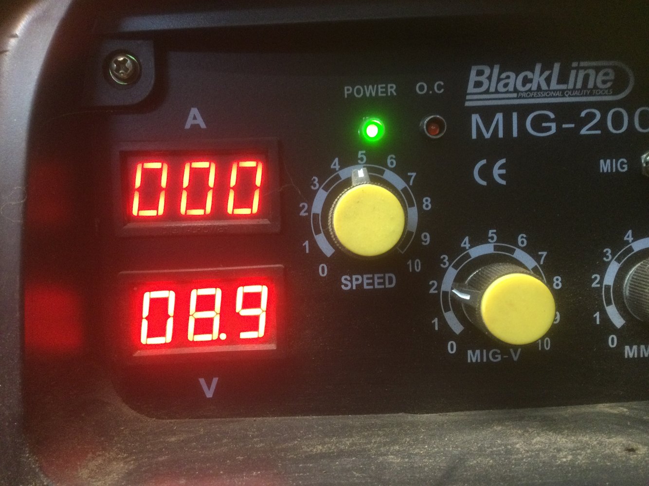

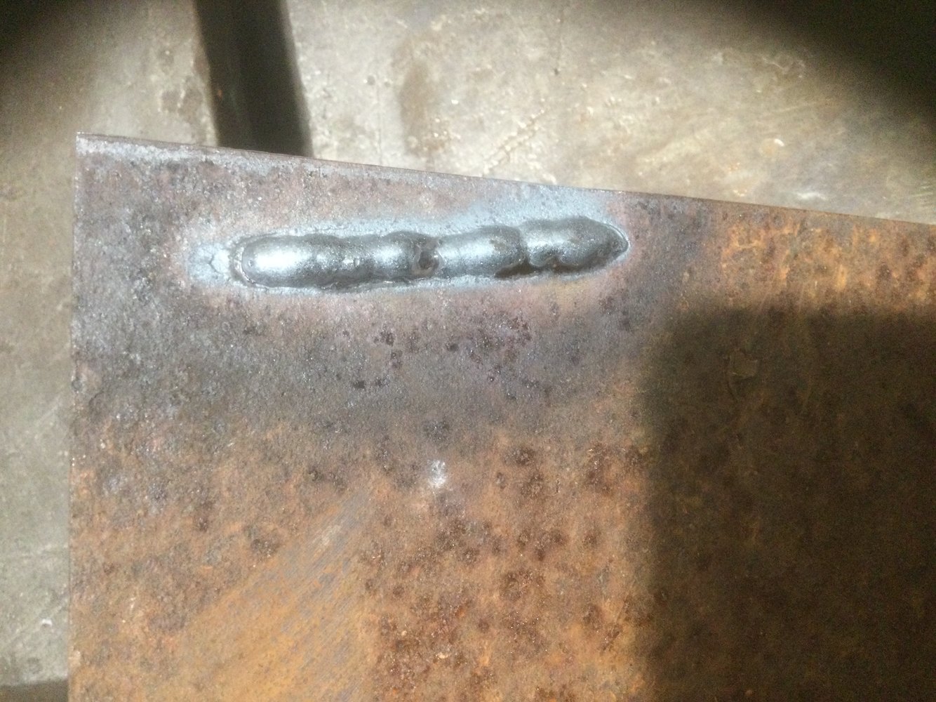

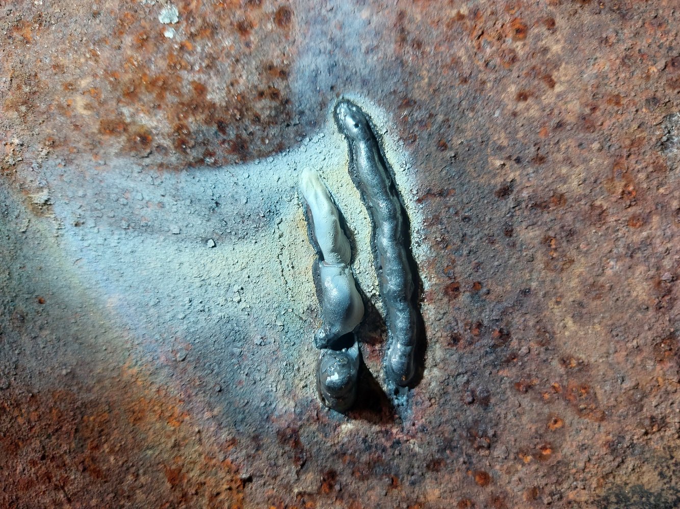

Would it be possible try the welder plugged into the house sockets, even on a short extension lead to rule out voltage drop?I checked the voltage at the breaker in the garage and it dropped to 218V from 230V when welding (it's got a run of 1.5mm^2 for 30m to the house breaker - planning to upgrade soon!), but I have another 20m+ of 4mm^2 extension from the wall mounted 32A socket to the welder

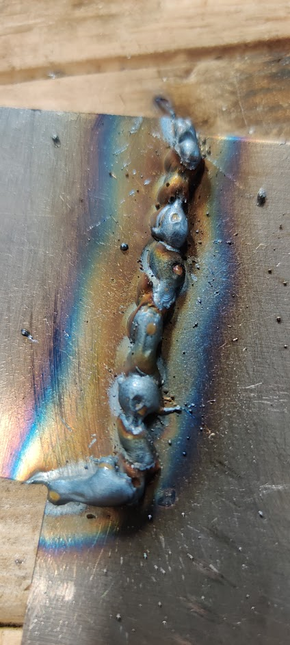

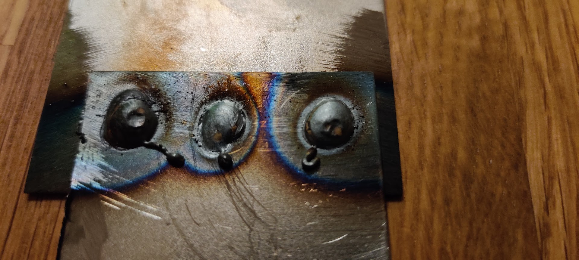

I agree, mine is on a separate 32a socket with its own breaker on 6mm run from the house board. I have no problem with 0.8mm or 0.6mm and I use 80/20 gas. I have posted test pieces before and they look nothing like the OPs.Would it be possible try the welder plugged into the house sockets, even on a short extension lead to rule out voltage drop?
You're asking a lot from a long length of 1.5mm cable
Would love to. I'd even pay a couple of hours of someone's time but alas, I don't know any good welders...edit. Finally get an experienced welder to try it or another hand lance or take your scrap bits and try on another welder to rule out box problems.

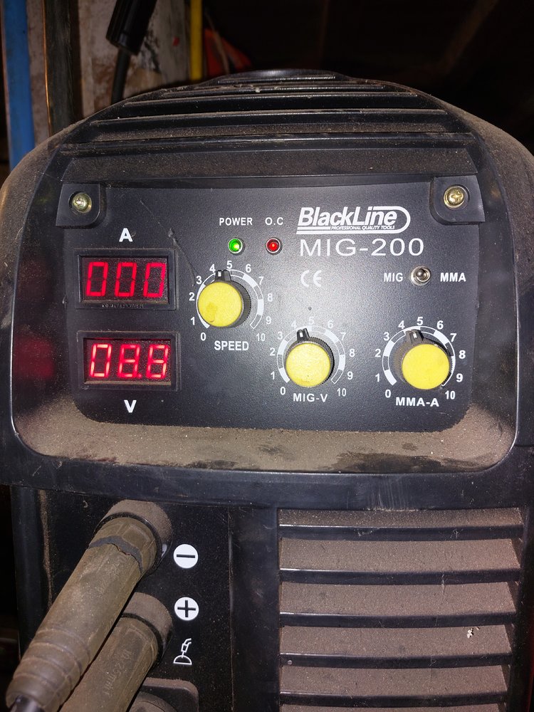

I've never done stick.In mig welding wire speed = amperage, volts will effect the puddle flow but not the actual power so you probably need less wire speed yet!
Takes a while to get your head round it but opposite from stick welding
Is this torch connection too loose?
