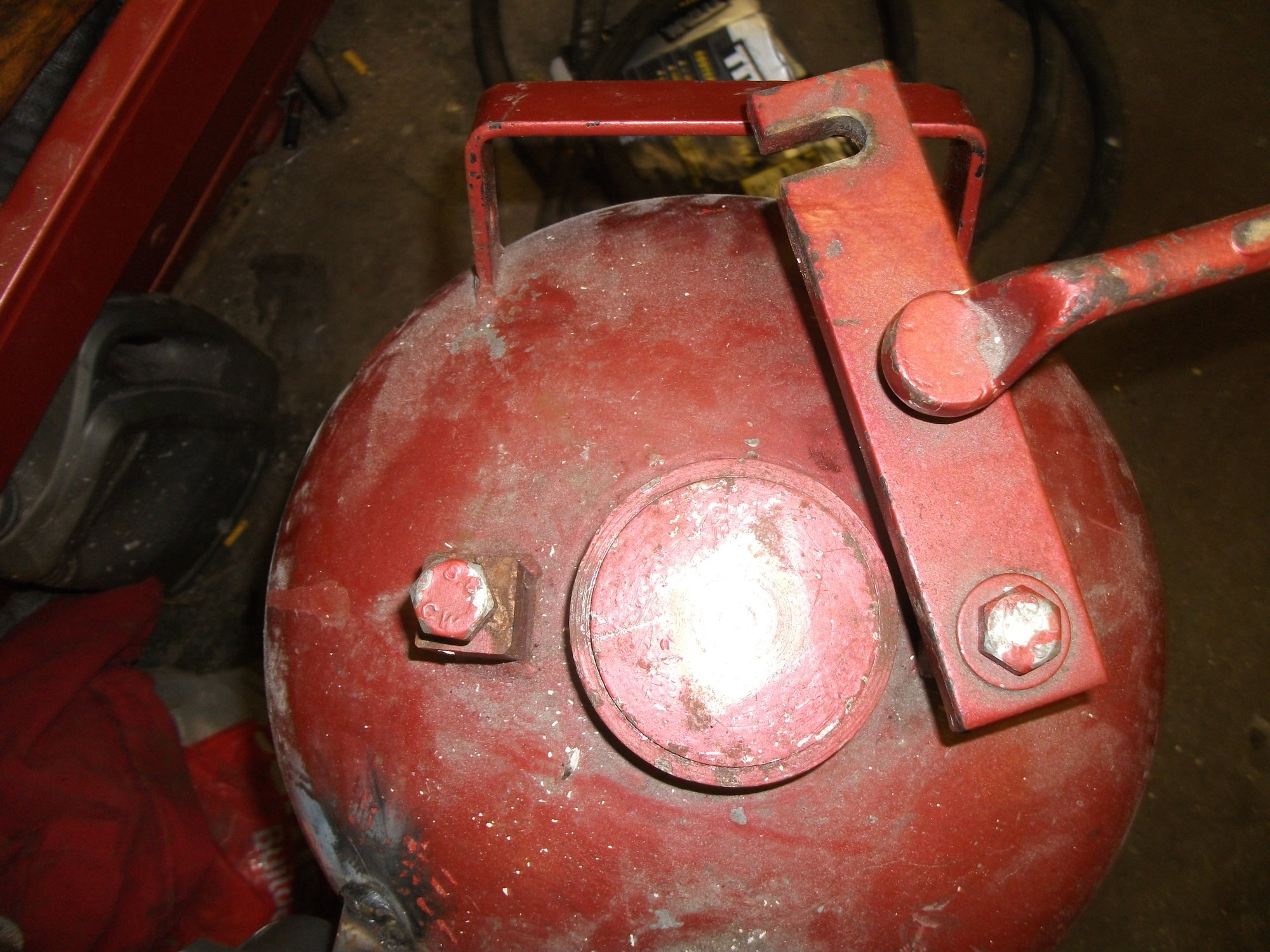

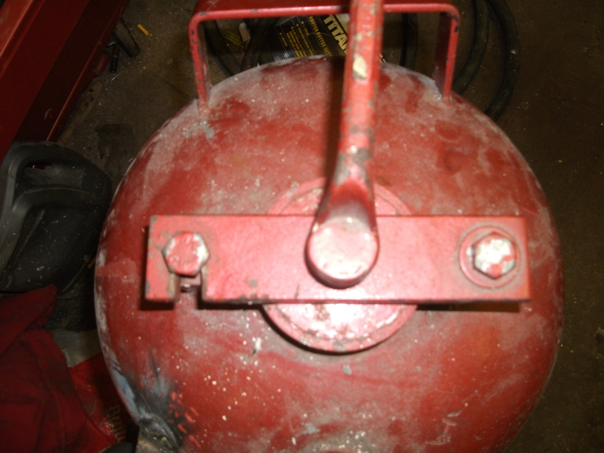

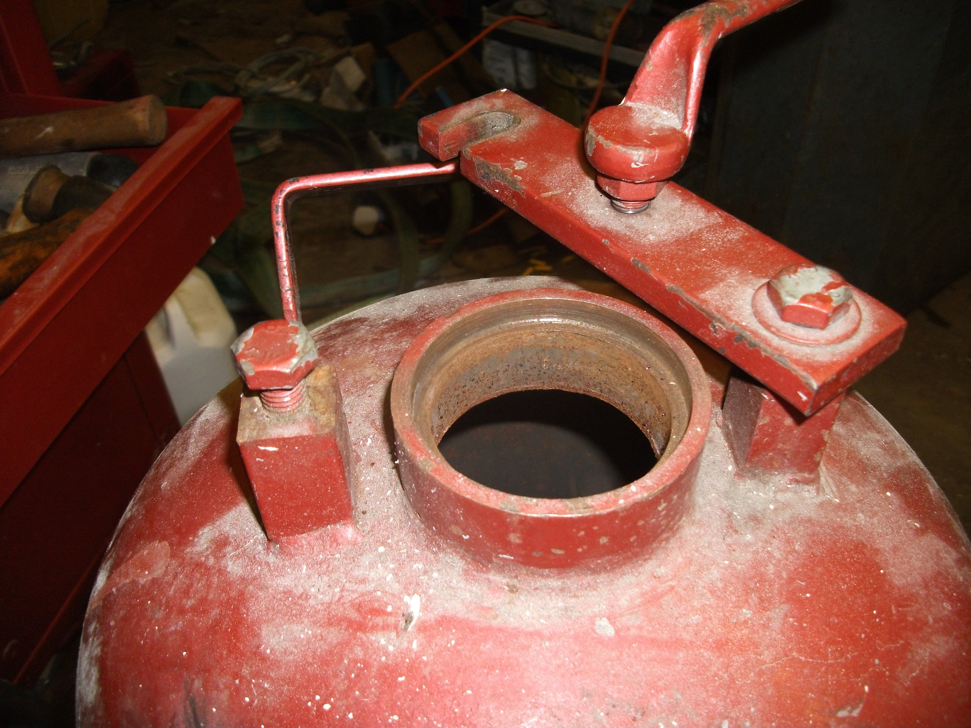

there is another version which is slightly taller, but the up plate is the other way round so works like a funnel to fill it

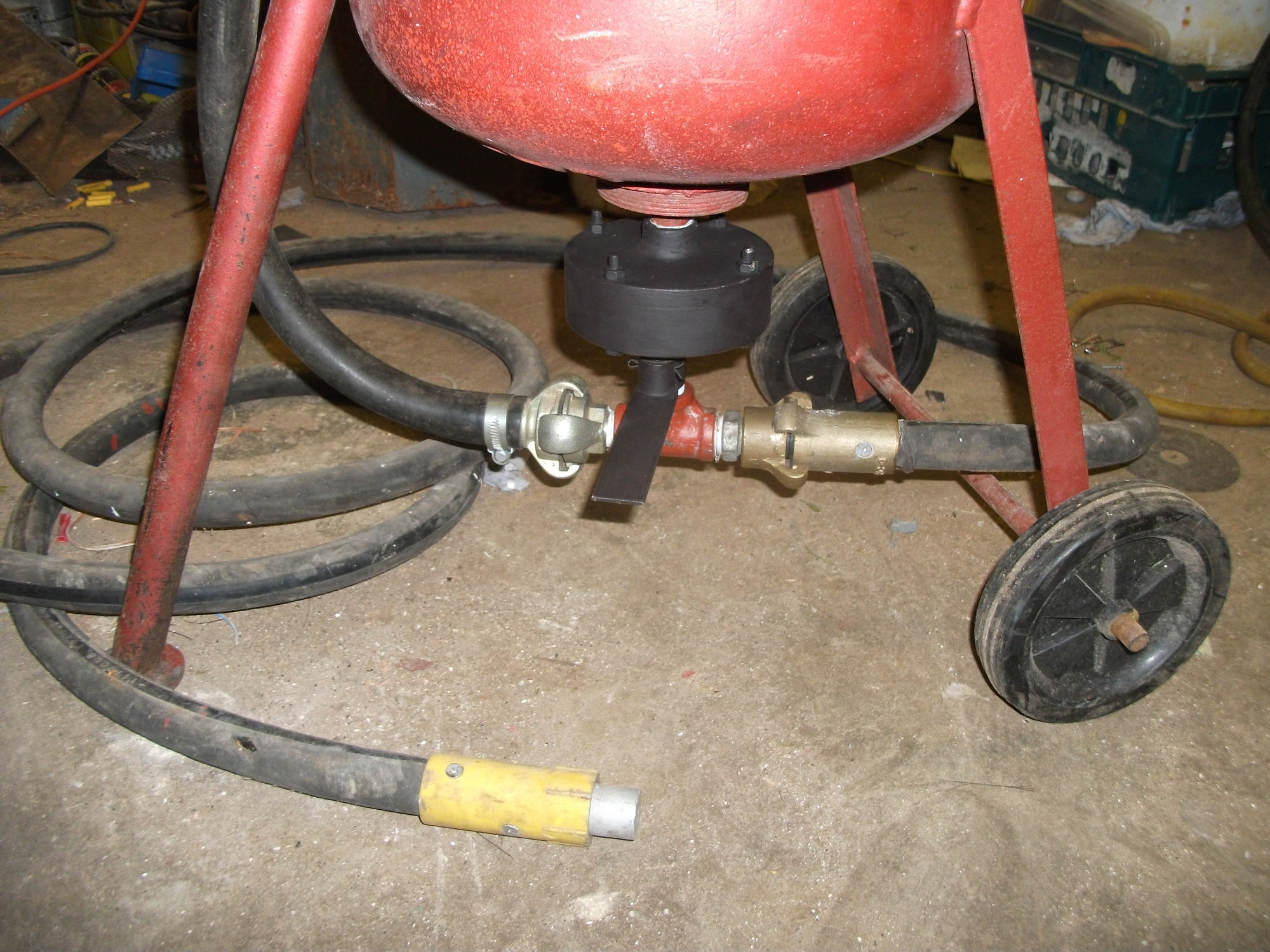

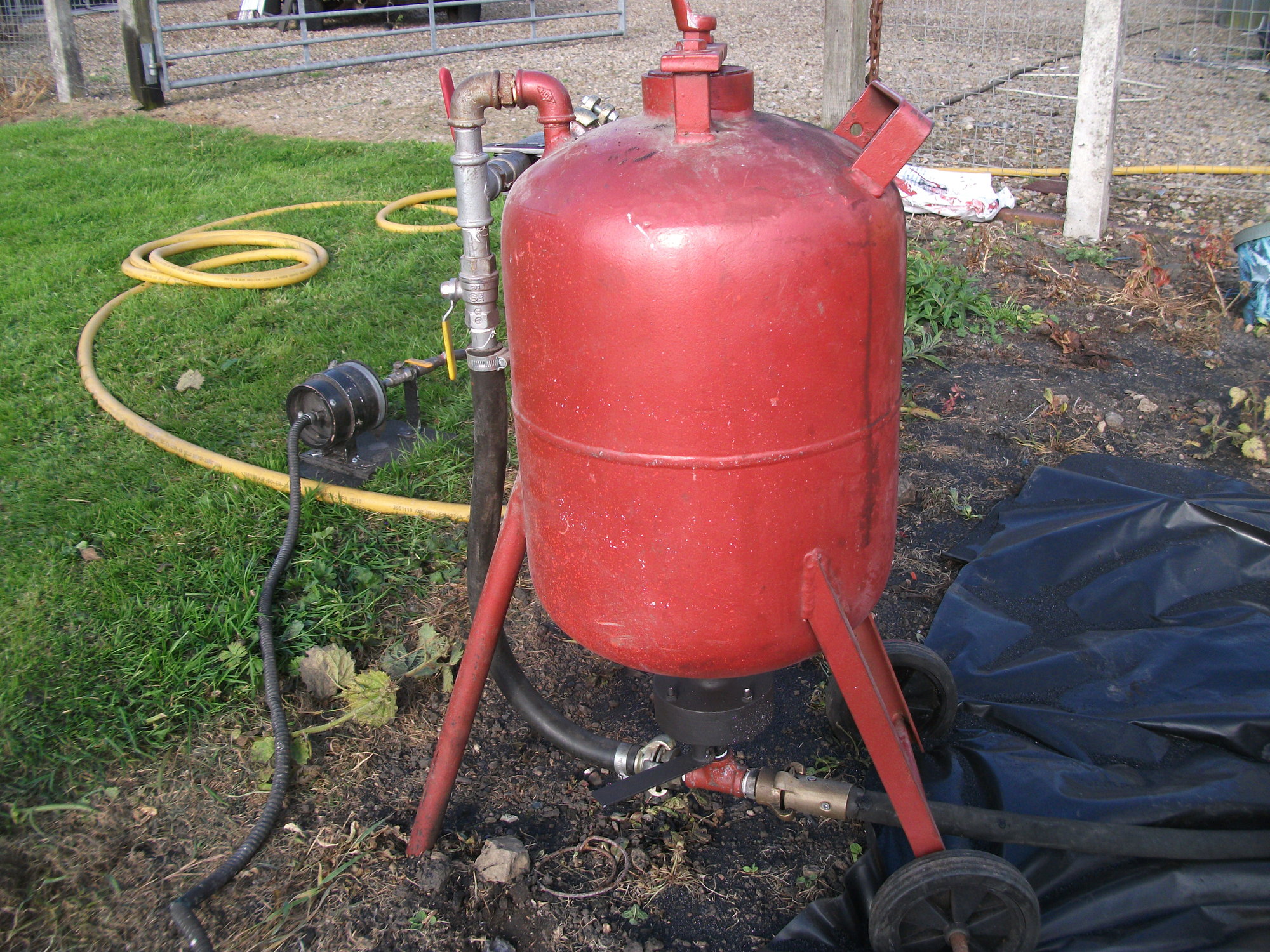

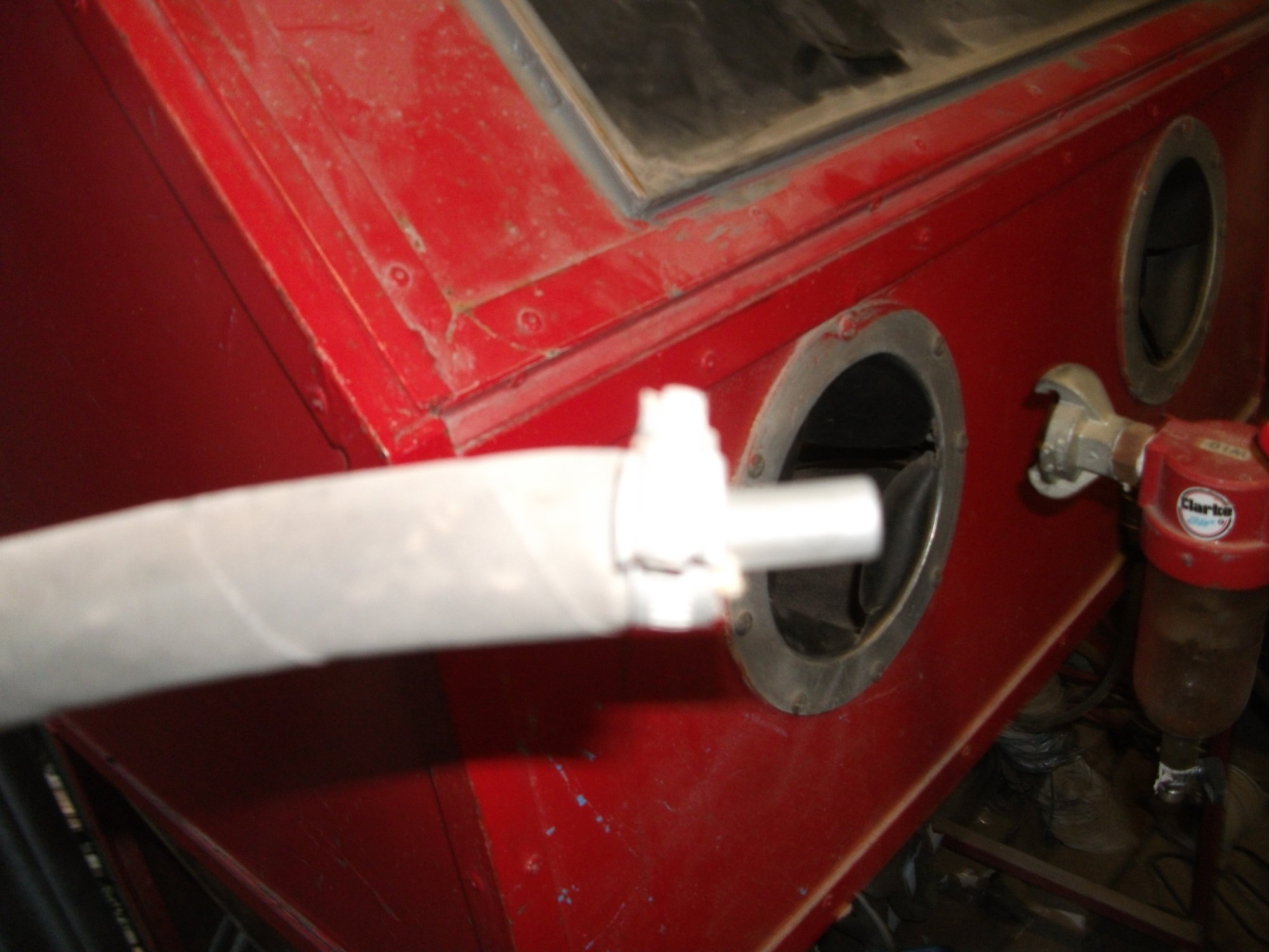

yes just pressurise the pot when you start blasting and turn off when done nozzle just held in with jubilee clip on my small one proper holder on larger one but just the same set upso you have no gun just a length of pipe with the nozzle in it

Oh man at a score a go that ain't goodI was well choked when I lost my blast nozzle . forgot to tighten it in hose and went to use it outside .got to 100 psi and it blasted off in to the long grassnever did find it
How did u make tour pot dear sirI was well choked when I lost my blast nozzle . forgot to tighten it in hose and went to use it outside .got to 100 psi and it blasted off in to the long grassnever did find it
yesno no lathe! unfortunatly, so u just turn the air on and off to stop and start
simples ok next job! I have a expansion vessle might use that
