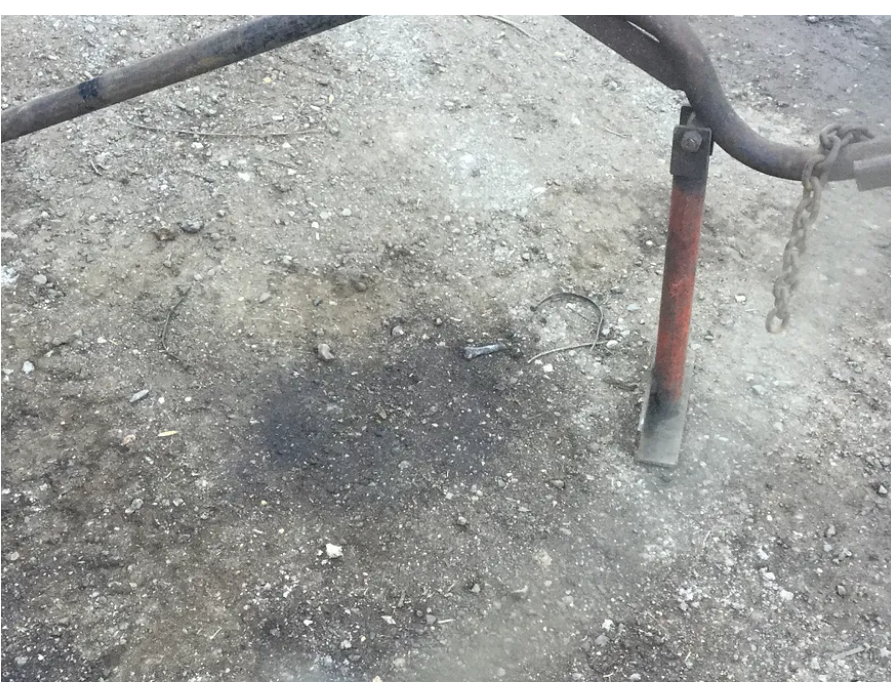

CleverMade this gadget for lifting out posts complete with the concrete ball, just wrap the chain around the post,push down the bar and the post/concrete pops out of the ground. Its as quick as talking about it, hole ends up a tad bigger but thats no hardship.

I'd have a go with it but on some had to overdo the concrete. So many big flints here they will sometimes knock the 12" auger off centre and you end up with a hole a foot or more off where you want. Means a bit of hand enlarging the hole and more concrete.
Still worth changing the posts Mr Off , if you value your time £20 a post and a shovel or two of concrete is the cheap fix.

I tried something similar made of 40mm² SHS tube, to remove a met post from clay ground, the tube bent!Made this gadget for lifting out posts complete with the concrete ball, just wrap the chain around the post,push down the bar and the post/concrete pops out of the ground. Its as quick as talking about it, hole ends up a tad bigger but thats no hardship.

I use a hi lift jack but same idea. The whole lot comes out, concrete and all.Made this gadget for lifting out posts complete with the concrete ball, just wrap the chain around the post,push down the bar and the post/concrete pops out of the ground. Its as quick as talking about it, hole ends up a tad bigger but thats no hardship.
There is something like yours available commercially- post popper or something. Yours seems to have more leverage though. Theirs works on a ratchet
That’s the only snag with a hi lift. You need to slant it and rest the top against the post to miss the concrete base.That one is about twenty years old now and done its share of post removals, it took a while and a lot of messing about to get the geometry right but it works really well and there isn't anything I would change on it. The foot is far enough away from the post to allow its extraction complete with concrete, all the others I have seen are too close and the foot sits on the hidden concrete and stops the post coming out.
