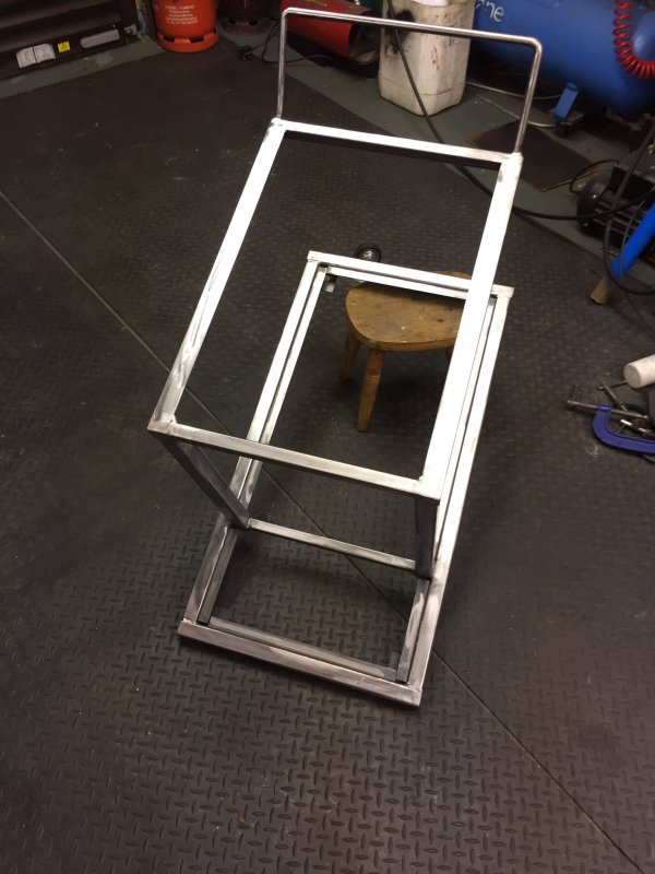

Well I think you make something of a point here, I must say this thread has really surprised me at the unconventional way guys are doing things. I do get using corner clamps but actually I have not seen them used much in industry. If its worth ant degree of setting up for a jig is usually made up
If I had to chose between an open end or a bit of flat welded in the end of the box to close it off I'd go with the open end. The closed off with a bit of flat idea just looks like an after thought.I use corner clamps most of the time because I do not have a big flat surface welding bench, when I worked in a fab shop we had 1/2" plate topped benches, 8x4 foot or so-eazy peazy for tacking up summat like a frame.
My workshop floor aint flat, so I corner clamp stuff, and shim up the clamps if needed to keep the job true.
But back to OP, mitres is tha way to go for me, if not, butt joints and I weld a bit of flat on the open ends-I don't why, I just don't like open ends for some reason![]()

Another reason for going just a touch over lolmmm, with most saws I have used not cutting spot on to a single degree that well at least of the marked calibrations.
A decent fabricator would have a frame tacked together in the time you wou;d have clamped the two bits together in one of them![]()
Tacking a frame up square is one of the simplest things you could learn.
Accuracy when cutting the components is key, if you cut the mitres properly, and the lengths are equal for each set of sides, you cant get it far wrong.
