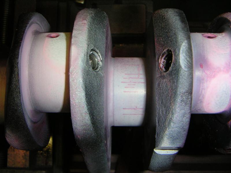

That looks pretty terminalExactly what happens - it cracks and those cracks wreck the oil film - borrowed image of a Lancia crank from some random Italian stallion forum from some time, some where.
Lancia OE English language workshop manual for my 1991 integrale mentions the steel crank is nitrided.
. How many times has the crank been ground? the guys who've done my cranks have always said that they're good for one regrind. The usual manufacturing process is that the cranks are ground slightly oversize before nitriding, then they're ground to size afterwards. This cleans up the bearing surface, covers any slight distortion, and also hits the point of maximum hardness which is (IIRC) 8 thou' below the surface. Total depth of hardness on nitrided EN40B steel is about 25 thou'Yeah thats right, common rail diesels i have experience of it with. It does not surprise me that it has been happening since the 80s, time is valuable in mass production. Ill have to have a read up on k series etc!"Fitting" components is nothing new - Rover were doing it in the 80's with the k series, the Japanese with bike engines also. Not so sure about "electronically ballancing cylinders", maybe diesel common rail stuff?
