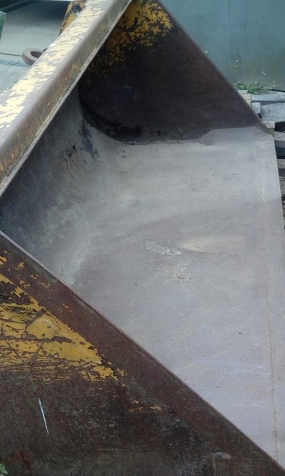

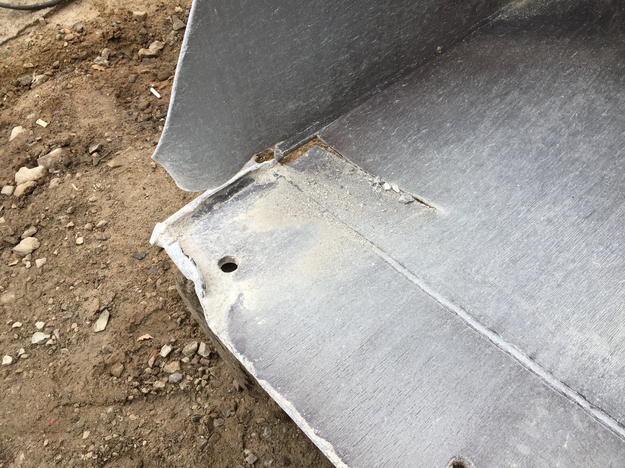

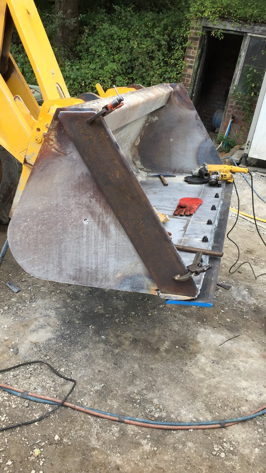

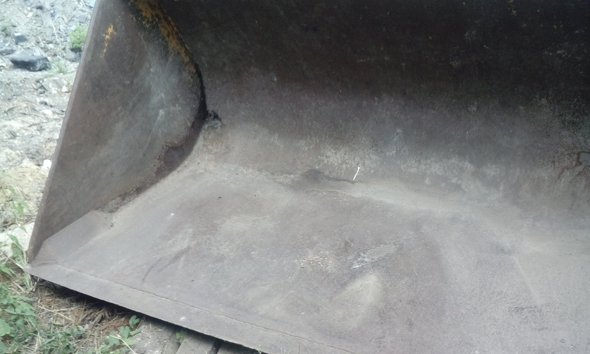

So,the local wood yard has asked me if i could sort out a repair on their bucket
Story is the H&S guy on his last visit has condemed so has to be sorted before next visit
All it gets used for is loading cut logs no dirt or digging done
Heres the bucket
Its 2.1M wide

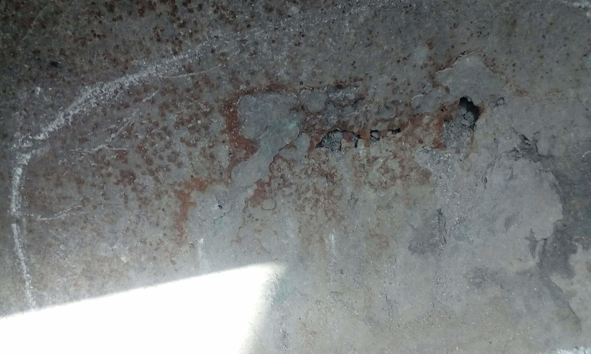

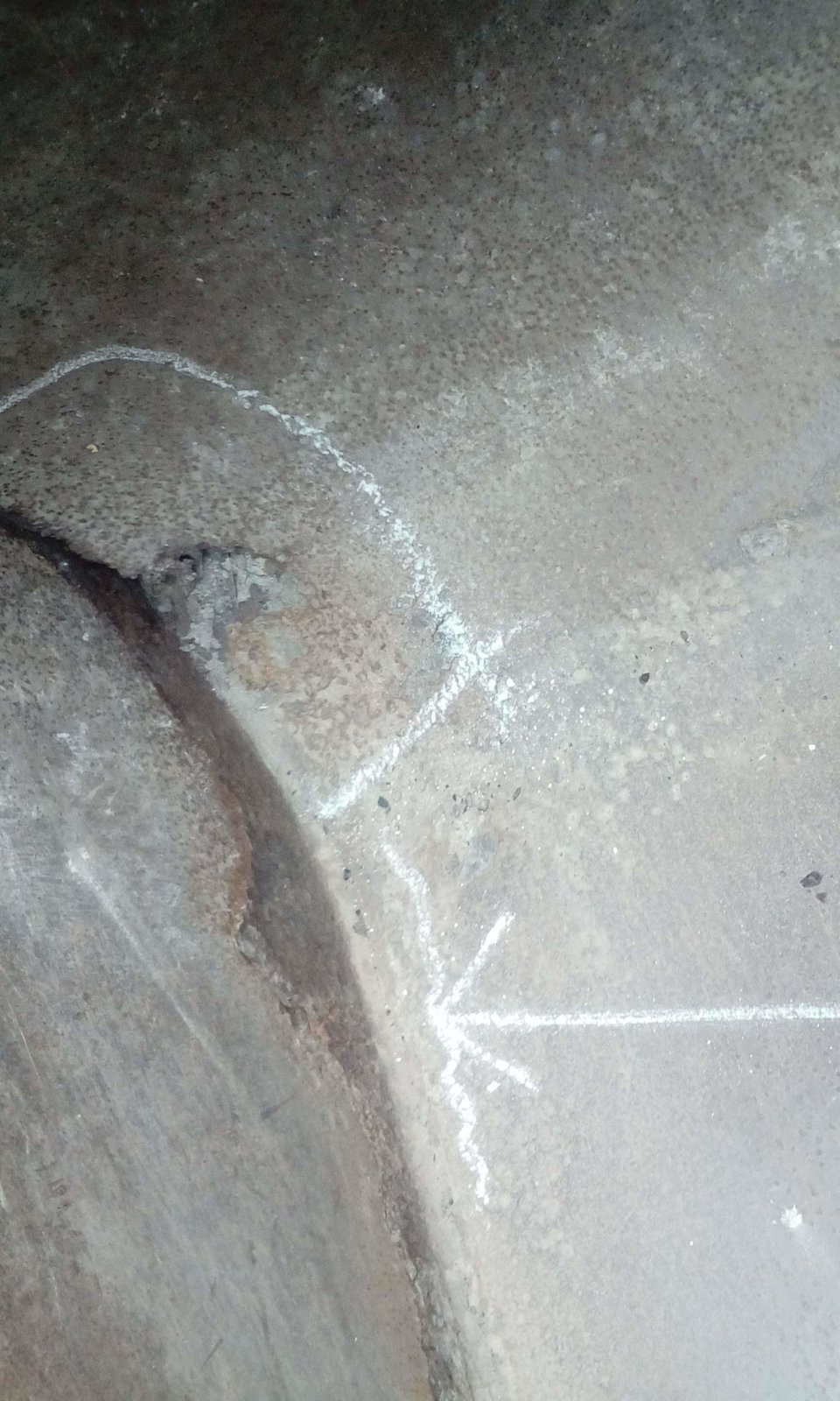

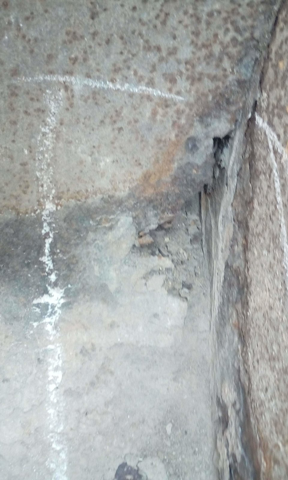

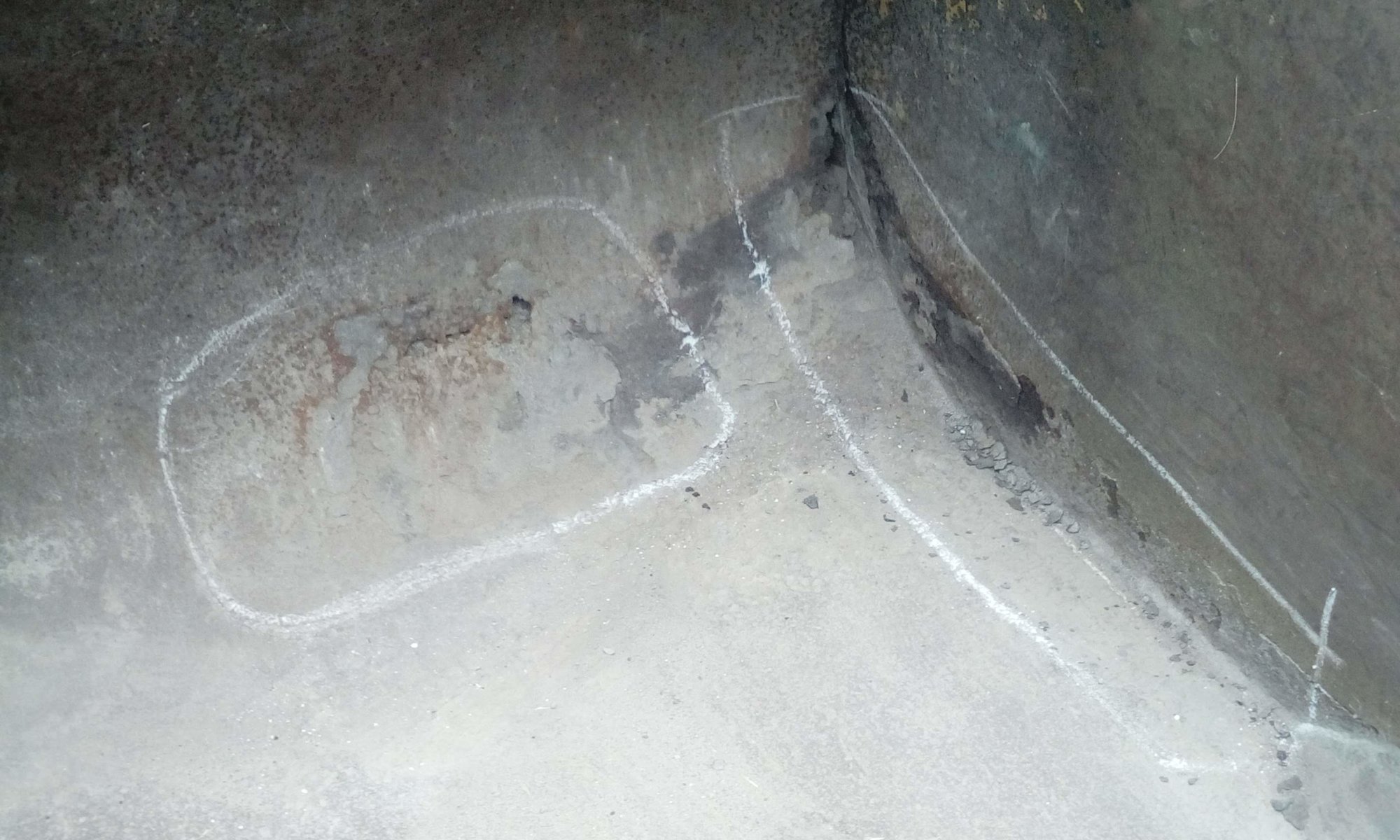

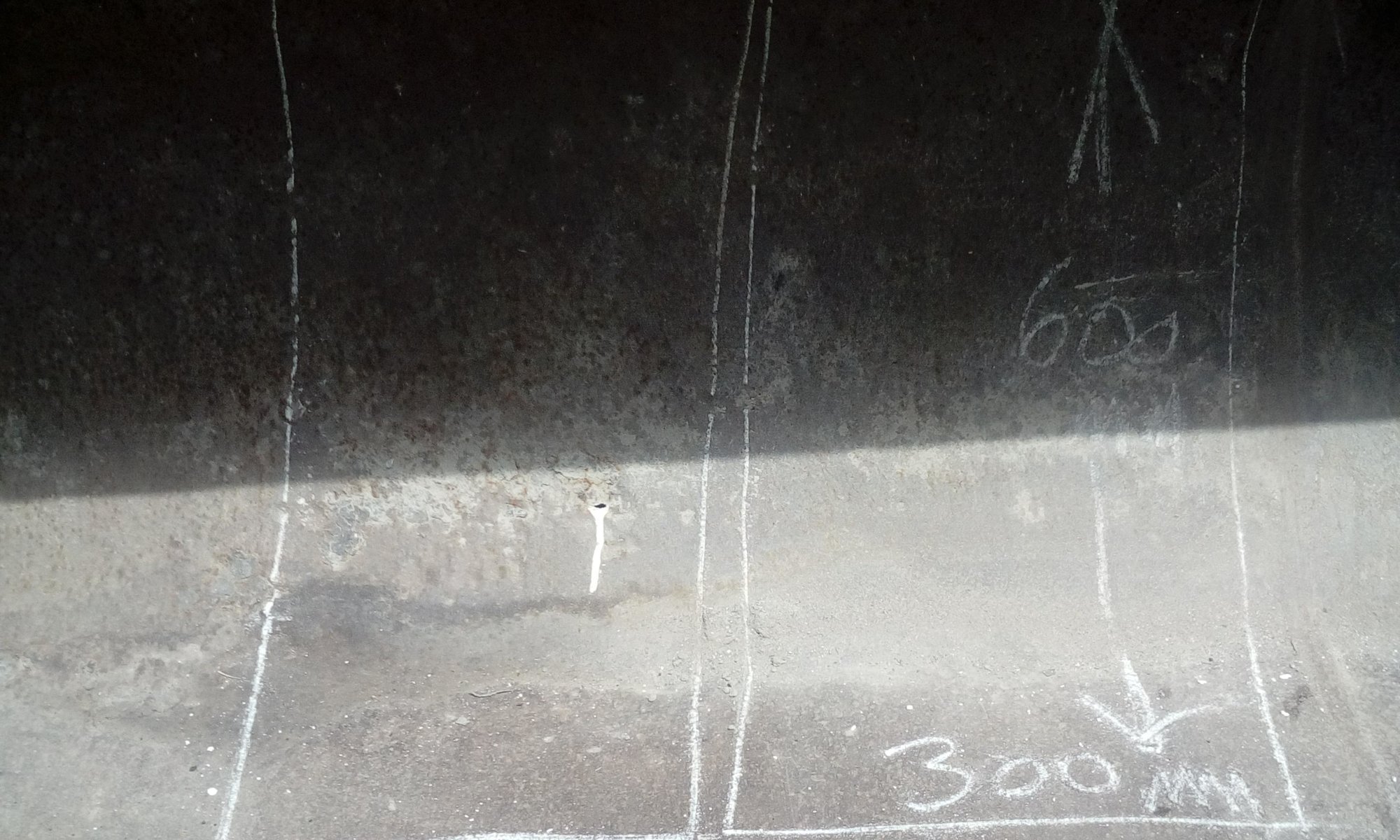

I've high lighted the worse areas
It is in a bad state rust has got the better of it tbh its a bit thin right along the whole back of it not in anyway i dont think its just a patch over the said areas as getting to really clean for migging is not going to happen
So i thought of this idea
Not to scale of course,but i was thinking if i sort of reline the inside with sheets of 3mm mild steel gapped at about 3mm apart then add a sized sheet to the inside cheeks(is that what that part of the bucket are called?)
I was thinking of 7018 3.2 rods tack the sheets at the top and use the fork lift to bend them in to shape then fill the gaps etc
I reckon my tecarc 161i could manage it,only slight prob is i'm going to have to run off a 13amp supply
Doable?
Open to suggestion so feel free to offer them
Big problem i have is how to price it,i think parts and labour but god knows how long it'll take me
