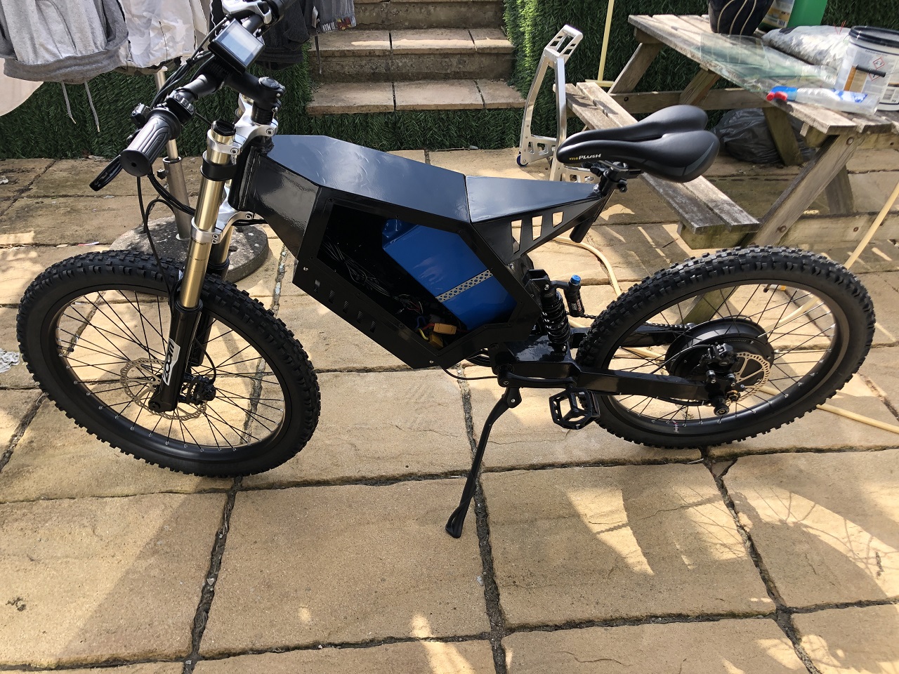

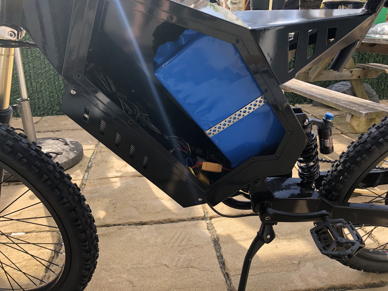

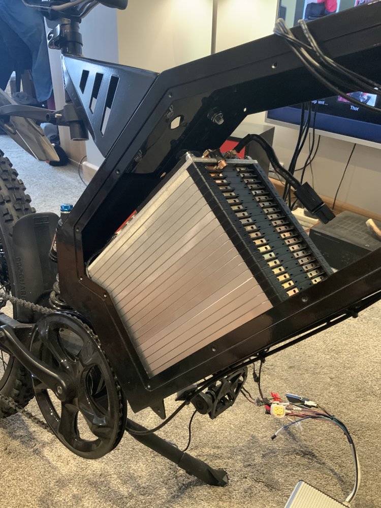

Today I ran the bike with the display working and the full battery pack in.
The included 60A 3000w Controller must off had it's specifications crated in a very optimistic marketing department.
It actually tops out at 29A draw and 1000W.
I have since ordered a Sabvoton 100A controller which is supposed to be a very powerful and trusted controller with full programming features.
That being said, even at 1000W the bike is still pulling 30MPH on the flat with me on it and faster when pedaling.
View attachment 295299View attachment 295300
