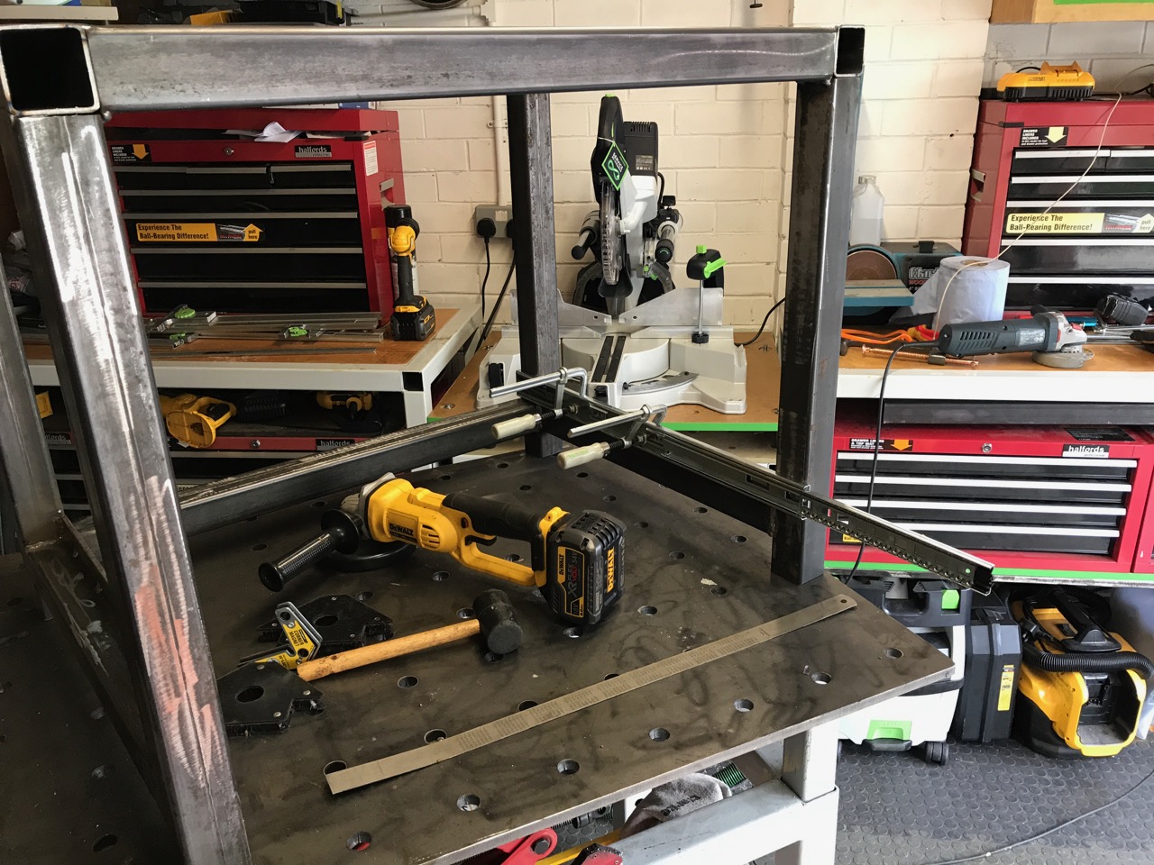

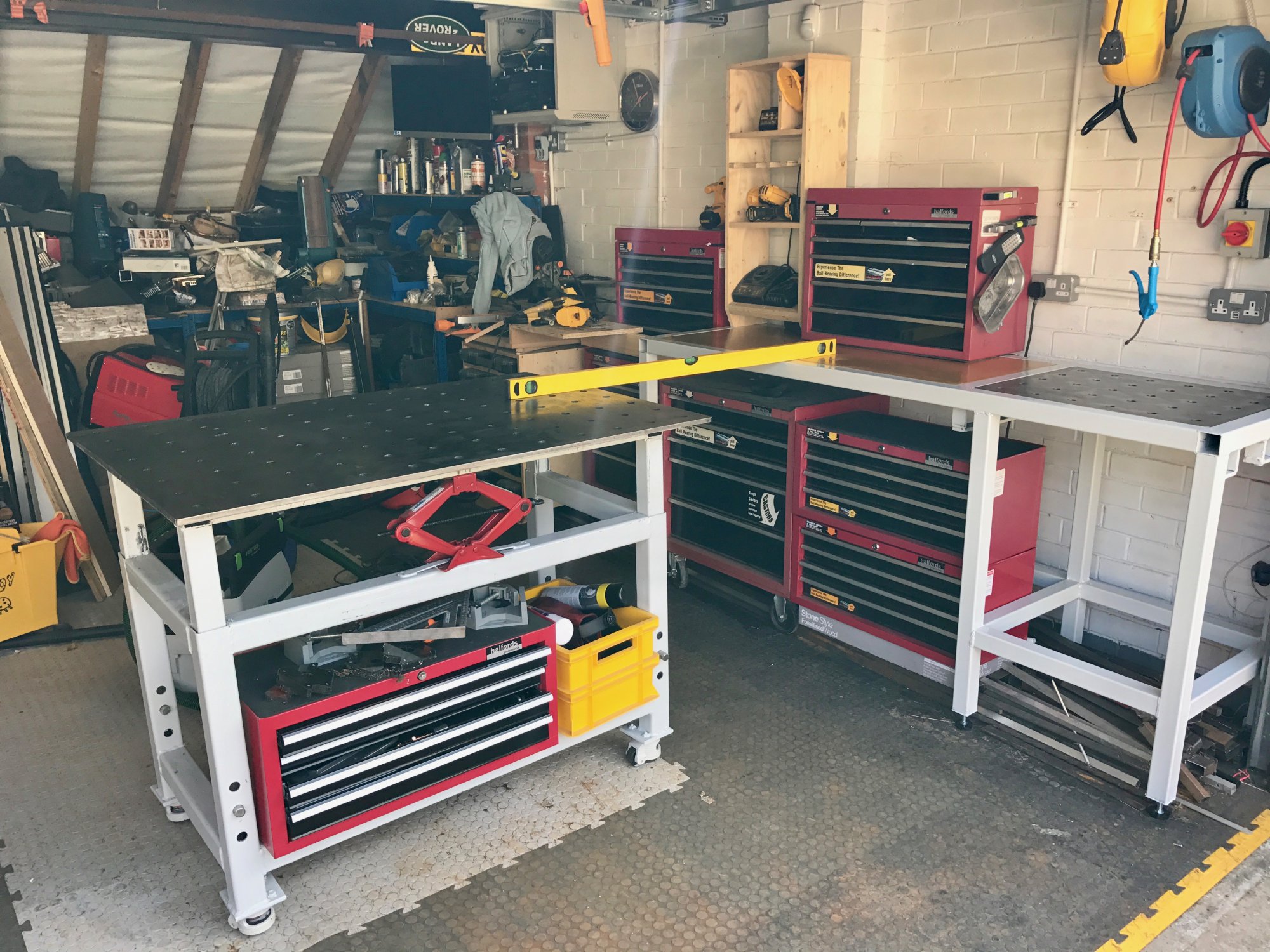

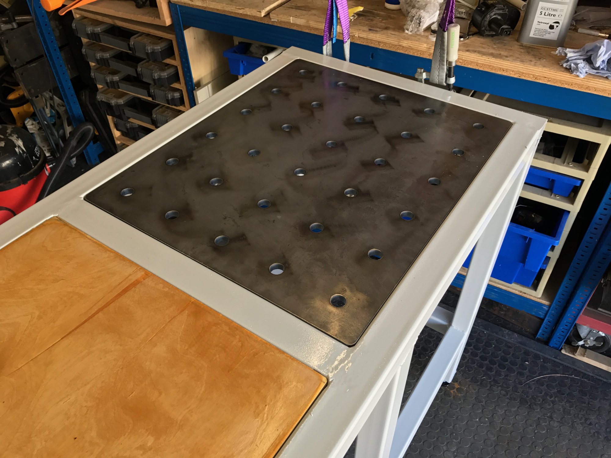

Been working away a lot but grabbed sometime to get this first section pretty much complete. It just needs the draw section building for the right hand side and the slide out extension arms fabricating. Only another 4 sections to match need building then, its going to be slow process this garage reorganisation!
Thanks and yes eventually I think i will fill them, I have some rubber grommets but am keeping my options open right now and also for bolting the other sections together. I'm also considering if i could use the one on the heavy end as a receiver for things in the future so didn't want to do anything permanent just yet
Yes it could come in handy, the more I look at in position I think i will leave them open I don't see any harm in doing so. Got it in place this lunch and levelled up. its motived me to start the mitre station now seeing the bodge of a version next to it. Also need to make a trolly for the middle tool chest units I'm wanting to have at knee height. I like the smaller draws and want everything where i need.

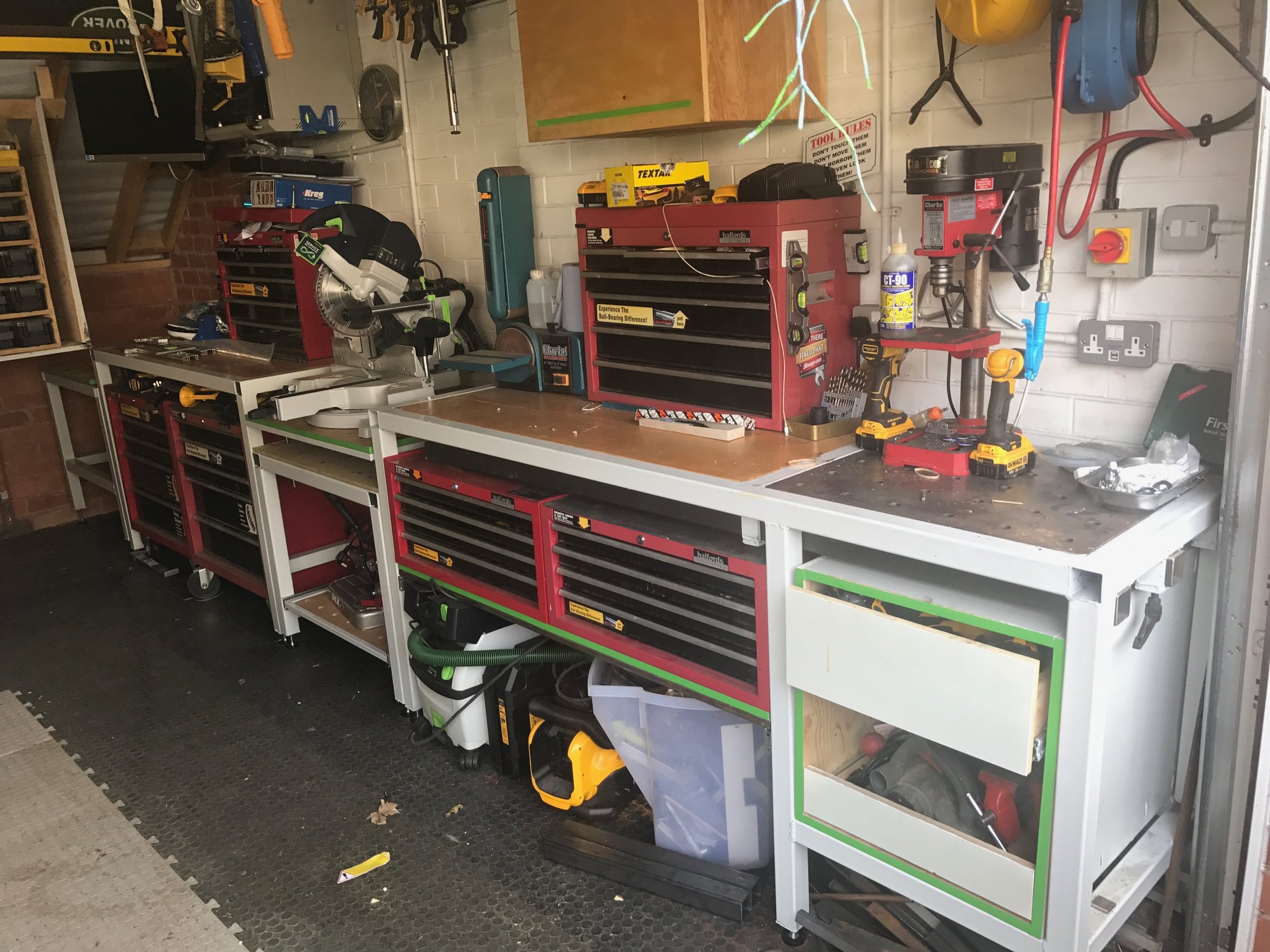

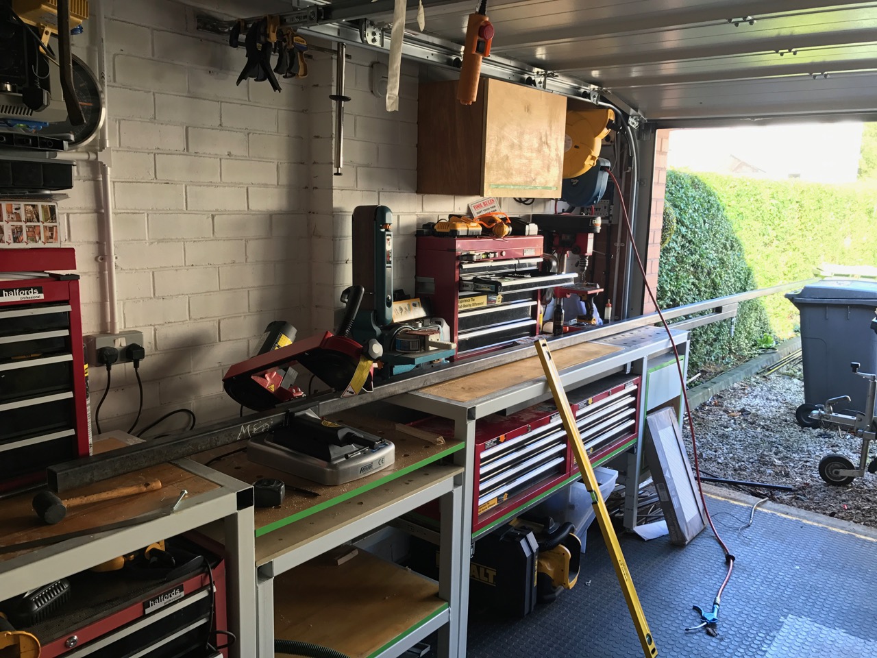

Been building some more bench units this weekend including mitre saw stands. Glad i made the slide out extension arms on the bench. Having the 7.6m lengths delivered from MetalHub was handy but needed the length on the bench to get them cut.
Using standard Draw slides with 30kg load rating as thats what I have. Could really do with some heavy duty ones but can't seem to find a source that doesn't cost +£100 for a pair. if anyone knows of any suppliers at reasonable costs i' all ears :-)

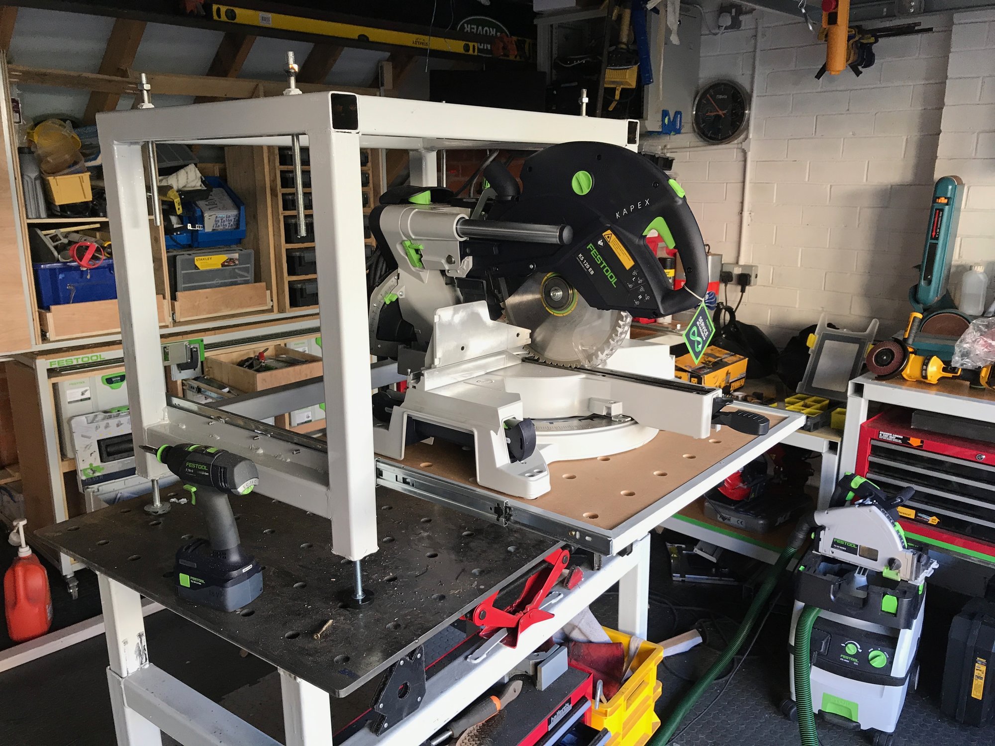

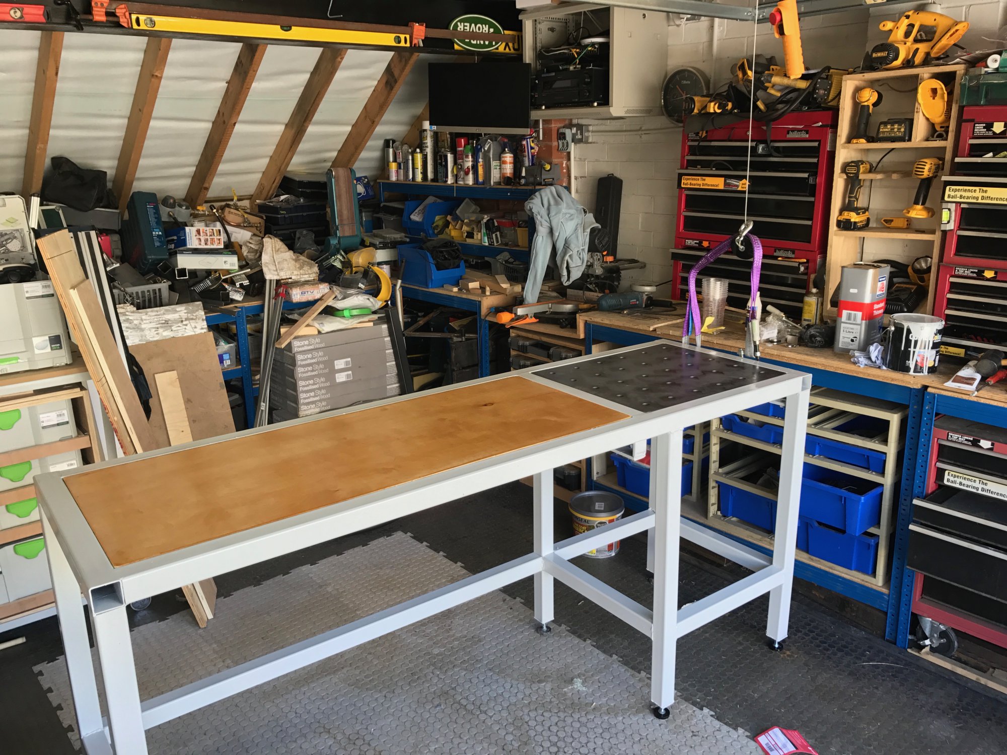

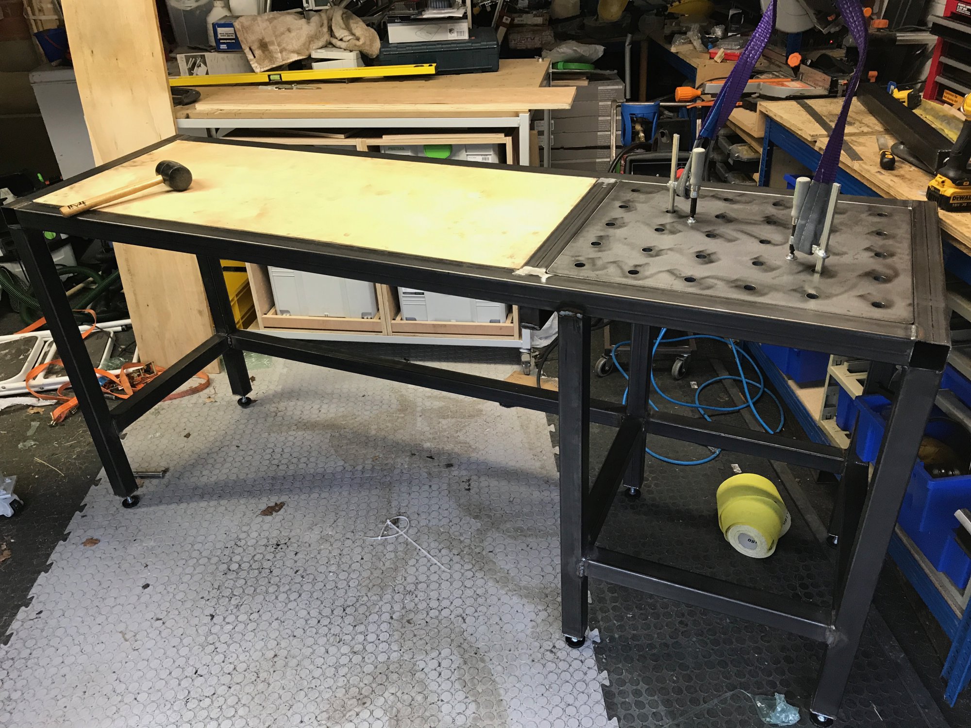

Cheers slowly working my around the garage lots still to do, its nice having decent surfaces to work on for once. The Welding table and MFT table slide away under the back floating storage (work in progress) and the Kapex Mitre saw and Femi Bandsaw have the exact same height bed so can swap out easily on the mitre bench. full length bench's either side the mitre station works well:

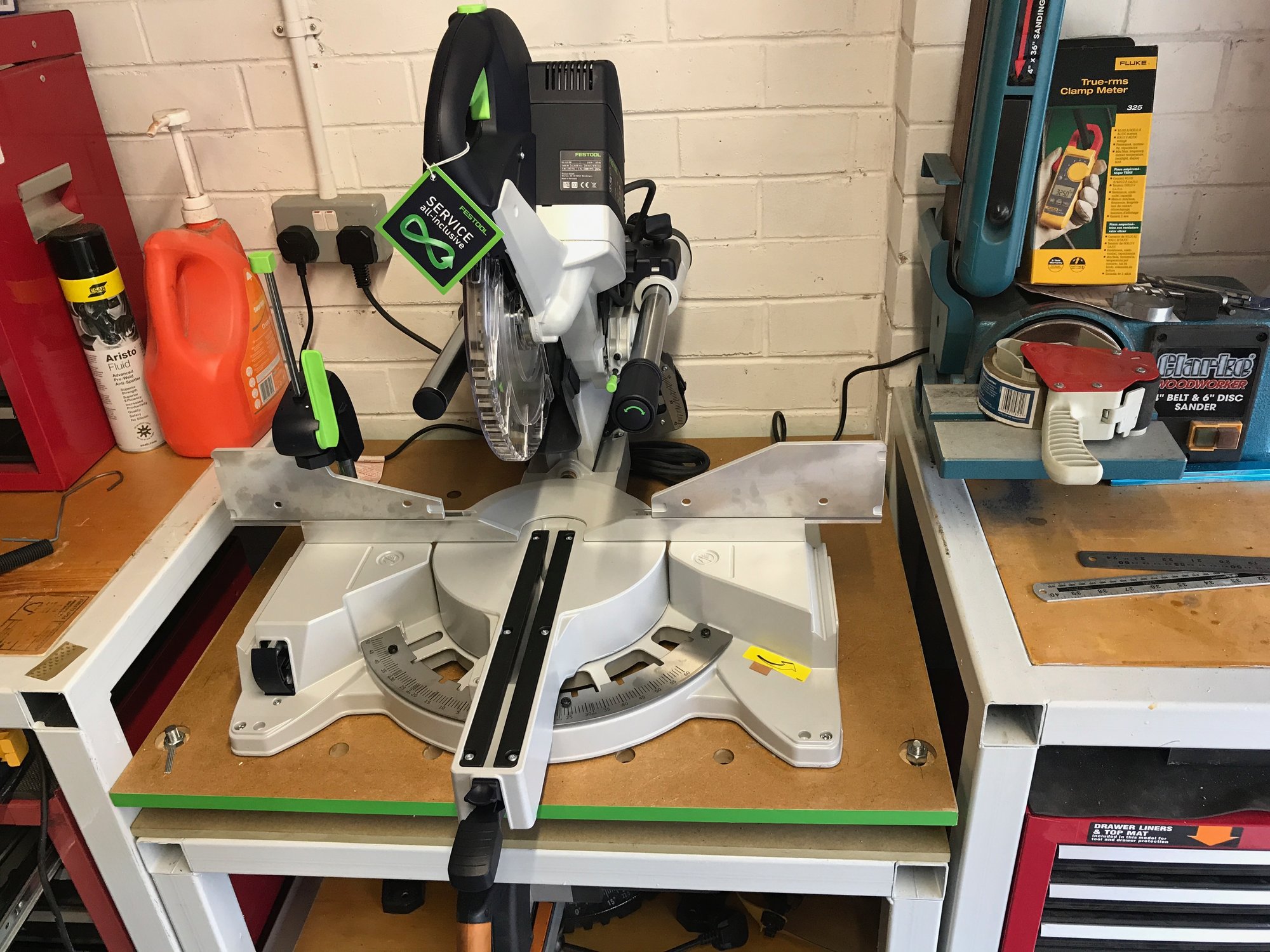

@chris b, thanks and yes the tables are perfectly levelled with the saw beds to give nice long support to the saws. The mitre table top is floating on M12 rod legs to give fin adjustment.

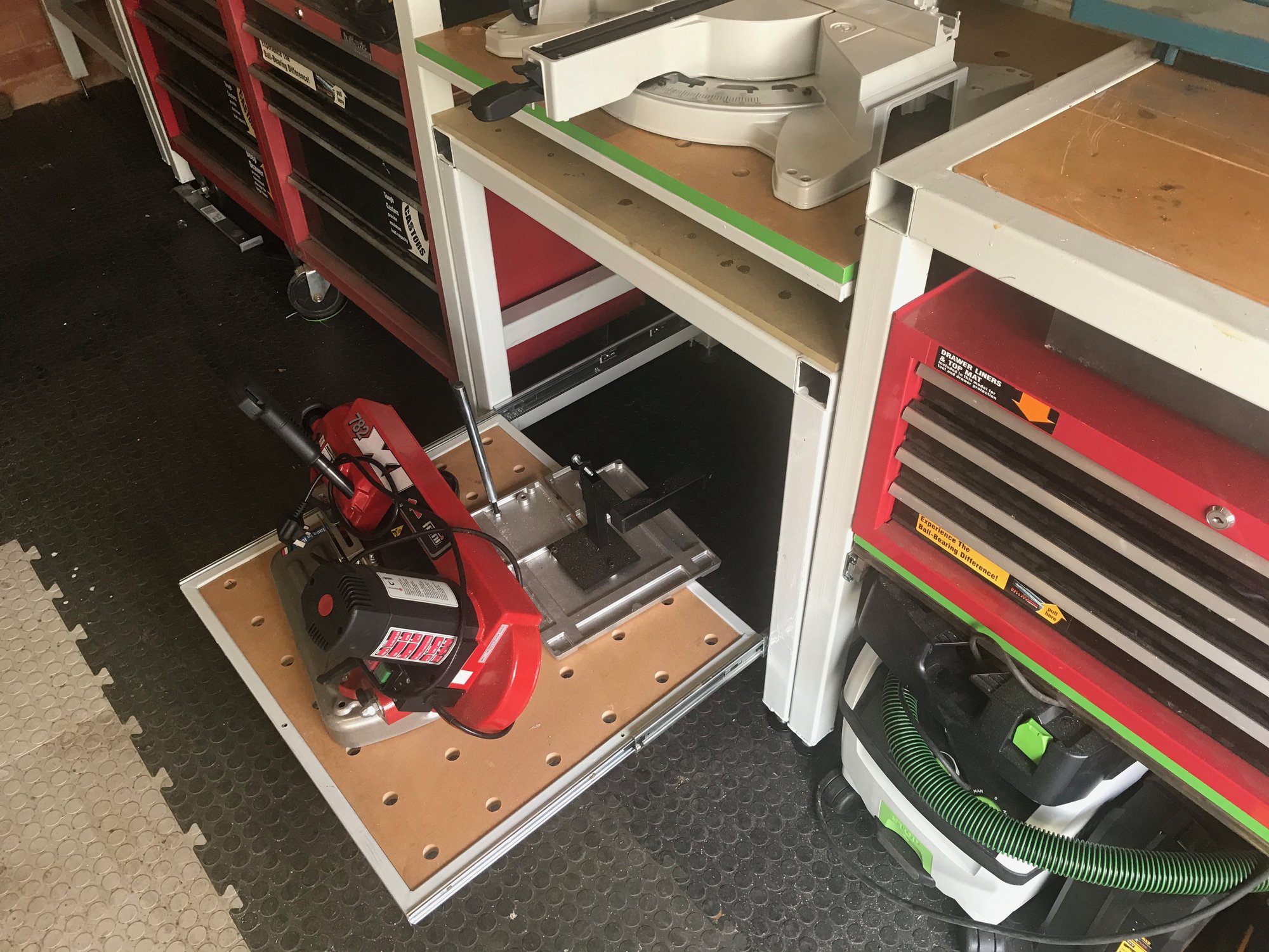

@Arclikeharrypotter, So far I'm liking the Footmaster castors. I was a bit worried they were too small but they glide nicely. The housing is really heavy duty and being able to drop the levelling feet easily makes the table very secure nice and quickly.
Got the mitre station finished at lunch, both saws attach to the top nice and securely and can relatively quickly swap them over with the pull out draw making it much easier.
