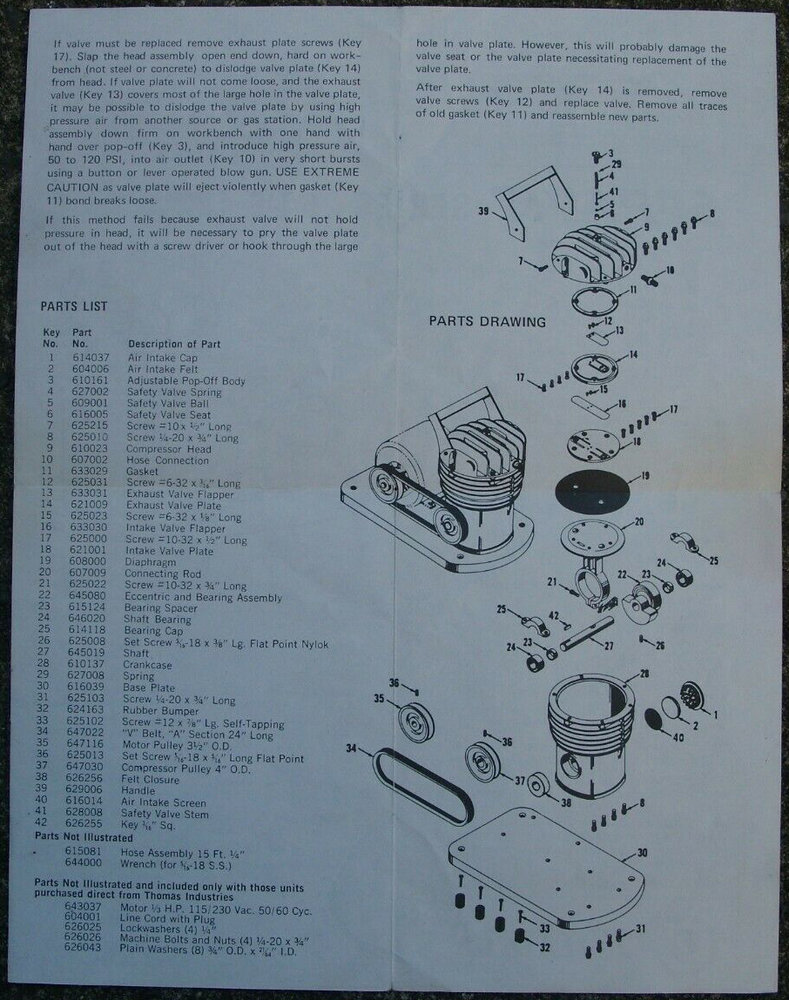

It is the inlet and exhaust valves you are looking at. I still have my old Burgess compressor that I used to spray my Mini that I had 30 years ago. The reed valves either get gummed up or lose their flex, you can replace them with whatever you have to hand. I think I used an old set of feeler gauges to replace mine.

The model is actually the EM 254 and the instruction manual gives very little information about the compressor motor in its 16 pages.

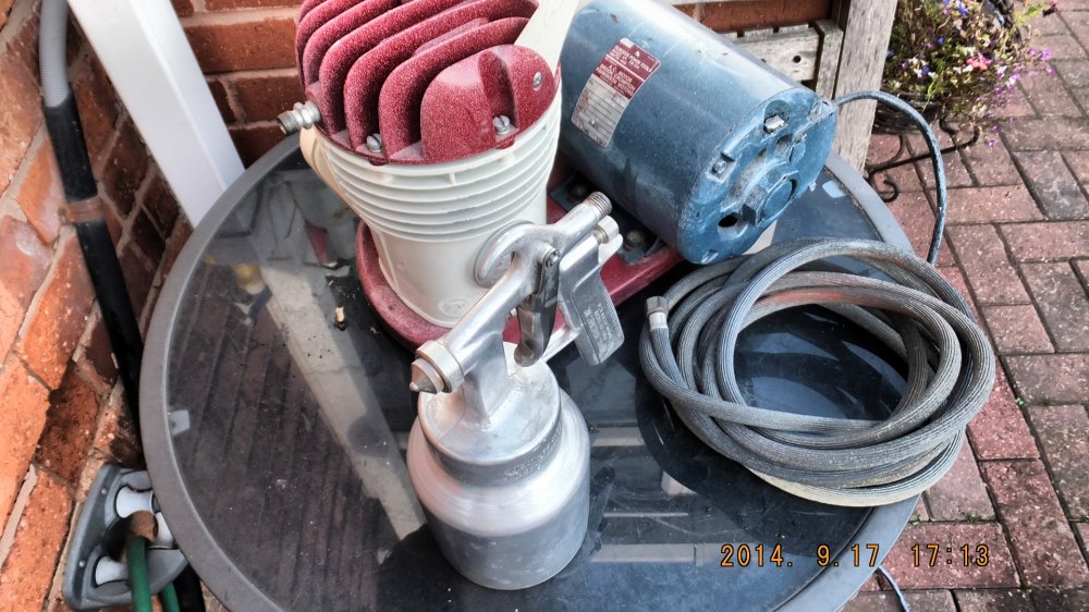

To bring back an old thread, I have recently brought one of these just the compressor unit and not realised that it requires a specific spray gun to work correctly. So i have done some looking around and found this:
My plan is that this will be able to vent of the air pressure built up by the compressor while sat on idle (spray gun trigger not pulled on a non bleeder spray gun). Failing this i saw some material on Apollo turbine sprayers and some of there early models used bleeder type spray guns but now they use non bleeder type. To overcome this on the older units so they can use the newer type guns they simply supply a fitting that screws onto the machine before the air hose with a 3/16th hole in it:
Looking at the previously posted instructions it says it used a 1/4 ID air hose, is this bore of hose still available and was such a small bore used to help with overall pressure?
Looing again at the instructions it says the working pressure is 30psi, is that the maximum pressure the unit can produce or the maximum it will produce while in use i.e spraying or using a blow gun? I see that the original gun was rated at 50psi max.
I only brought it using money I gained selling other junk on ebay so if it does not do what i want it to i will move it on.
So the little brass fitting in the cylinder head is a relief valve which blows at 50psi and relieves pressure back to roughly 30psi. It is quite a harsh release so I'm still going to get the valve I mentioned. I've now picked up my mini gun and gun gauge so I can test working pressure better. Hope this info helps anyone who has one of these! I think the biggest issue will be CFM but I will see.
Overall I'm happy with the unit I got it runs quiet apart from rattly belt cover and is in good nick. Would look good in the garage as a piece of retro tooling if nothing else!
That's a brilliant bit bit of information kind of confirms a few things. If i could get 40psi from my unit I should be able to run my mini gun. Trouble is I only seem to be getting 30psi. I don't really want to take the valve plate that is in the head out as I don't want to damage the gasket. I will have another play with it when I get a minute. Just busy fixing my car as it went through a flood and has suffered for it.
