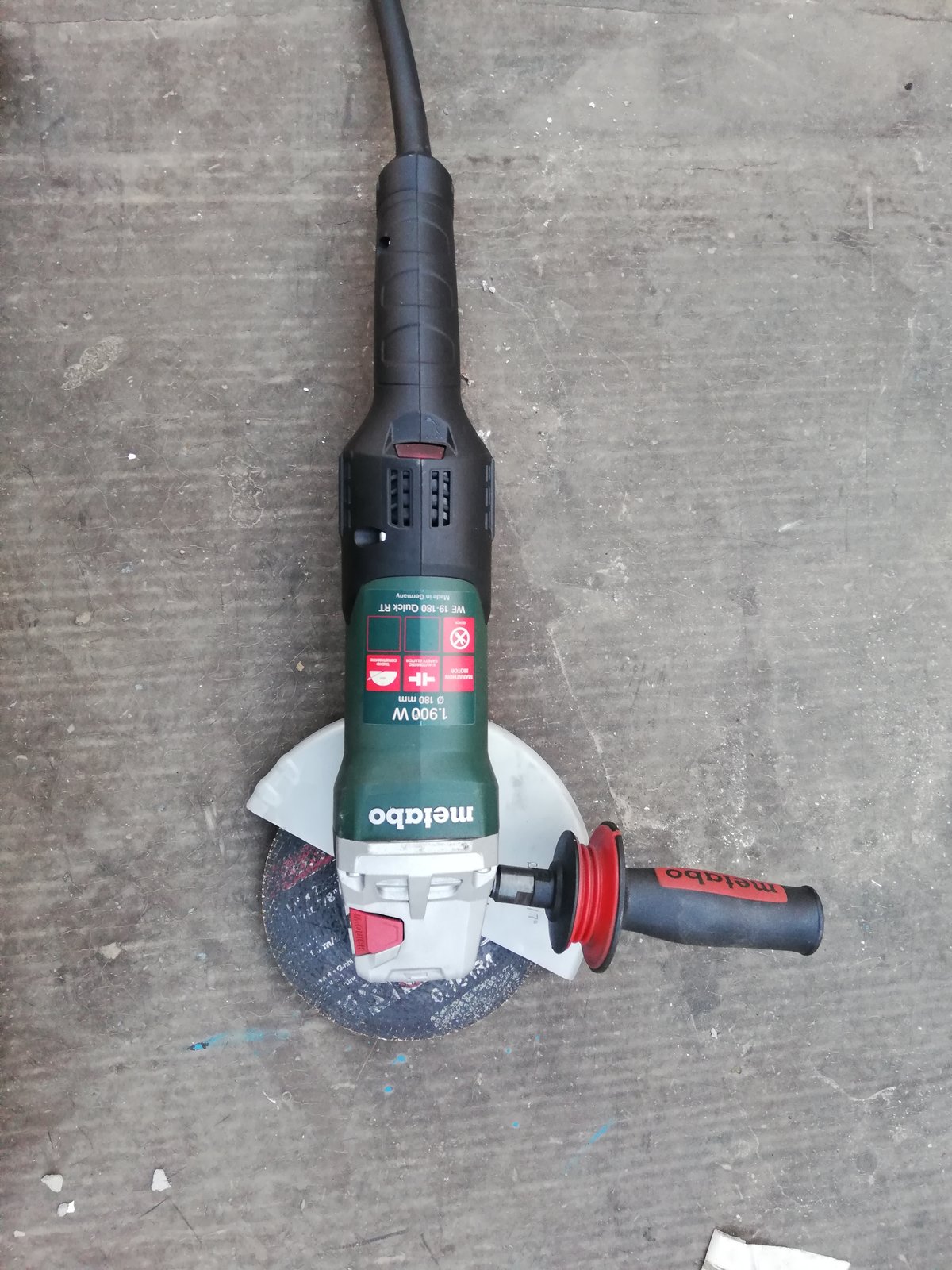

It took long enough to cut a bit with the big grinder
You should definitely be making yourself a Burke Bar... Trust me, you'd love it.
Tell me what you did to break out the grinder maybe is easy to repairI'd happily swap you a chunk of 10mm leaf spring (see above) or some car coil spring for some of that unfeasibly thick leaf spring.
Incidentally, I thought I'd break out the 9 inch grinder to make the cut but tbh, the 4.5 inch with a thin cutting disk did a great job. never mind the broken one, that was my stupid fault.

I know what you mean ,I have a Bosch GWS 18-230 if I can use something different ... I use something different.To "break out" in this case means to retrieve it from storage. It is a perfectly good example of a 9 inch grinder though given the choice, I would always prefer to use something else (anything else!). Those big grinders are an accident looking for somewhere to happen.
I always use any kind of grinder with both hands and safety guard installedI use 9" grinders every day of my life as well as 4.5" ones and I would say the 4.5" ones are more likely to cause injuries than the 9" ones. Yes the bigger ones have more potential to do greater damage to the body but due to their size they require two handed operation and personally I think they are safer.
