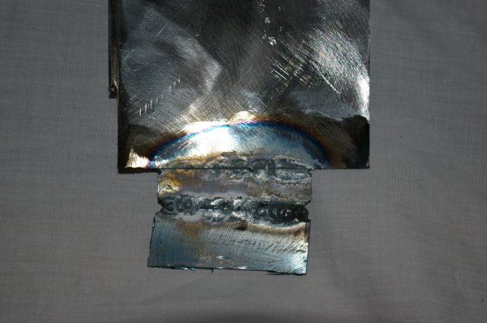

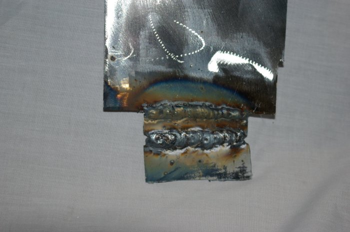

After a too short weekend I was back to the grind today, I did some welds and I attach two photo's A front and back shot of two welds top one at Min & 3 bottom at Max & 3. Top had little or no penetration bottom one better, I was practicing other cut-outs and welds but need more practice at preperation as I made a complete mess of them.

I used a flap disc to clean of the Galvanising off my steel plate but although I made a good job of it I still got a white deposit on the underside of the weld, what kind of mask would help? I didn't breath any of the fumes. I hope!
One thing I did learn! I always welded away from me with Arc, I tried doing it towards me and I keep on line a lot easier.
