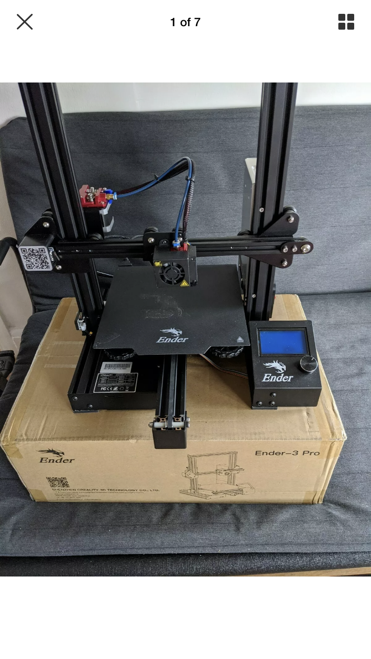

I’d there a difference between the ended 3 and 5Beware the super budget ones, they will print fairly well but they have a steep learning curve and the quality of prints will depend on a lot of tweaking and possibly upgrades.
The Creality Ender 3 is a pretty good bet for your budget. Not much assembly and should work right out the box so to speak. Has a big following so getting help is pretty easy.
So do you not think a Endor 5 is worth it for a beginner also is it a problem being the t frame over the cage is twisting and rigidity a problemEnder 5, Bigger build area(220x220x250 vs 220x220x300mm), twin Y axis motors (Ender 3 has single), Will be more rigid as it is a cage design ( vs T frame). Possibly upgraded electronics.
Ender 3 £210 ish
Ender 5 £350 cheapest I could find in 2 minutes.
