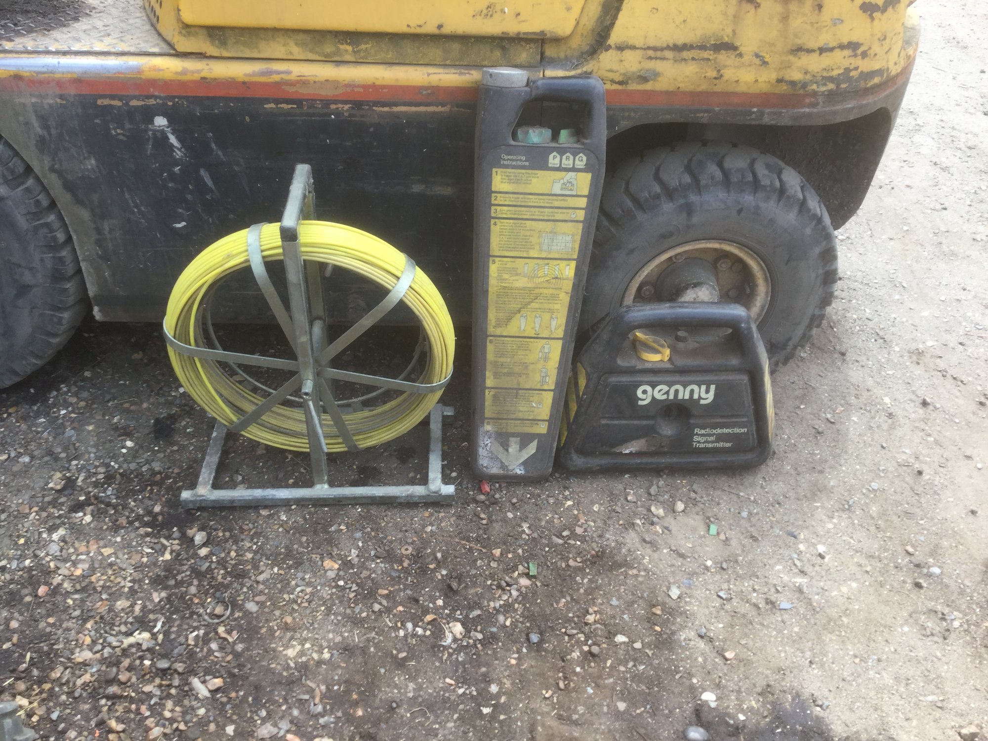

hope you have a fat wallet there not cheap. just hire a cat cable and pipe tracer .not a moggy neitherWhat cable avoidance tool is best suited for me for checking for burried services before install gates and barriers
There are a few different models and options to choose from
aliensIf you're gonna use a CAT you should get some training because the results can be very difficult to read sometimes. Recently I had a 'trained' guy scan some concrete that needed cutting and breaking out. He spent ages scanning and kept coming up with all sorts including a 'radio' signal in a place that it should not be possible. Finally I got exasperated and said 'point it at the sky'. He did - and still picked up the radio signal .
They sound abit over complicated
I've been watching them on eBay and some of the CAT 4 are going for 50-80 as apose to 450 new
What's the Genny for and why do.i need this
Also why do I need the cable reel?
Ok
Do people get away without using these detectors?

Cat and gennie is when disk cutters jack hammers or machines are going to get involved even after using a cat and gennie correct practice is to hand dig trial holes to confirm
