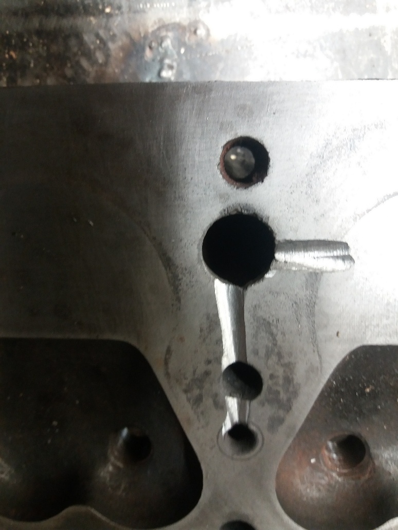

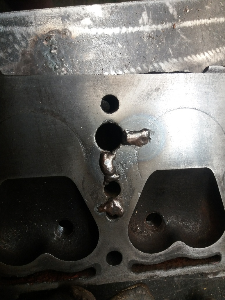

I did not want to weld this but he insisted
It should clean up well
There was one going in to the cylinderIf that's all the same water jacket then why weld
Yea just spotted itThere was one going in to the cylinder
Top right on last image
Possibly 25 thou may be 40 it runs very low CR so should not be a problemHow much do you think you will have to face head to reduce corrosion around gasket seal on cylinders
Austin I believeOld side valve Ford ?

Metal stitching is still used on cast repairs.It’s brilliant what you metal magicians can do.
The crack is drilled and tapped a stud screwed in then this is partially drilled and tapped
This is continued until the crack has been replaced with new metal

Yes AC 80 Hertz 10 % balance at 60 ampsDid you do that on AC?
