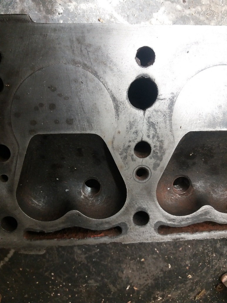

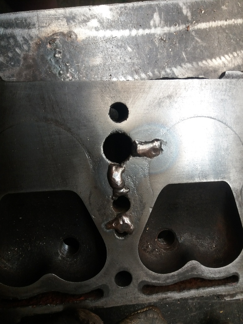

I welded a casting last week with the same settingsDoubleboost, thanks for the settings that you used, very interesting.
Wondering if this will be a night cap subject?

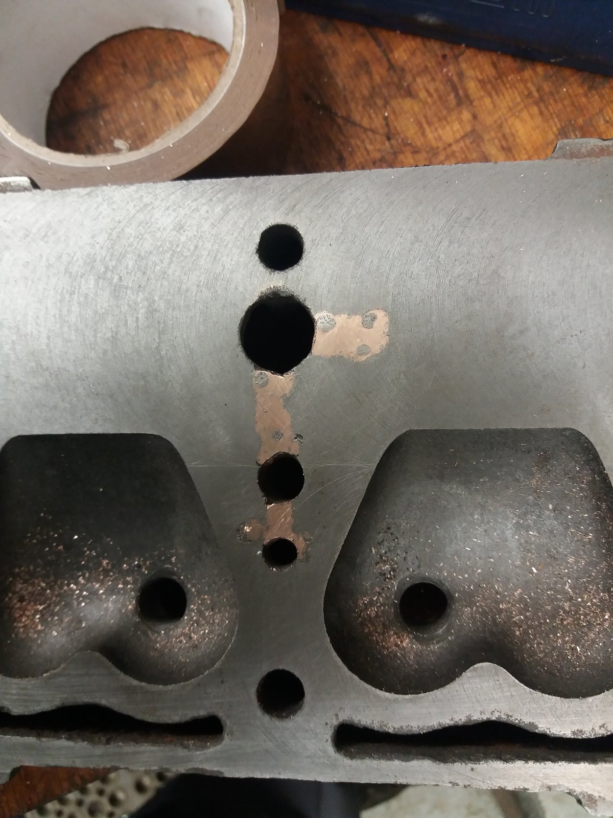

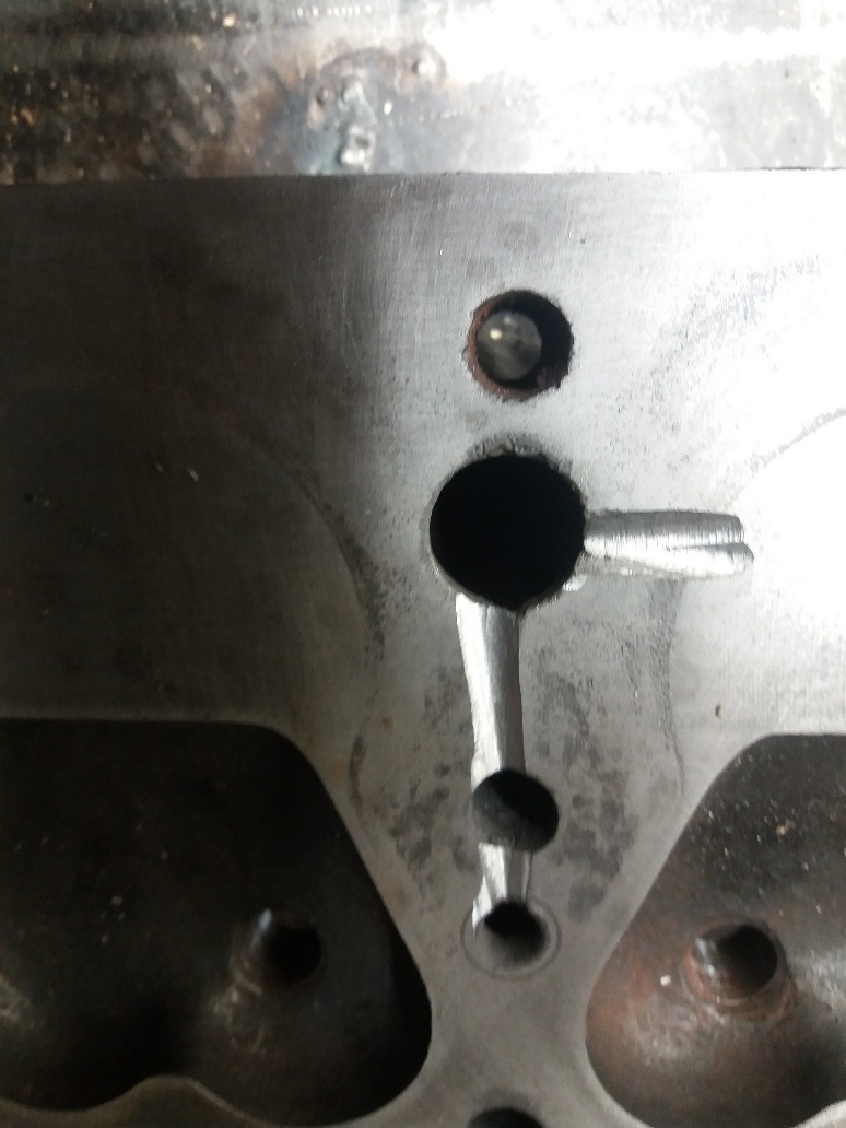

Got the head back from grinding todayI did not want to weld this but he insisted
It should clean up well
View attachment 150274 View attachment 150275 View attachment 150276
Just enough to make the face flat this one was only 30 thouHow do you/they decide by much to skim it, and keep the compression ratio sensible?
A mate of mine works for a company that makes press toolingWhere did you get it skimmed.
That's answered my questionIt was just to big for me to do at home
